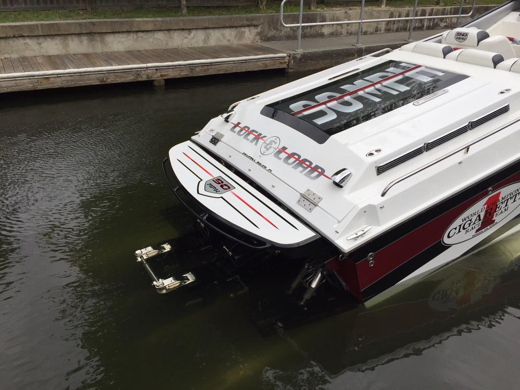

Well we made it, it runs like a Rolex. We were not out long.

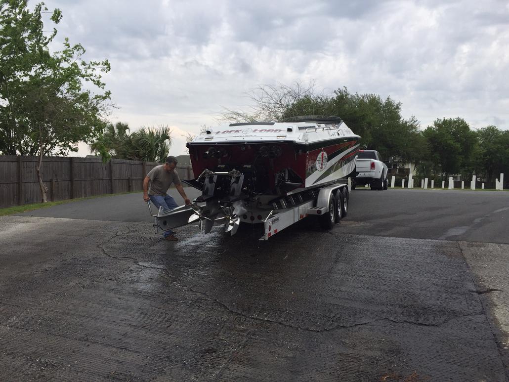

This is why. We made it back by 10 minutes, washed in the rain, now another 12 hours of rain

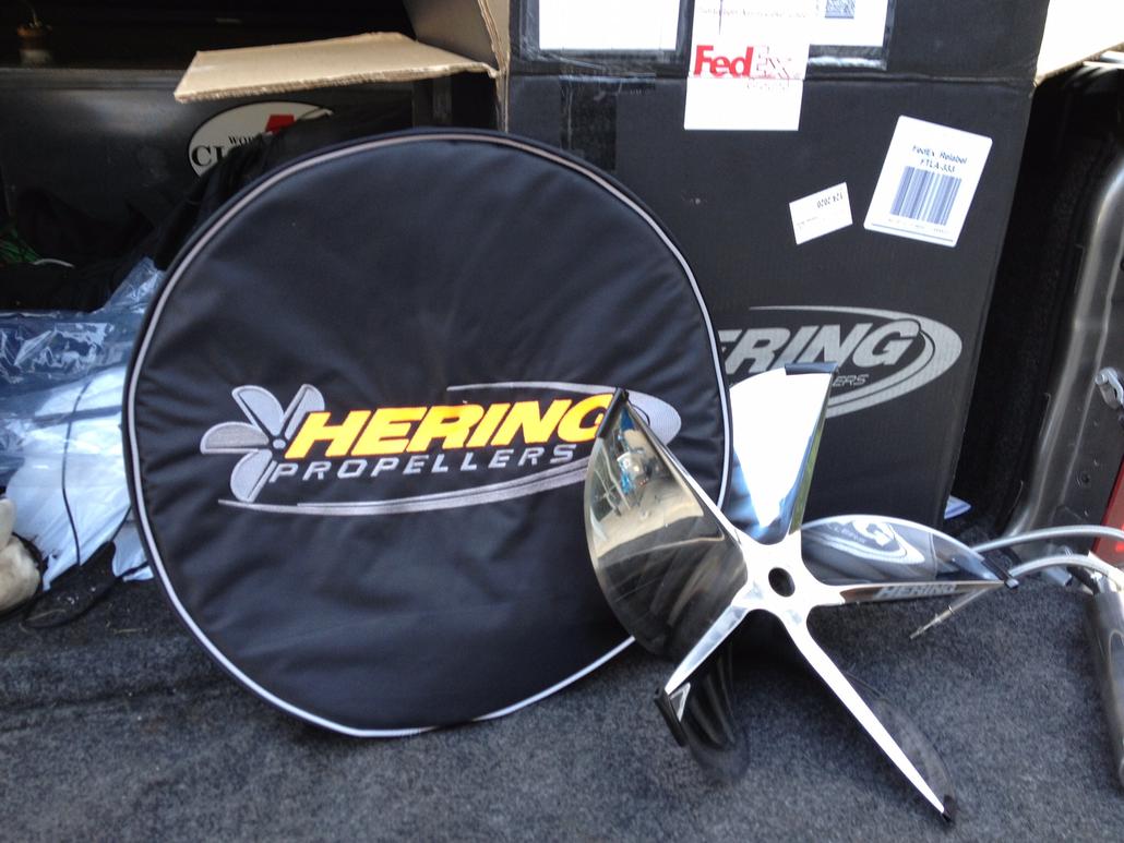

Prop work next, needs more diameter

Today was the day I've been dreaming about since December 6th when I began removing parts to start this project.
I took the afternoon off to do a couple of last minute items to get ready to finally water test the SSM VI drives. As I finished my tasks it was one eye on the tide chart and one on the weather radar. I hoped to get enough tide to run in the Crystal River before the storm line arrived.
We just made it back to ZP's, smiling ear to ear over our first test run, when the bottom dropped out. Washed in the rain as you can see in the pics..
It will need some new wheels to take full advantage of the Sixes, but at this point, NO WORRIES!!
