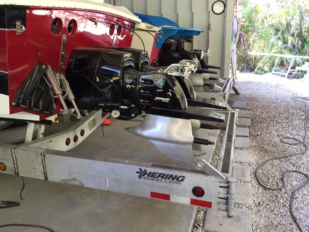

From this to this....
Attached Thumbnails One of the five becomes a Six-cigcolumbusday-002.jpg   One of the five becomes a Six-image.jpg

I run 17.75 x 32 x 15 rake, Mercury Racing 5 blade on mine.
