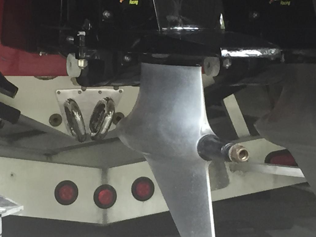

Pickups complete, drives back on, plumbing done

Looks great ZP . I have a concern on mine and I would think given those monster pickups you have the same situation . How are you managing water pressure . Does the system have a bypass of some sort you can manipulate or is it just done by changing the height of the adjustable pickup. My pickups are fixed and I am not a fan of the grind to tune method .
RG.
Rick G is offline
Old 08-03-2015 | 12:38 PM
  #195
Zero Patience's Avatar
Posts: 1,596
Likes: 12
From: Crystal River Fl,USA
On my boat it was grind and tune, on this one the pickups are adjustable up and down, so we will control it that way. The engine comes back from Chief Wednesday, so we will install it this weekend, it needed a new oil pan, the PS cooler dripped salt water on it and made it ugly.

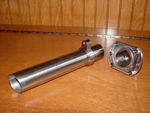

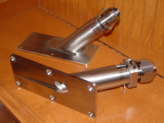

Originally Posted by Zero Patience
Then the slots were cut, and the pickup trimmed, cut, modified, to create the smallest amount of drag. A little more test fittings, and then gel coat the slots and polish.
Awesome work as always, Here are the pick-ups I built for my boat.
Same concept with keeping pick-ups above running surface, and allowing
water to flow up and it. Had 90 hours in building them....
Also notice the adjustment arm on them, I can adjust the internal pipe up
or down from inside the boat until I have desired water pressure.. then lock in place.
Jon
Attached Thumbnails One of the five becomes a Six-292.jpg   One of the five becomes a Six-296.jpg
Jon
Very nice, great craftsmanship.
