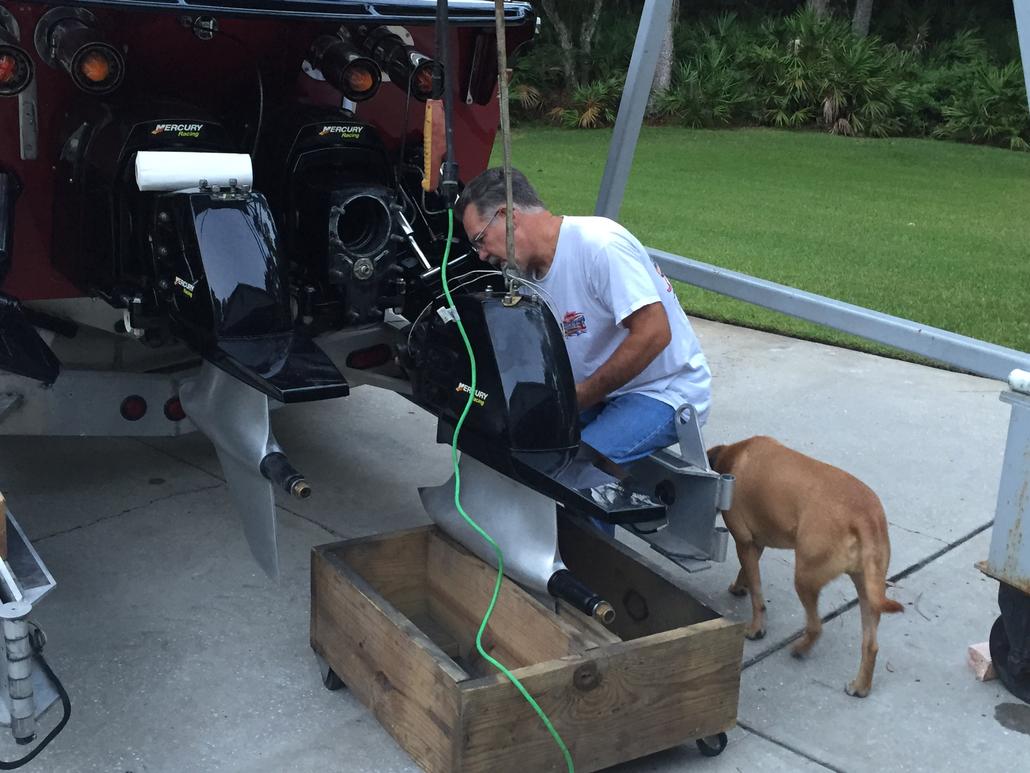

Testing again Sunday, had a little setback. Lost a skeg, a big piece of skeg! Just got the drive back from Colabellas. It has a new out of the box lower. Now we have 4 sets of 5 blades sitting here waiting. I think we will get it this time.

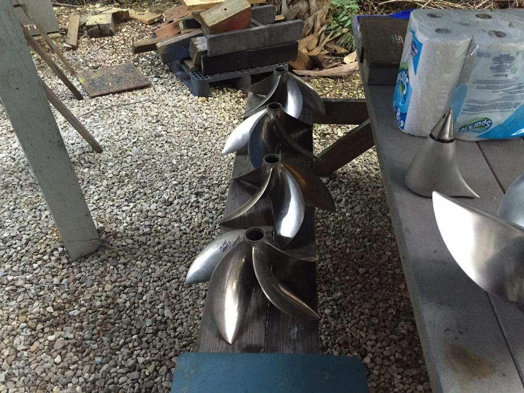

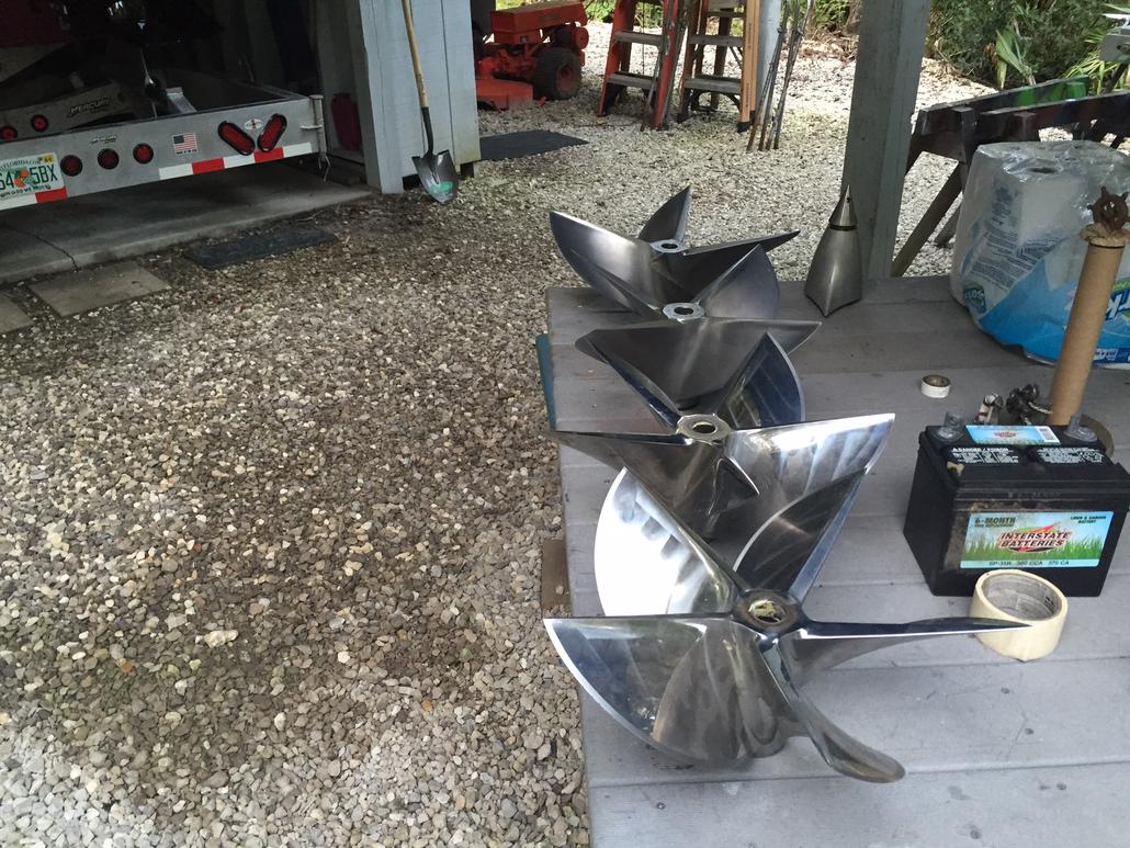

Here is the lower, and all the test props, big thanks to all that let us borrow.

We now have: 5 blades
17.5 X 29
18 x 30
17x 31
17.75x 32
17.5 x34
4 blade: 17.5 X 33
One of these should be close. We went back to inward rotation.

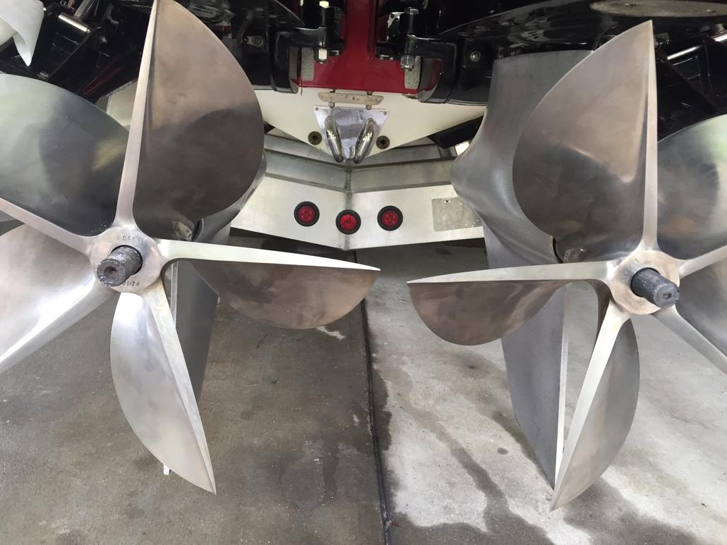

That's enough room, isn't it?
