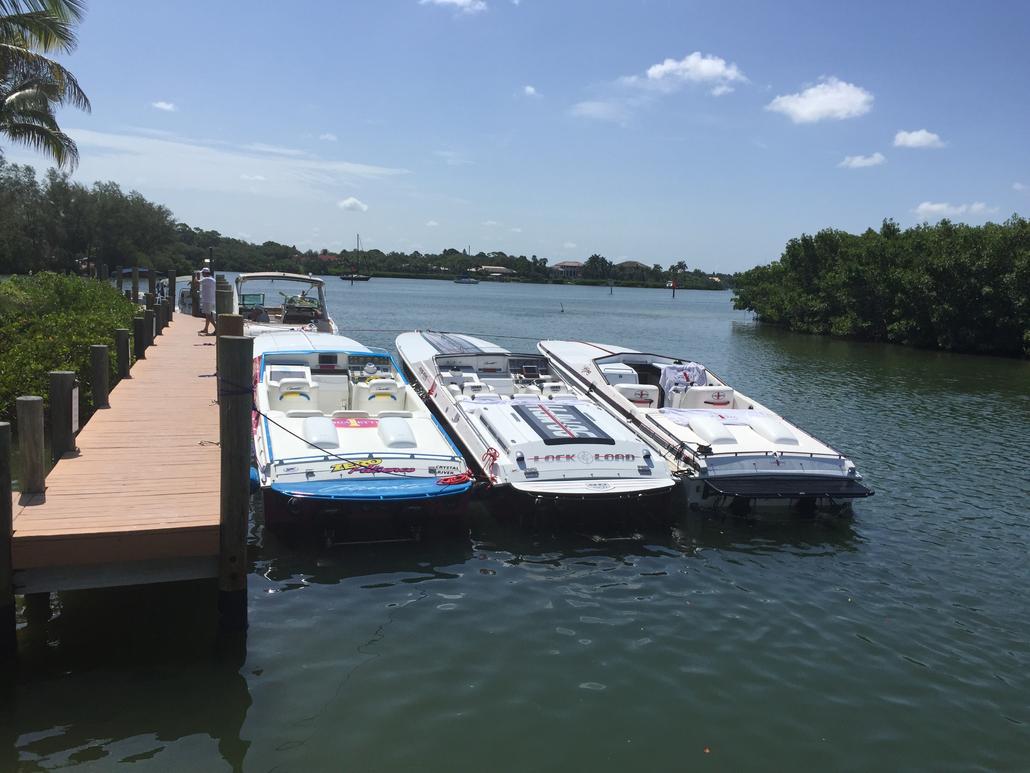

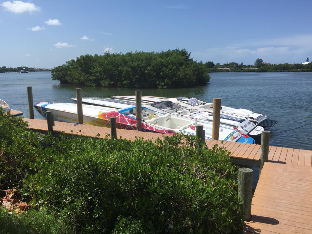

I will get it for you today, when we wash them. I would stay with side by side, just my opinion, but the staggered is a pain. But it does have the look cool factor. Sarasota Races this weekend.
