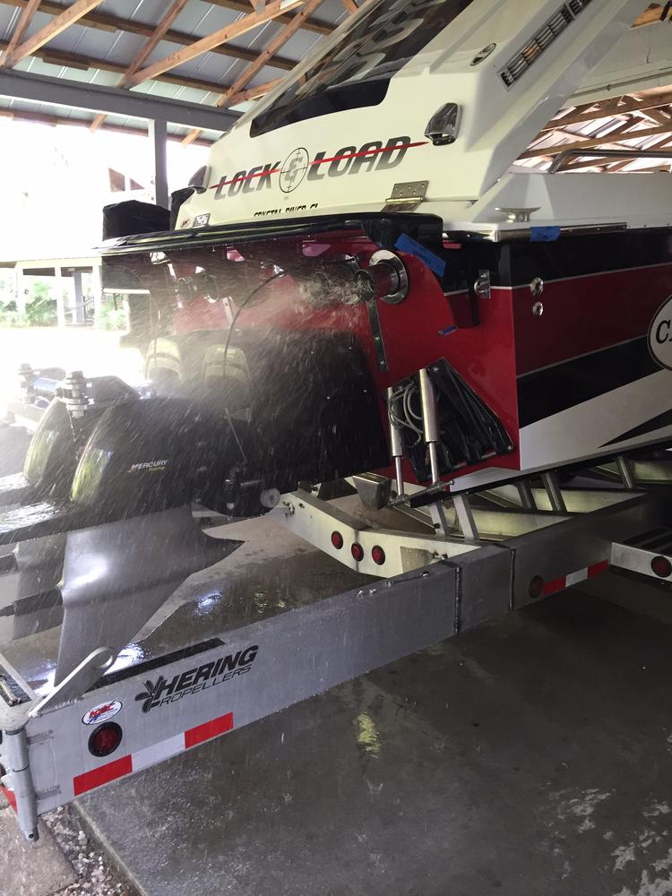

So, all in all it was a great Saturday. After swim platform and hatch there were several hours of putting other stuff back together, and the satisfaction of hearing it running again by day's end.

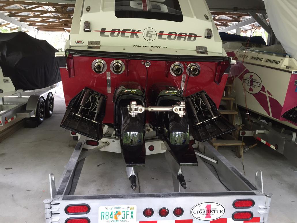

There are still several things to put it all back together and boy does it need a bath. This hot of the foredeck shows all the pollen that covers everything.

The Fives were 1.5 ratio, and on boxes, the Sixes 1.61 ratio, and 12" farther back on boxes. It has been running 17 x32" Hering 5 blades.. The fives were installed canted to get the prop shafts even closer. We installed the Sixes straight up to gain a little room and allow 17.5 diameter props to clear each other. The Sixes are on 18 1/2" centers. Rub rail, deck hatches, windshield, bow rail, cabin center headliner left to install. Should be testing by Thursday. Then boat trip this weekend. We installed the slide in mufflers in the tailpipes, should be able to sneak up on the water patrol now. Maybe only hear it coming for 4 miles, instead of 5 miles.
And yes, he wanted to keep those heavy, antique, obsolete, slow, heavy, heavy, big Ass flaps��
