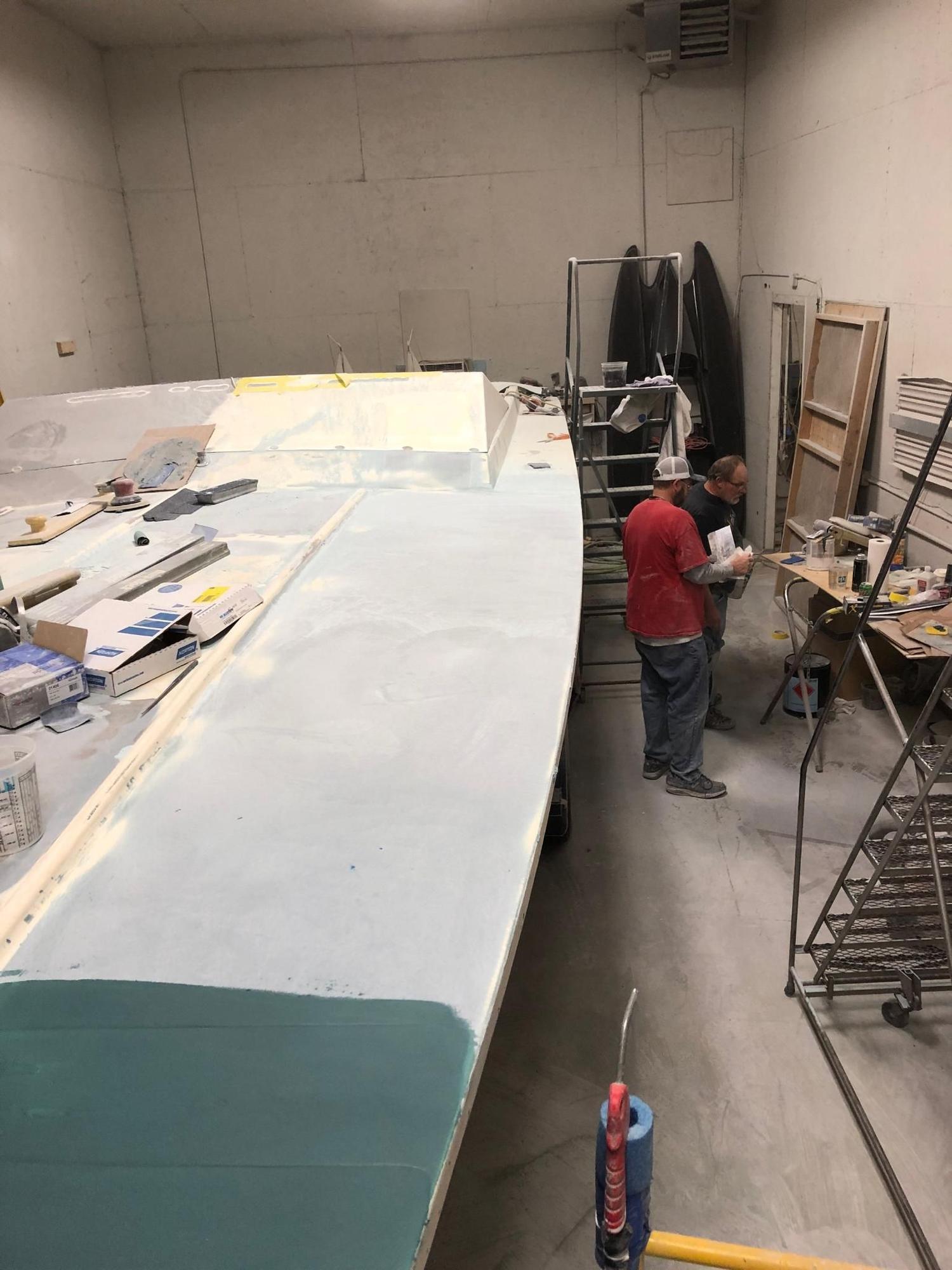

Some more pictures of the progress. More glasswork.

thanks for kind words but I can't take credit. Bruce has spent over 2 weeks in the bilge. He sent me the pictures today of starting the bodywork because he said he had to take a couple of days off from the bilge. I'll try to find the pictures of the new coosa tiles he installed to add strength to the hull, make the engine bay drain properly and to get a nice smooth finish.
