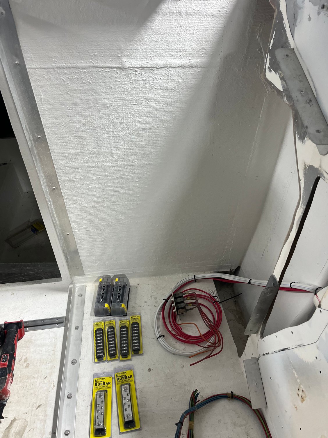

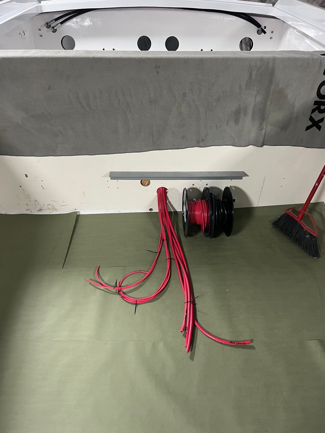

Getting ready to mount some things
Power cables ran and labeled
New steering hose lengths figured out

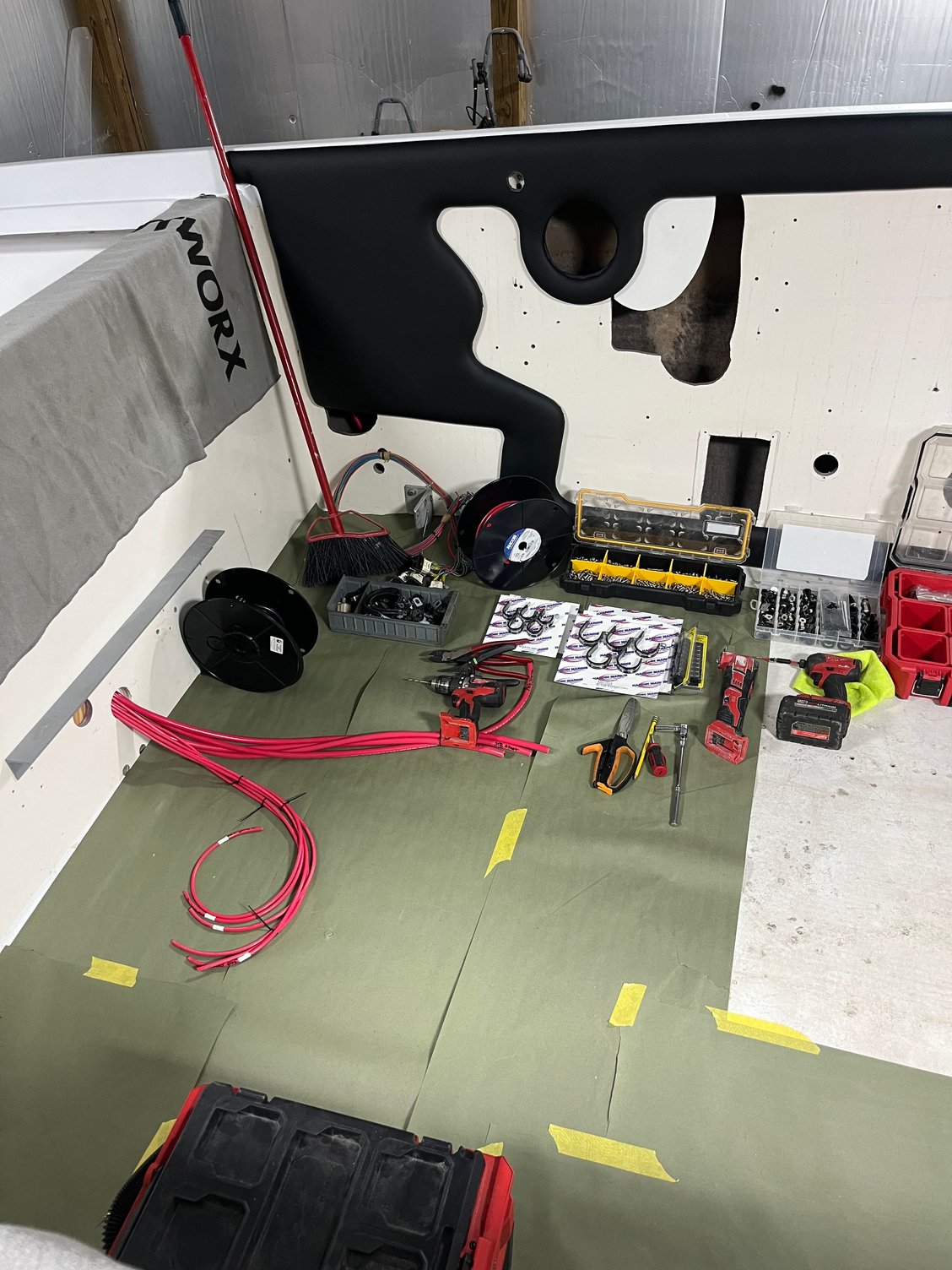

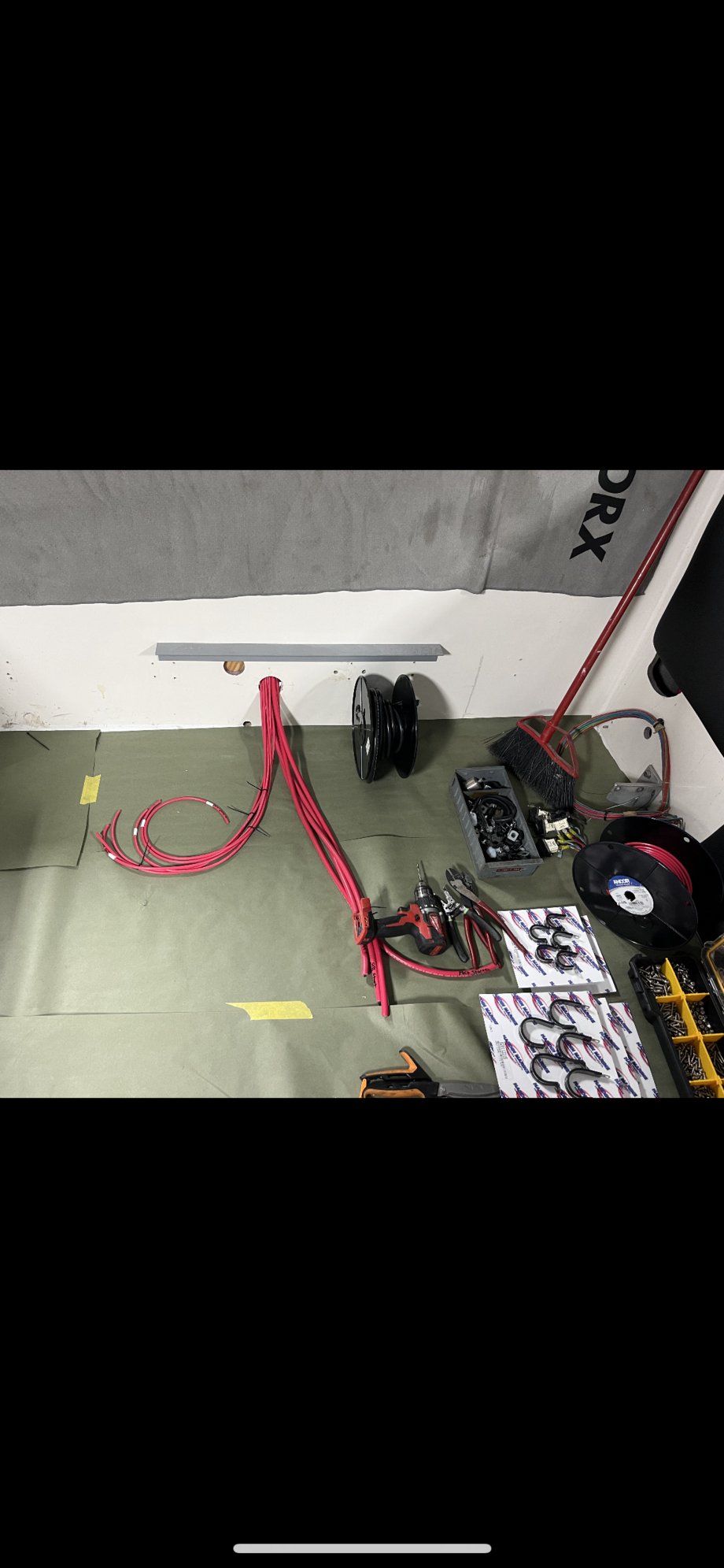

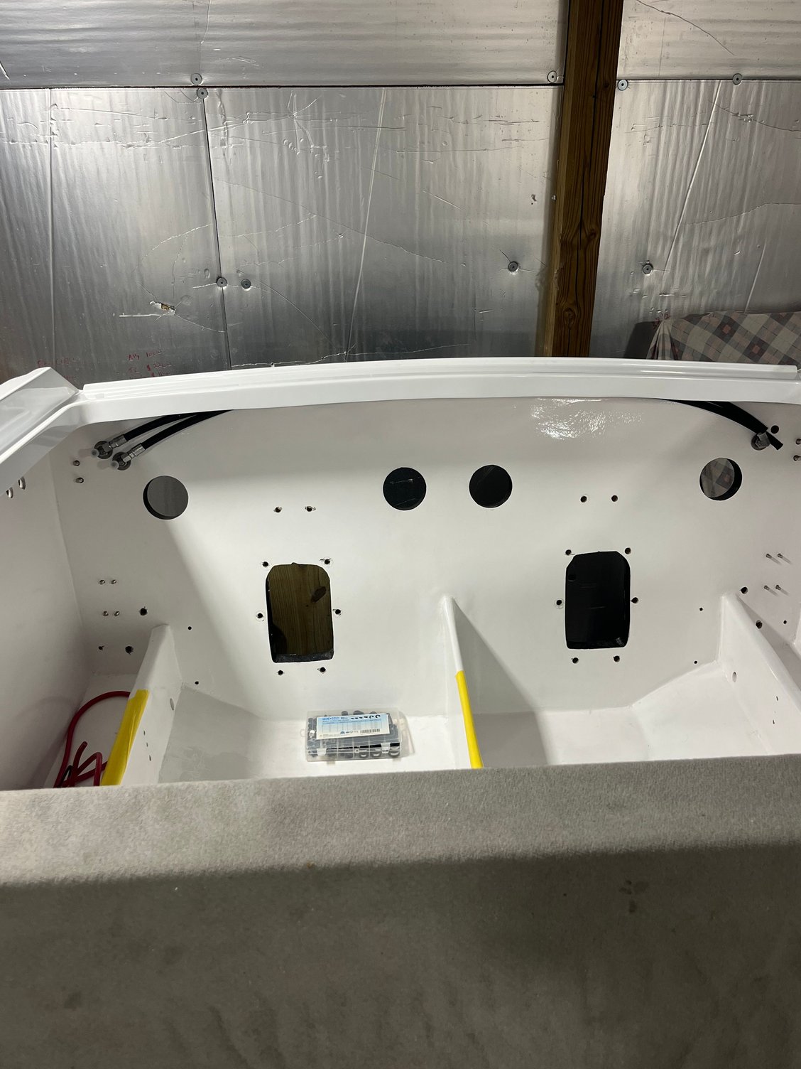

Took a ton of time to figure out how I was going to lay it all out
Bulk head behind drivers helm is we’re it will all be mounted
