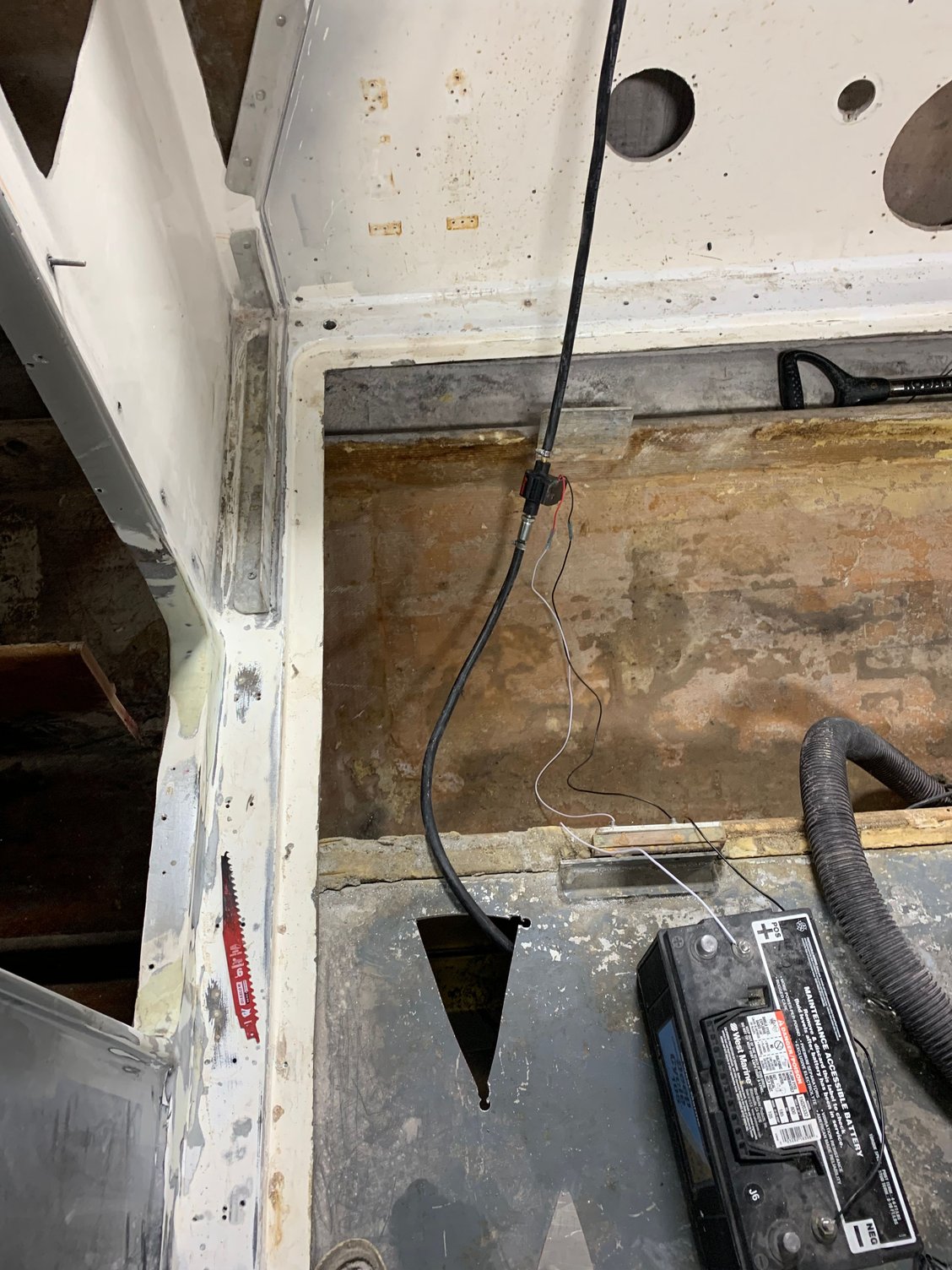

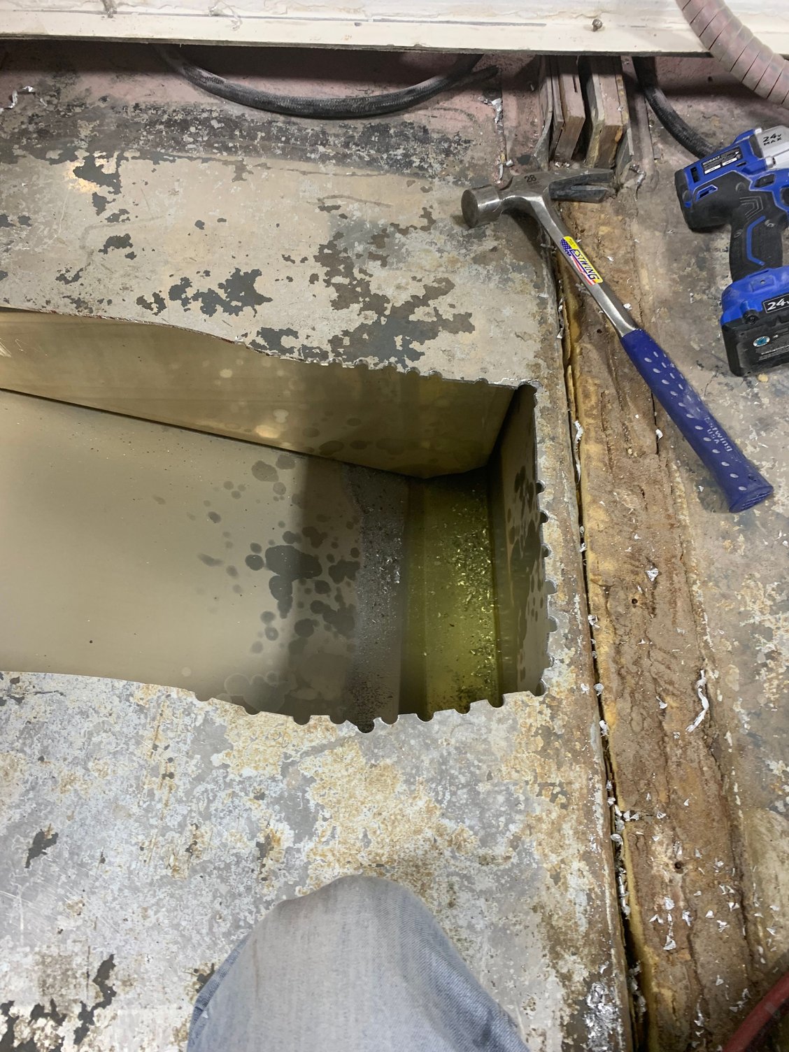

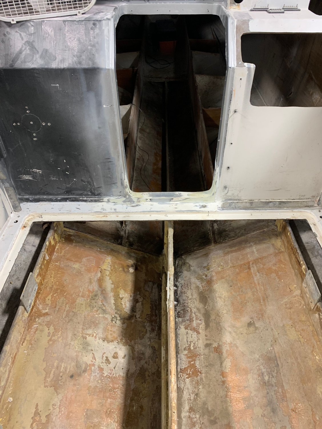

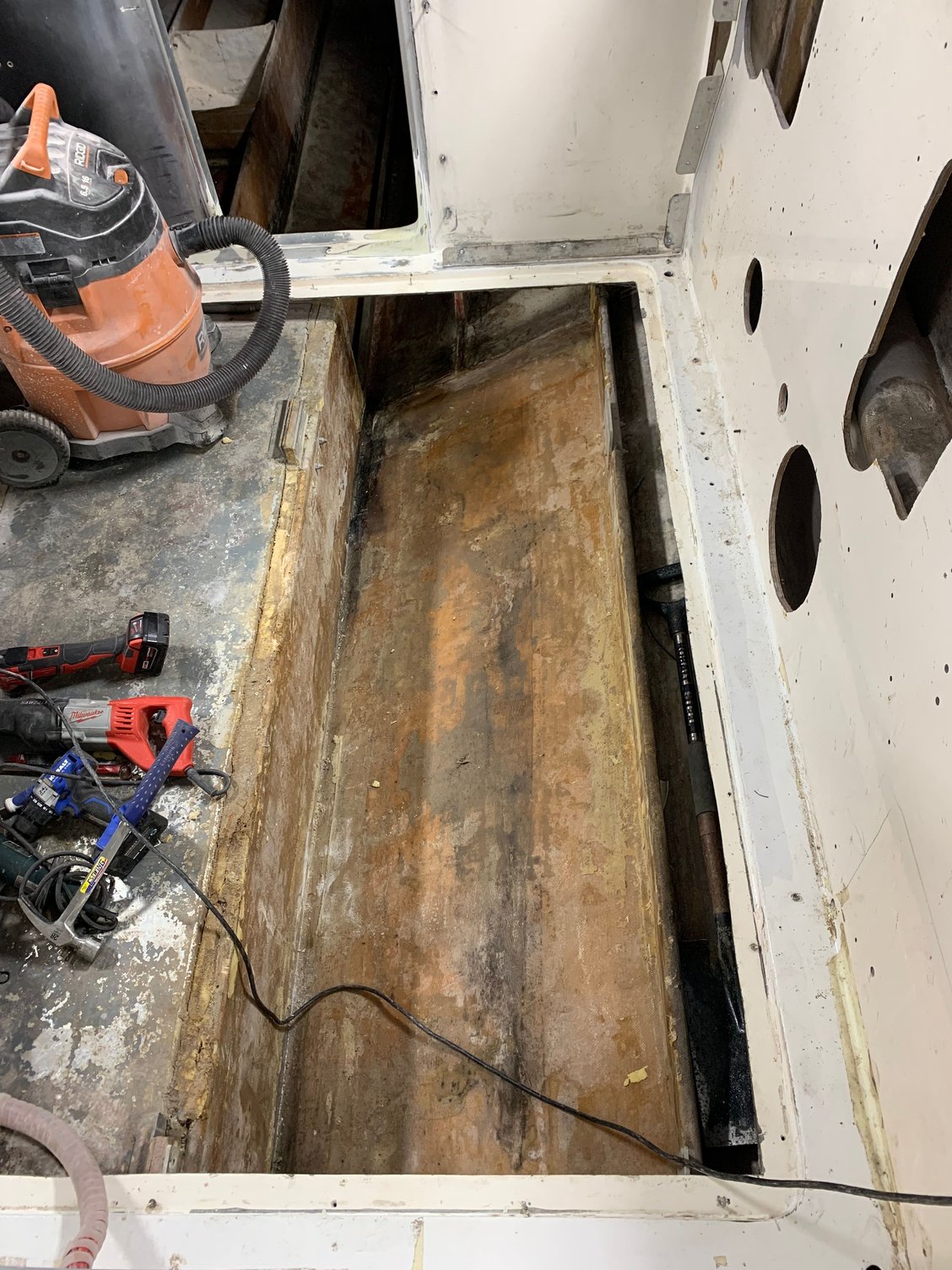

Let the fun begin ( o wait it has been going on for a year )
Cutting them in half to remove
One out
Getting rest of fuel out
Fuel tank stringer cut some glass off to see condition. Replacing them all.
Tanks had some Corrosion on the bottom of them
Finally getting there

Got off work at 7am this morning came home and started on getting tanks out. Spent all day and all evening on it came inside at 9pm lol was a ton of work had to drain them then cut the top off and finish getting all fuel out. Then took a saw all to them and the grinder with cut off wheel. Cut them into pieces and then tore them out. I can’t believe how hard they were to get out that foam had them sucked in placed really good. Hopefully this week I can continue to get it all clean and ready for new stringers.
