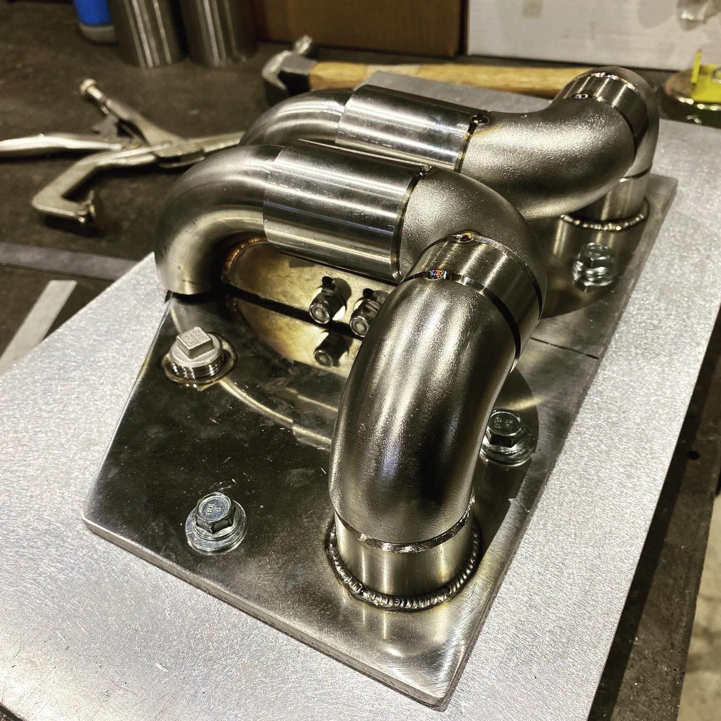

Looking for mounting advice on the water pick ups ?anyone put new ones on these older guns ?

I just finished building mine.

That’s a serious bad ass set up my friend
thanks. I should have no water pressure issues now lol. There adjustable in 1/4 in incriminates. And I have a water pressure sensor in my sea strainers to monitor pressure in them along with pressure sensors in my intercoolers and engine

Here's an old picture, you can barely see it. They are fixed mount. Provide great flow, and good for 5-15 psi depending on speed, never had an issue. I forget what size feeding the big Hardin dual stage strainers 1-1/4"? Like B18 above, it also has the drain plugs through the mounting plate. It's a nice setup, I think mine were custom made. Possibly off the shelf, forget this was about 6-7 years ago. They stick under the running surface but not much, maybe 1/4" .
B18, where yours are full dia, facing forward, mine are cut more like the bottom surface of the hull (flush). Water almost shoots "up" into them. Picture all that force pushing down from the hull, when the water leaves the back edge of the running surface, there is a lot of pressure (displacement) that is relieved and in turn pressurizes the pickup tube. This way you create less drag (but on the non step hulls I would bet any "speed gain" very minimal)

B18cls69, you feed both engines and both intercoolers with that pick up ?
Put a Tee in bilge ?
Dan,
One single pickup feeds a strainer, then from strainer to a two-stage water pump. One inlet - two outlets: one to engine, one to intercooler.
Pump below, kinda hard to see. Just (1) one 1-1/4"dia water feed to pump.
