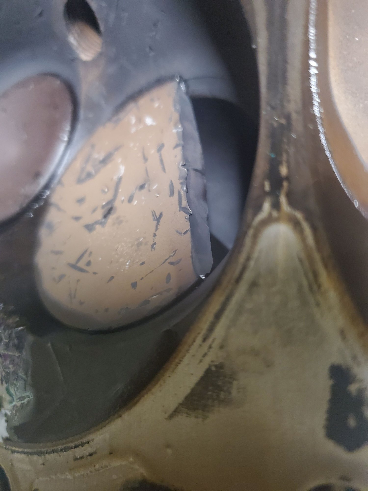

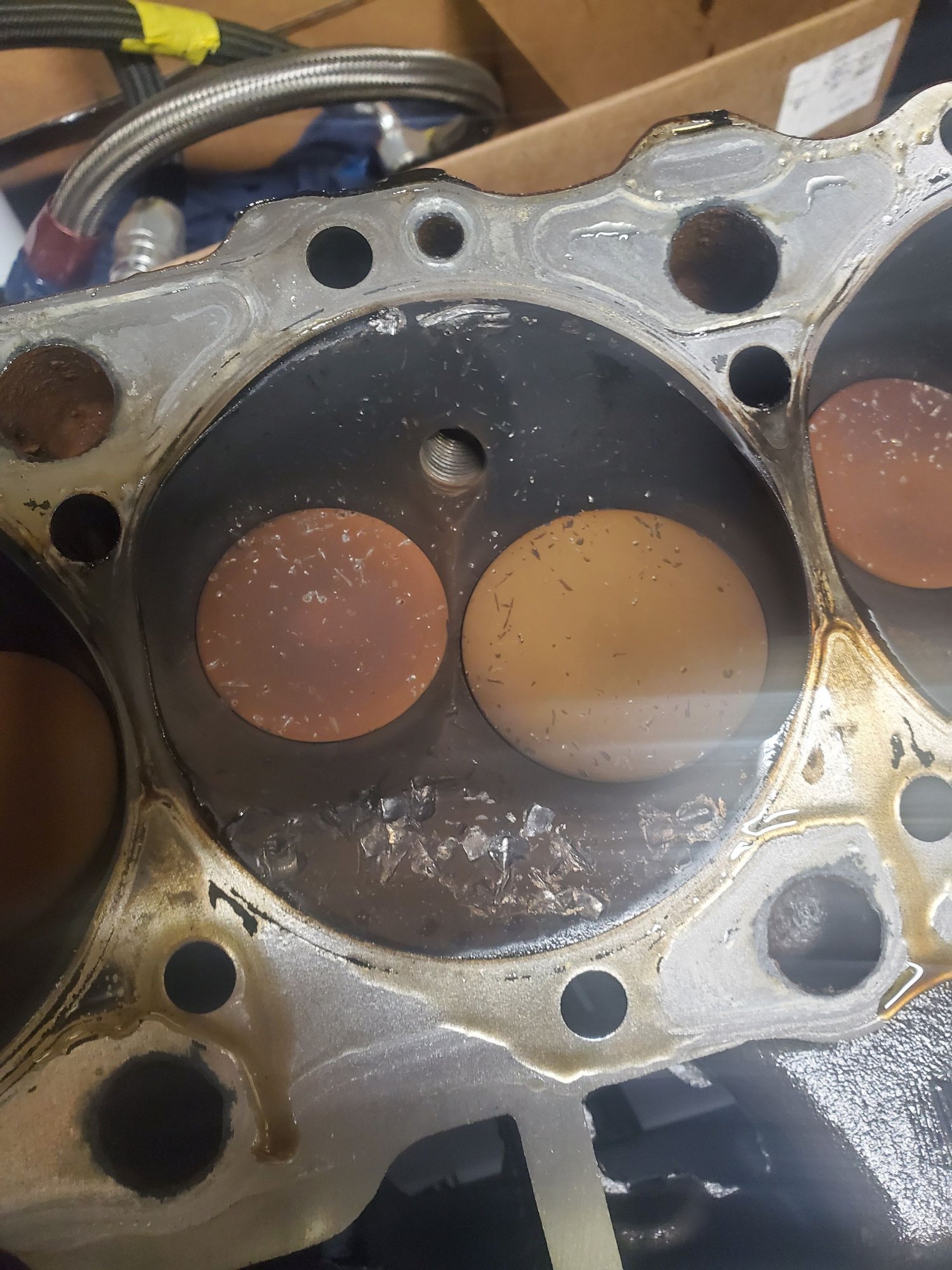

Since it was a stop for the Cig Run, did anyone fill up there ? They had 91octane.
Shortly after filling up my intake valve broke in half and decided to have a party in my engine.

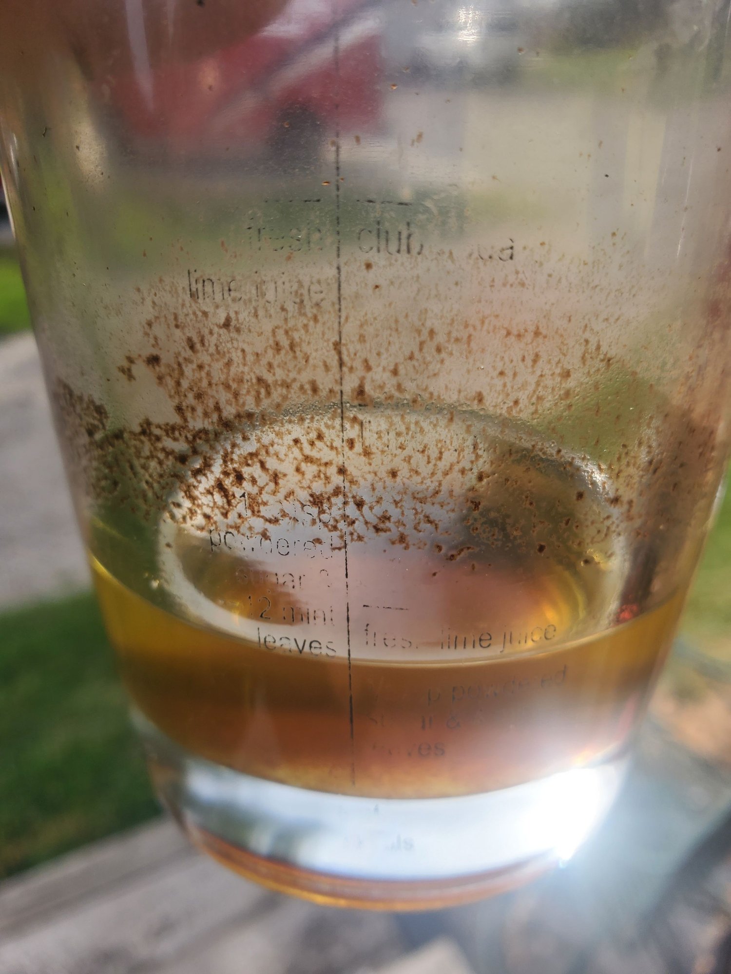

I took some gas out, put in glass left outside for a few days , there`s a dark orange residue at the bottom of the glass and the gas smells more like laquer.
I treated it with boostane but maybe not enough.
My head guy says bad gas/ super high cylinder pressure (pre ignition) broke that valve.

I am a believer you can’t fix bad gas (your description of the smell is old gas - i deal with 2-4-6+ yr old gas alot) with any pour in anything.

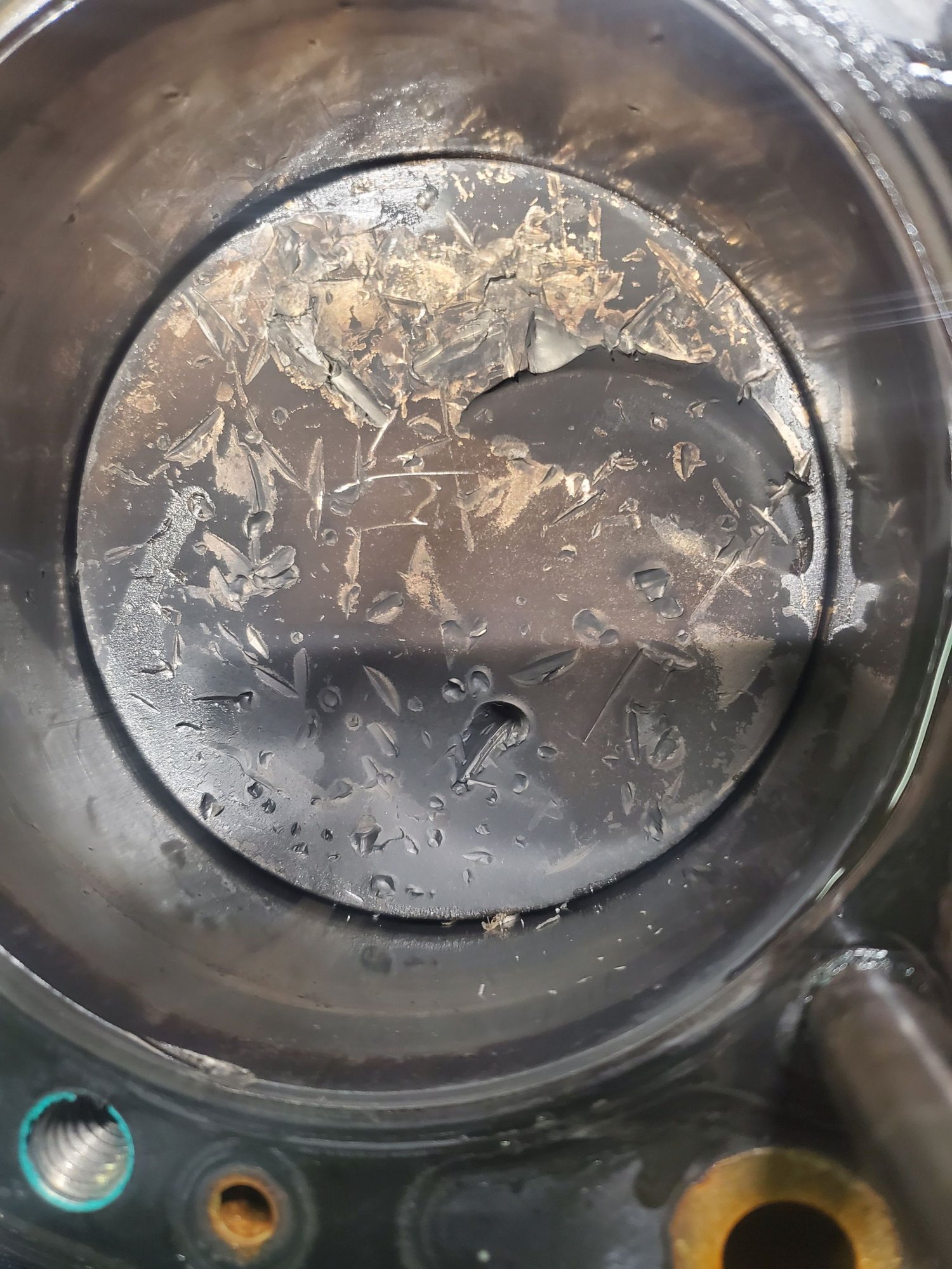

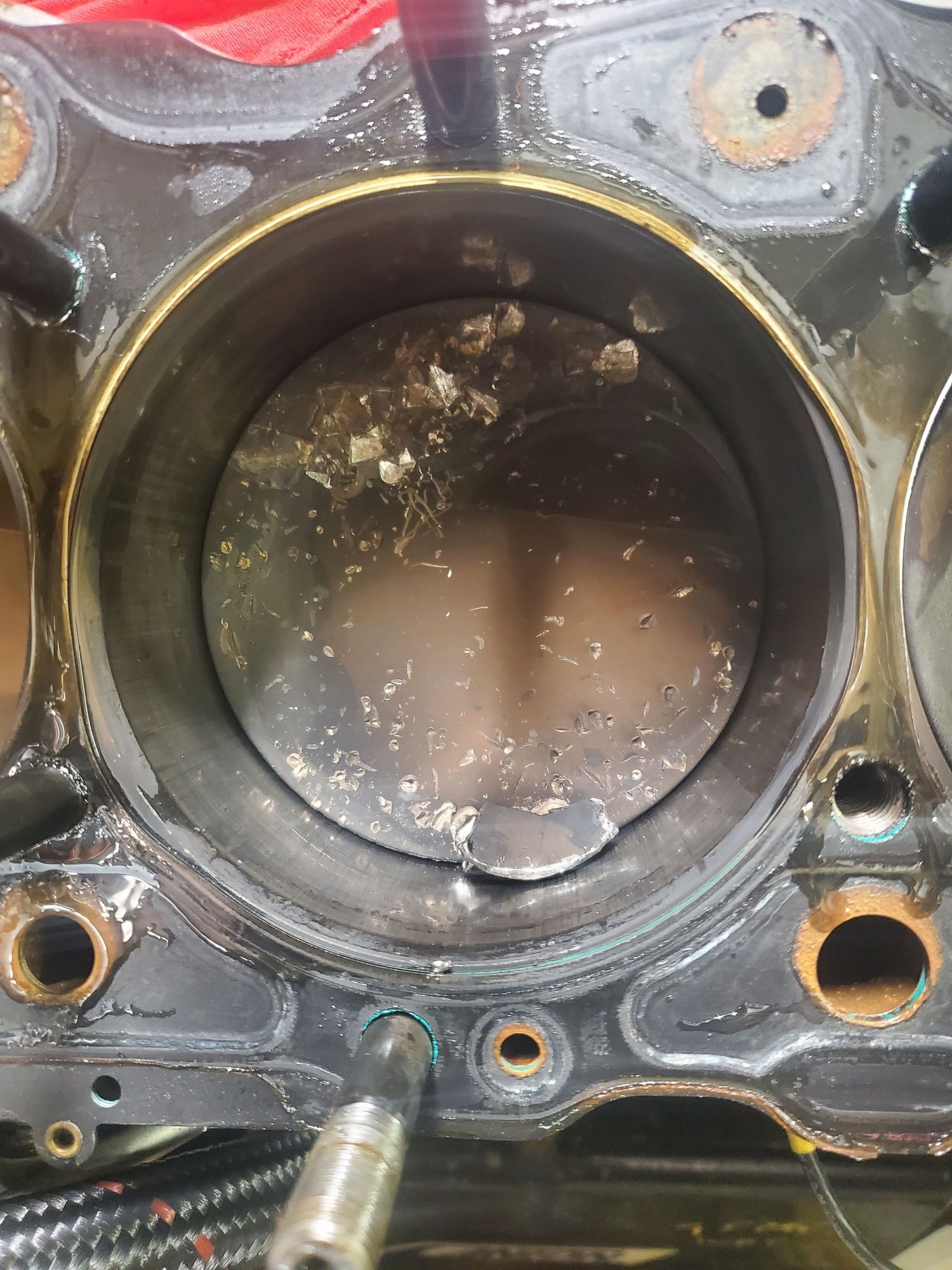

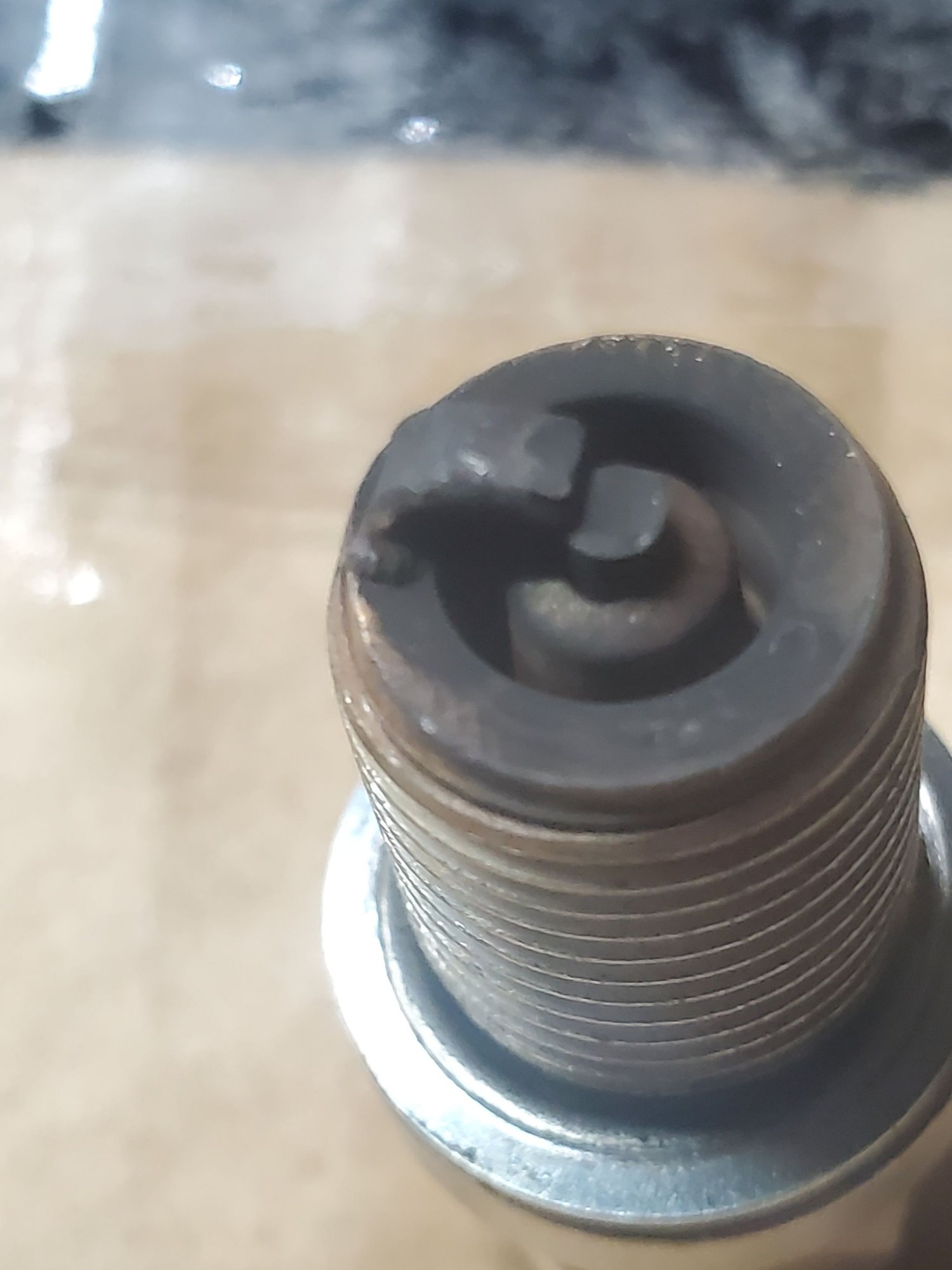

Hard to believe bad gas damaged a valve like that unless all of the pistons show knock damage also, what does the knock sensor data show? That was probably a flawed valve IMO

I agree with the above. If it detonated so bad to break a valve, there must be other damage as well.
I always worry about buying bad gas, especially at a marina. Hear horror stories about water in their fuel.
What do the tops of the pistons look like?

Gas residue after a few days of sitting
