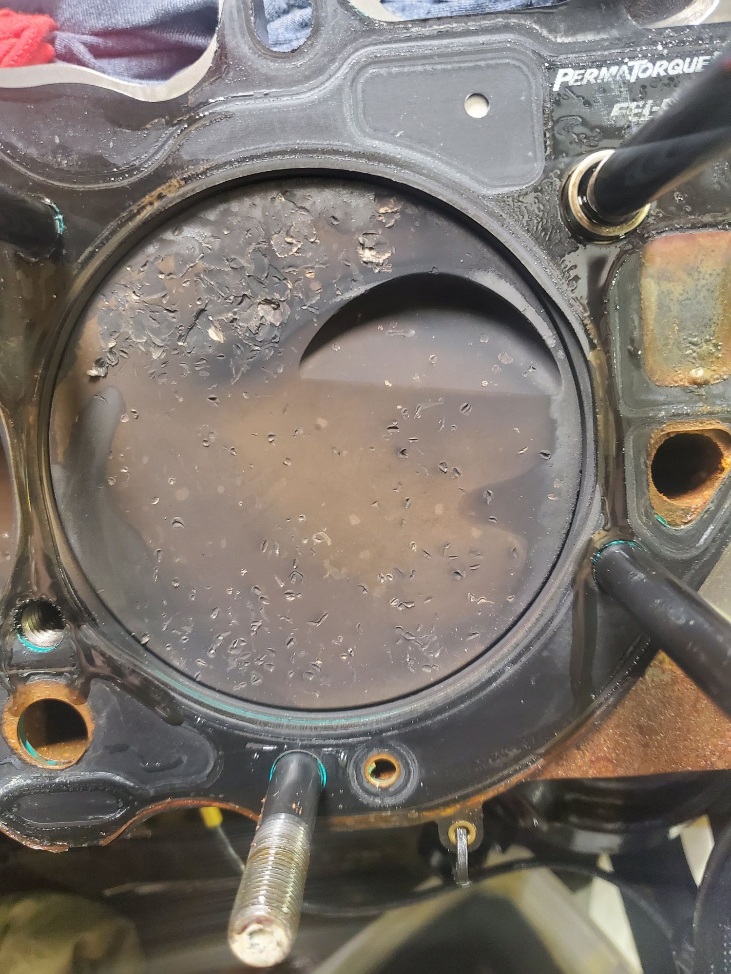

Did a piece of valve or debris get sucked in to another cylinder? Are those the only 2 pistons that got damaged?
underpsi68 is offline
Old 07-10-2021 | 01:23 PM
Joined: Jun 2009
Posts: 9,973
Likes: 6,467
From: Chicago
Wasn`t that far from performance either . Dammit.
UNDERpsi69 : ya , half the valve had a party in 3 holes .
Pretty lucky the damage wasn`t worse.
Head is already fixed and the motor is at the machine shop. Upgrading pistons and Crank while we`re in there ..
Pulling the other motor to go thru the heads so the same thing don`t happen over there .
3rd hole :

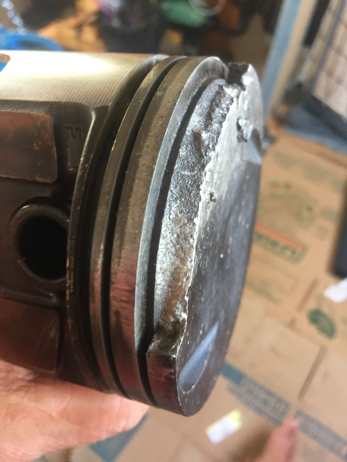

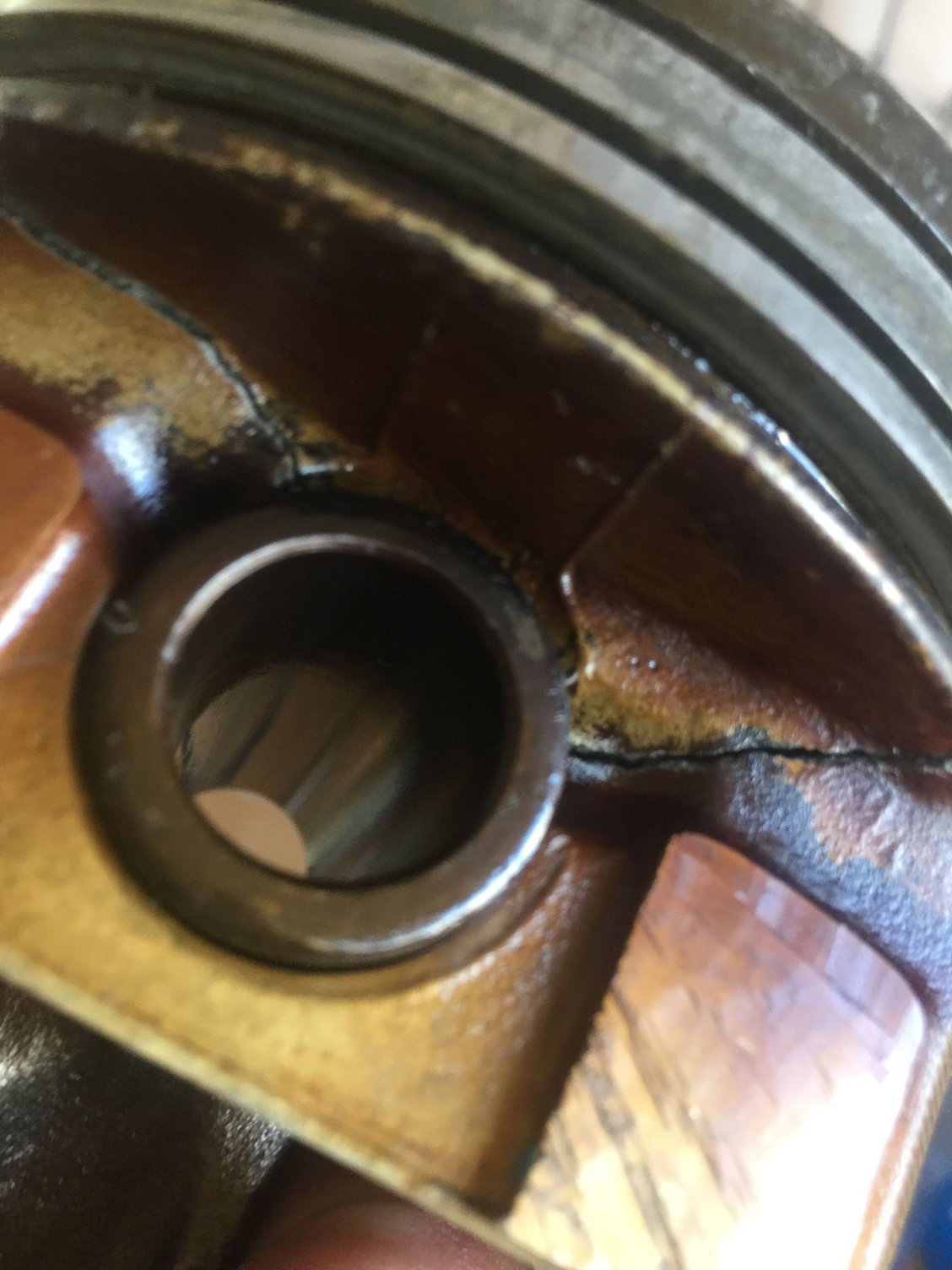

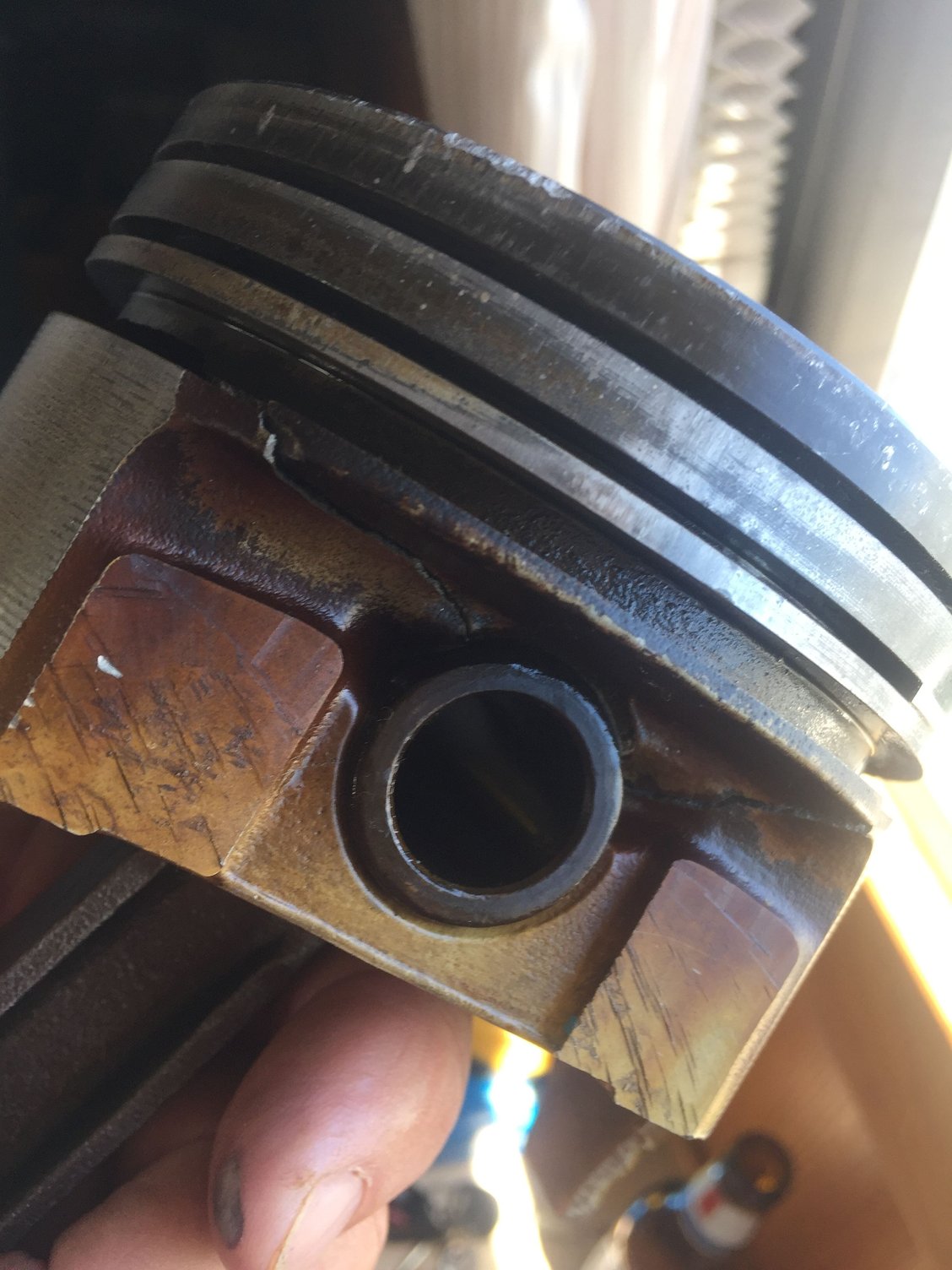

This is detonation , stock 350 hp 454s in my buddies cruiser.At first I suspected bad gas because as he hand carts down 87 with ethanol that sat in the tanks for months.
After finding 3 more pistons with the beginning of the same damage I suspect the mechanic who installed new carbs a couple years ago advanced the timing too much to get them to run out.
Unbelievably all that piston debris exited out through the valves without causing too much damage. . Still had 80 pounds compression and valve seat looks tight except valves and head look like they been sandblasted with gravel .
Piston was about 1rpm from disconnecting from the wrist pin.
