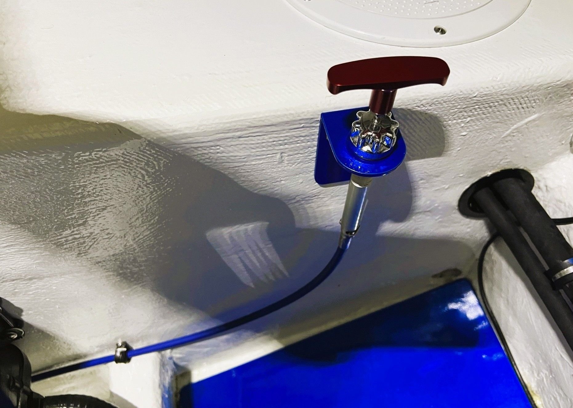

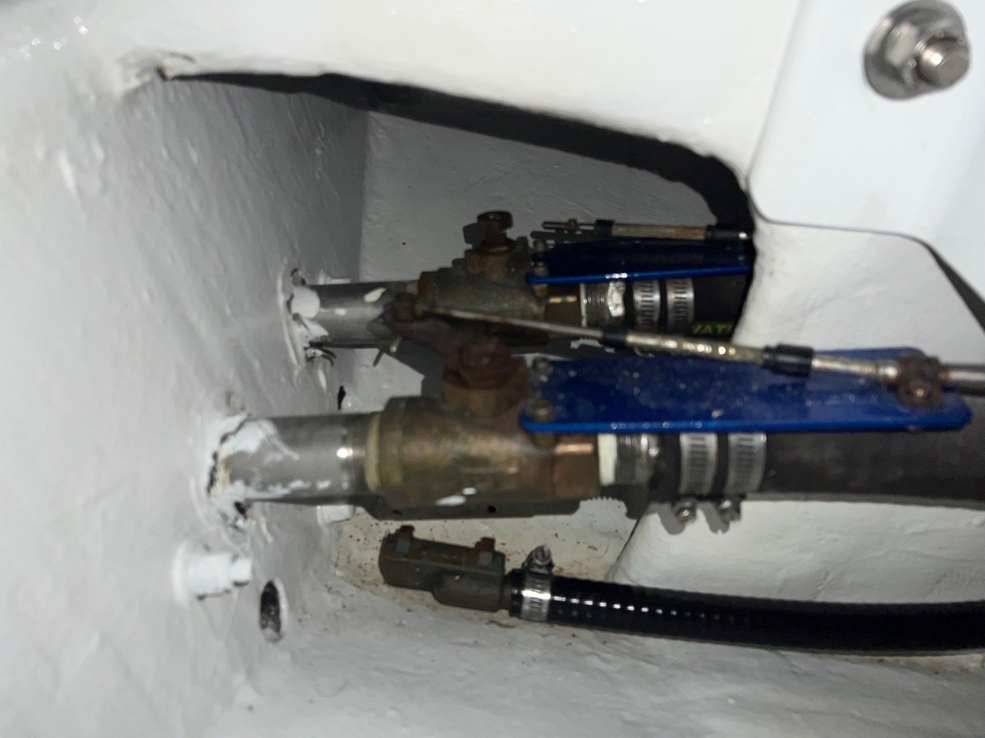

I hadn't posted an update in awhile, so here it goes. It was nice to be able to enjoy the boat some this summer here on KY lake and I was able to venture out to LOTO for the Rendezvous. I only put about 20 hours on it this year, mainly lining things out and tweaking things here and there. I've went from the -2 lowers back to standard length at the end of the season and still need some testing. With the -2 lowers I had to run the drives tucked in, much trim at all and it would start porpoising. Other than that I have a trim ram that's leaking around the seal that I need to address this winter and a good buff and wax and it will be ready for 2026. Not sure if anyone else had issues with the plastic T-handle for the water intake valves breaking, but I found some nice CNC handles that adds a nice touch to the bilge.

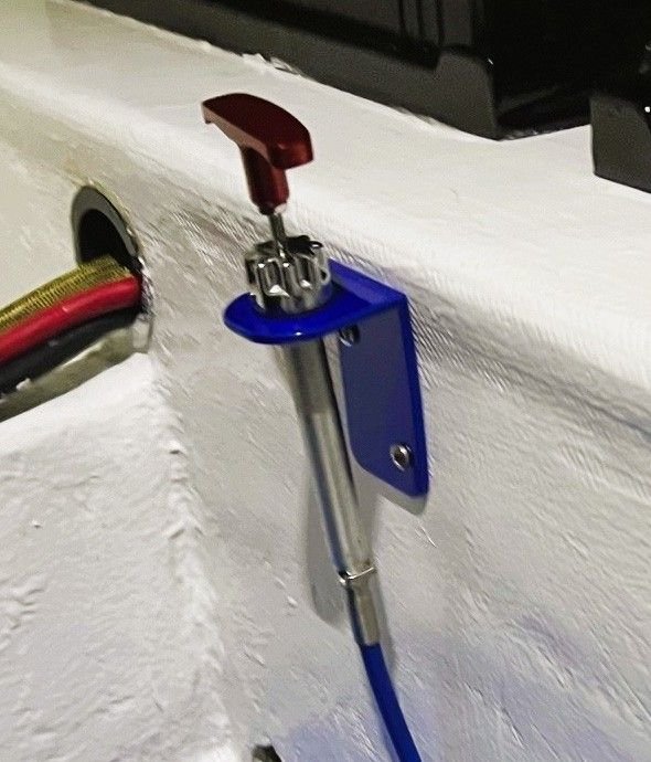

Where do you get the cable operated valves to begin with.... I have to be a contortionist to reach mine... I never knew they even made such a thing...

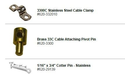

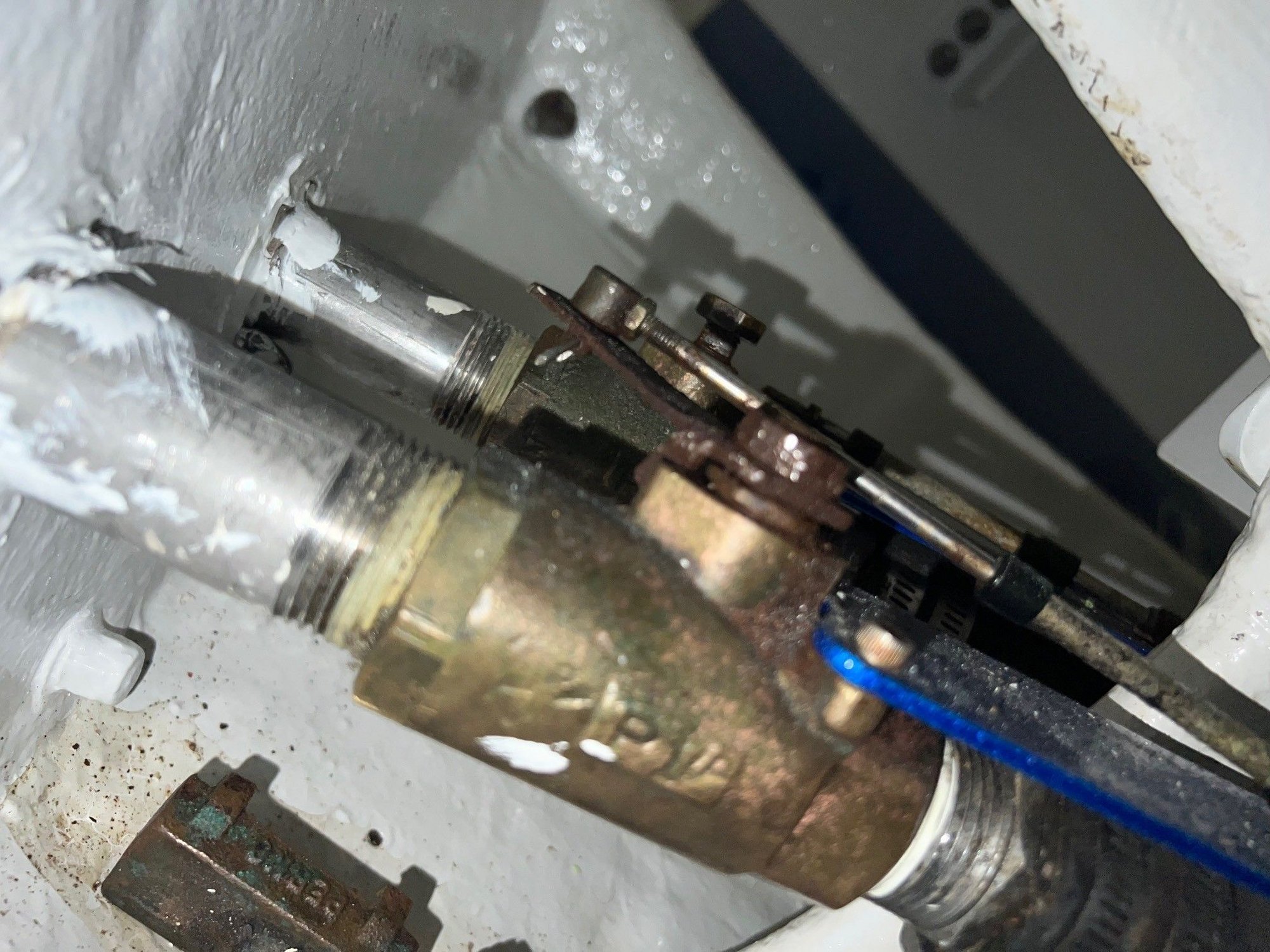

I'm not sure where to source the T-handle cable end, might try Lip-Ship or maybe someone on here can chime in. I've seen several 90/00's era TG's with these. Their 33C cables connected to an Apollo ball valve that has a mounting pad. Cigarette must have made the cable mounting bracket to the valve and cut down the ball valves handle (when I replaced my valves I done the same thing, but powder coated them after) the rest is 33C mounting hardware and connectors. Last few pictures is before I replaced and powder coated.
