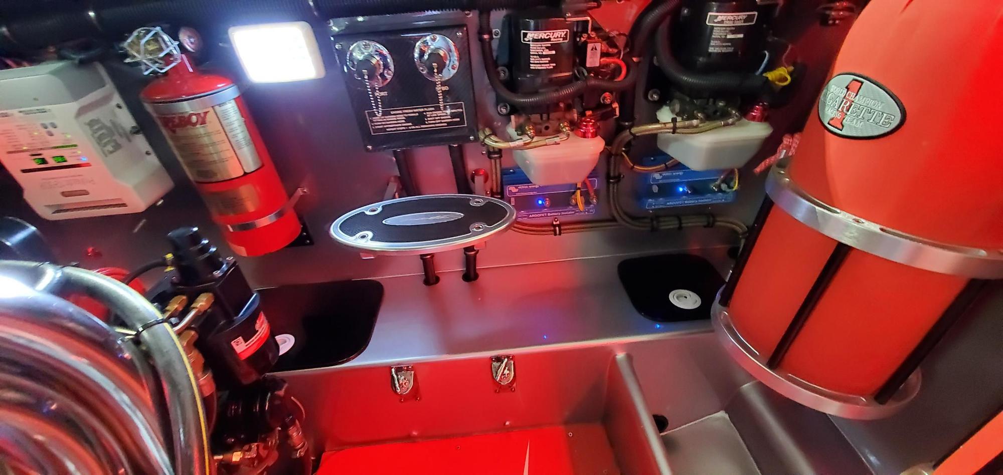

I have separate pick ups. The valves go right on the end of the pickup. NPT threads
I`m not sure how you`d do it with a bravo drive.
Nor-Tech put a handle on it so it`s easy to open and close. . (number 33 on it )
The red is there to remind me do not start engines if you see red , valve is closed, sea pump impeller destruction imminent. lol

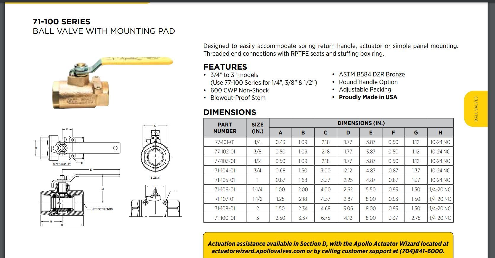

Dan,
Looking at ball valves. Lots of options. What did you install? Got a pic?
Thanks. Brad.
Brad, I would go with an industrial valve like Apollo or Parker. Earlier in the thread I posted this Apollo spec on the valve I used to replace my existing Parkers.
Jim,
This....?
Thanks. Brad.

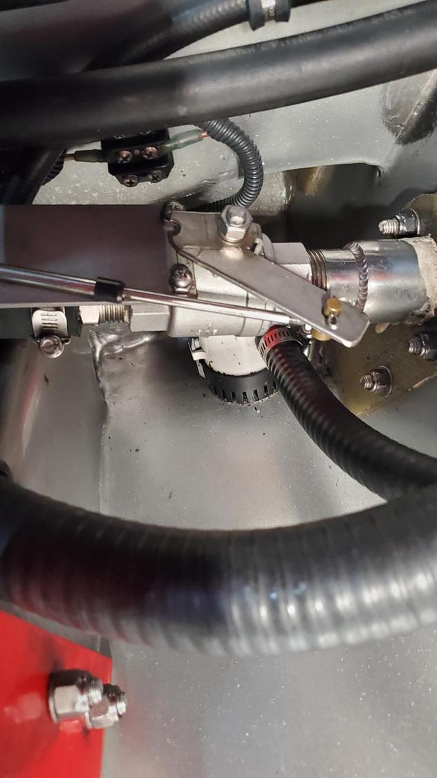

Here's a few pics for reference if anyone needs it.
Also, over time the valves would losen and water pressure would force them closed underway. PBC would fab a removable plate over the handles of the shutoff valves to keep them from popping up (Closing the Valve). I loosend one of the mounting screws and wrapped a zip tie around the screw and the shutoff handle. From end of July thru the rest of the season, I'd have to empty the strainers 2x a day from weeds in the canals, so I needed something quick and easy.
On my forward motor I was able to get in there and change it out. On my rearward motor, I was waiting till the motors had to come out.

Jim,
This....?
Thanks. Brad.
If you're just wanting an on/off valve, that would work. My original valves were bronze so I went back with bronze and I needed mounting for my cable actuator.
