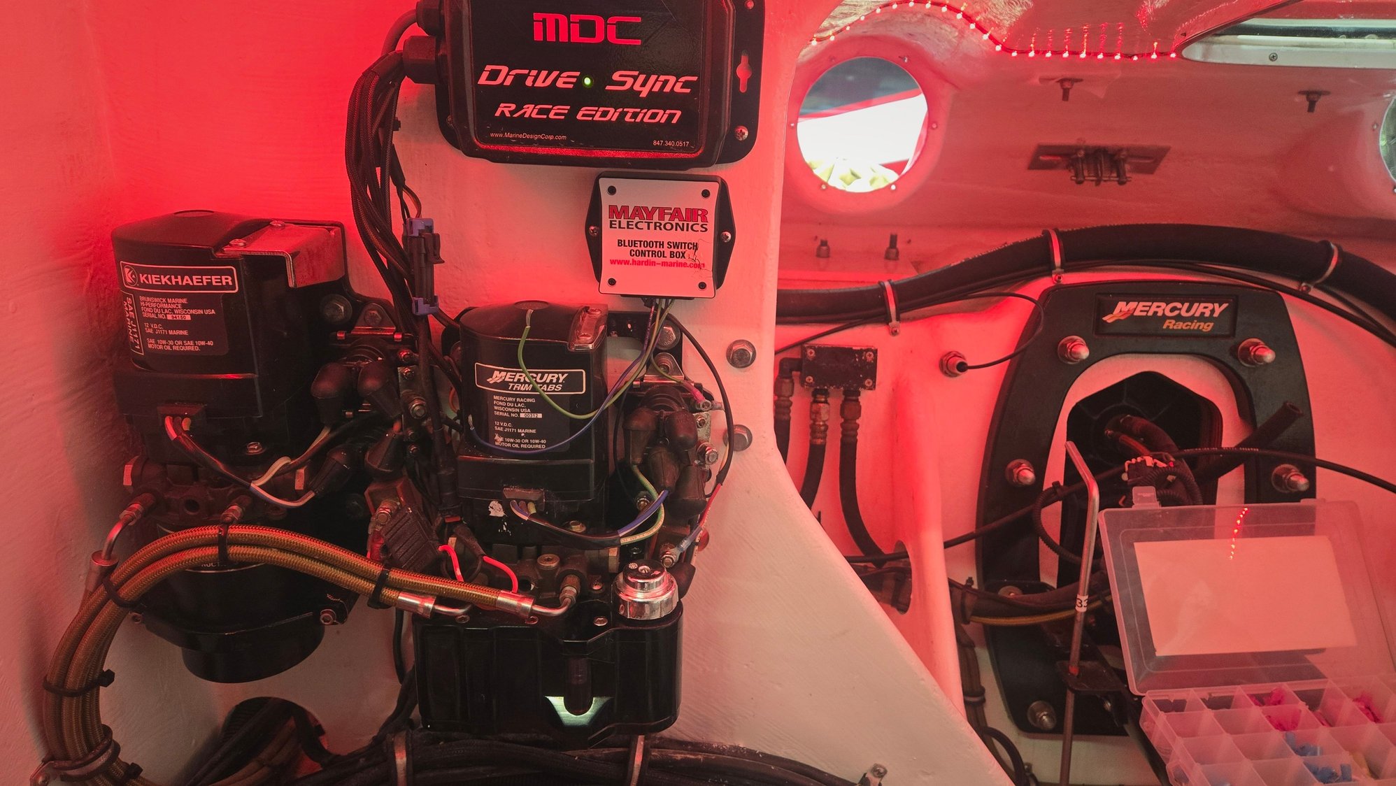

Your boat looks fantastic, I’m new to the group having just got my Top Gun in September. I’m still trying to learn everything that I can. What is this T handle water intake valve? Mine doesn’t seem to have these valves. There’s seacock valves near the strainers I believe they’re called but not like yours in that location.
The T handle is mounted in the open and uses a shift style cable that goes to the seacocks for the intake tubes on the transom! It makes it easier to shut them off if needed so you're not having to try and reach under the motor.

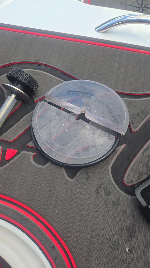

More importantly, if any water hose pops off or a leak , or your strainer lid breaks in half at 120mph, you have a way to shut the water off before it sinks.
