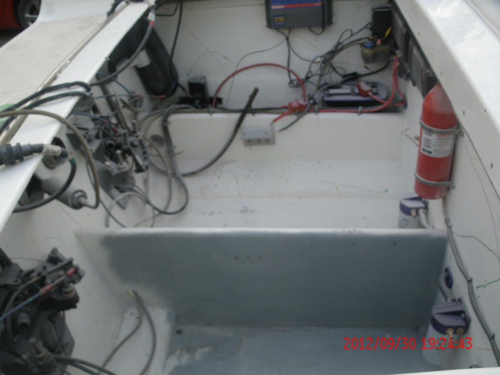

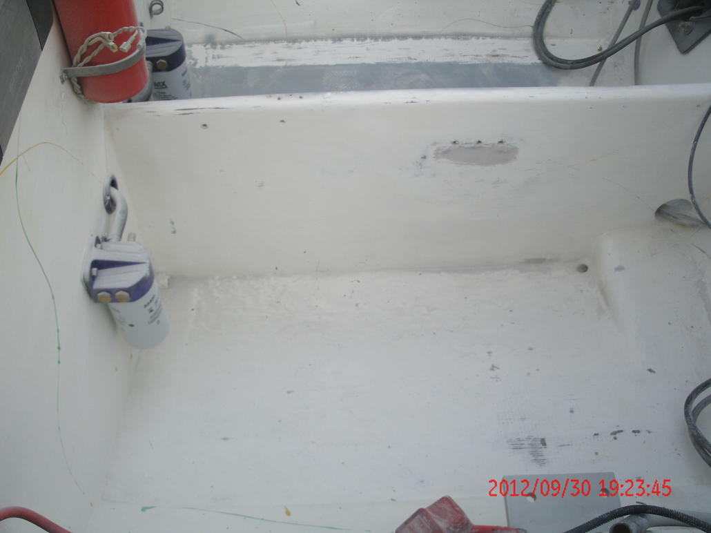

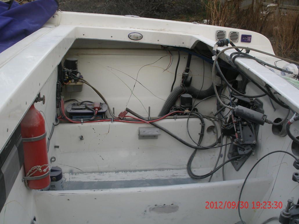

Here is what I have done so far, I applied some grey primer so I could see the high spots better.

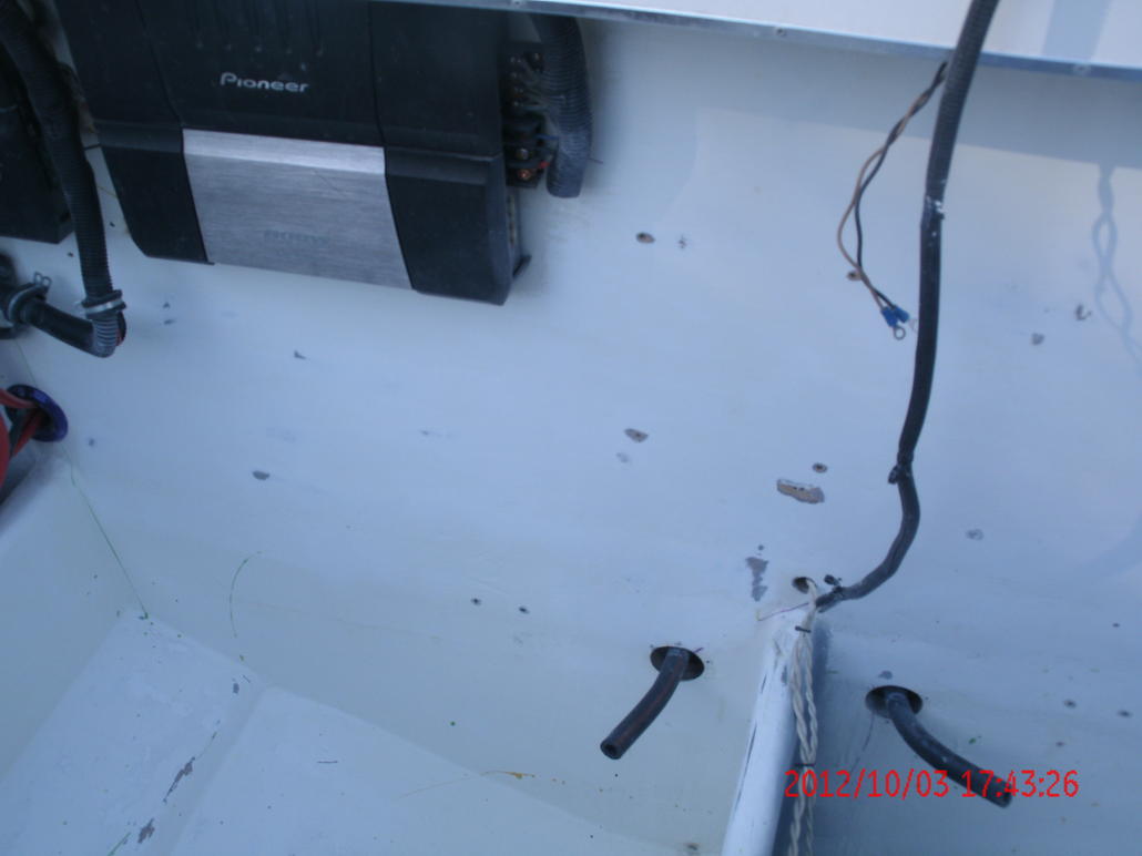

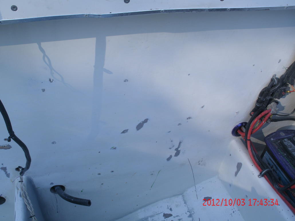

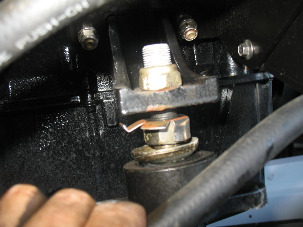

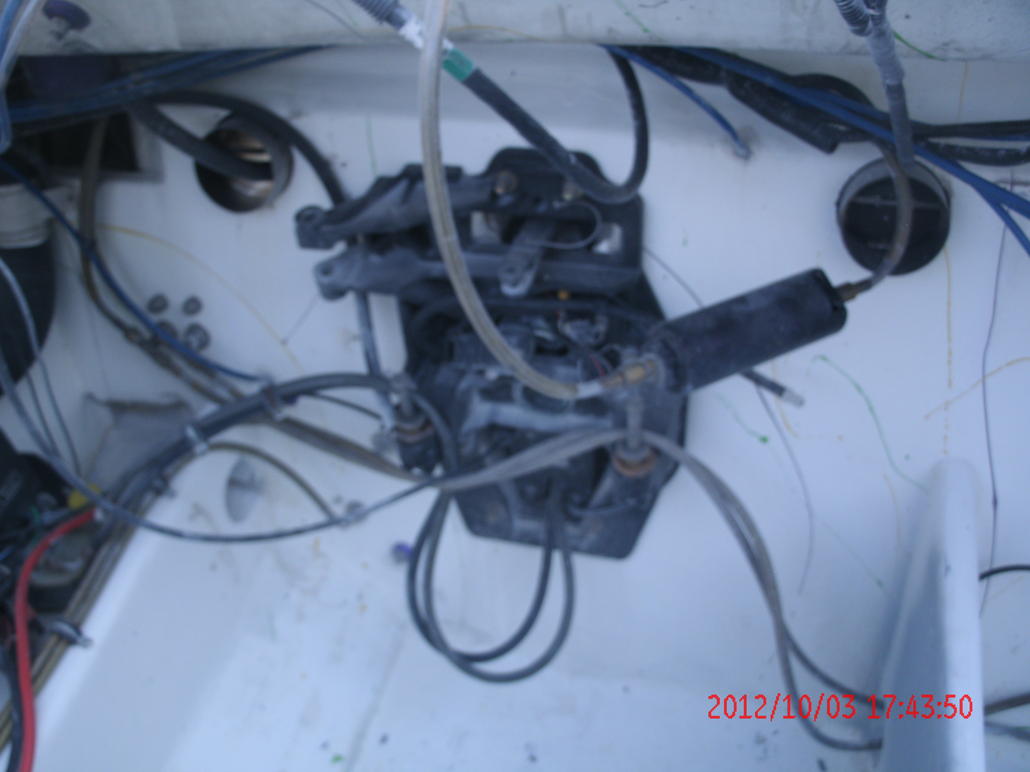

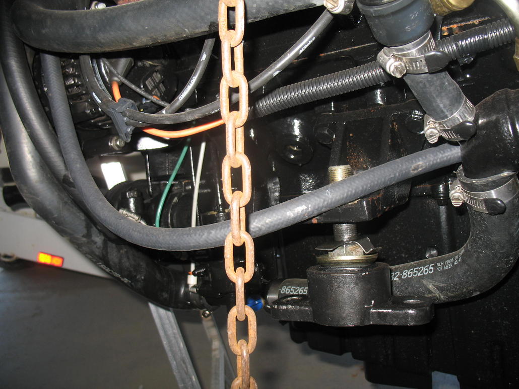

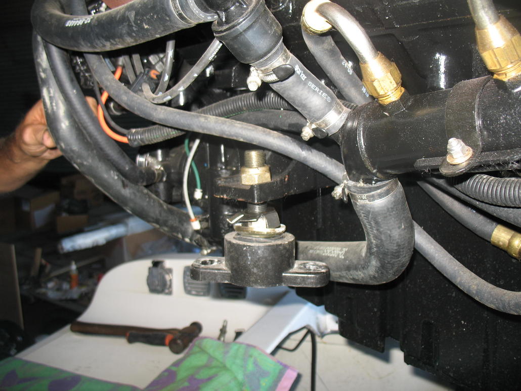

When I removed the engines I found the adjusting nuts loose by at least an inch each on all 4 mounts!!! Real nice since 1 engine was replaced under warranty for a starter issue that took a chunk out of the block. The mercruiser certified service center that will never see this boat again should have seen that especially since they would have to have lined up the new engine. I guess they were more interested in replacing a new bilge pump with a newer pump. Anyway the engines bouncing around in there bent the stringer bolts & egged out the holes causing me to have to make repairs. Thats why I am doing this, If I have to fill,drill, & sand might as well make things look a little nicer. Randy
