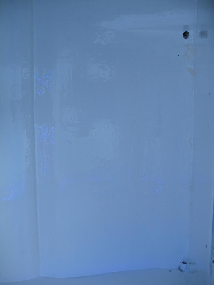

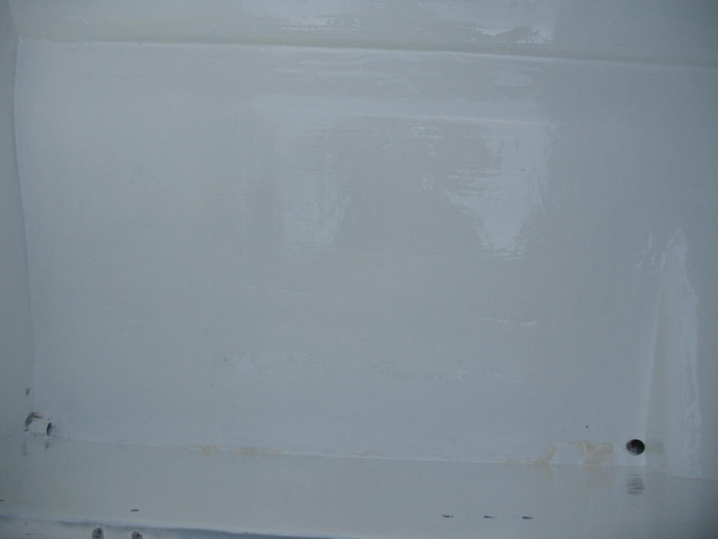

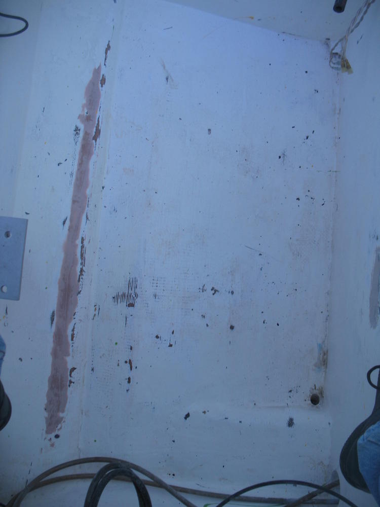

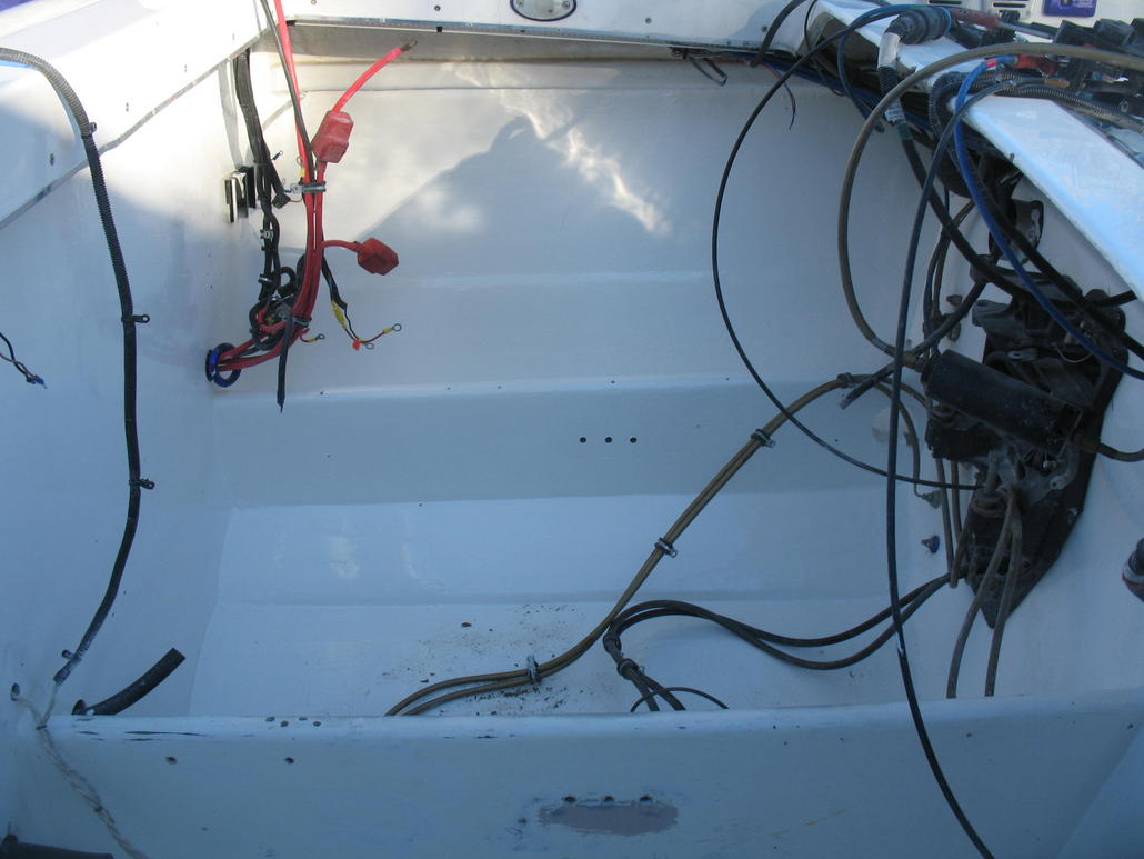

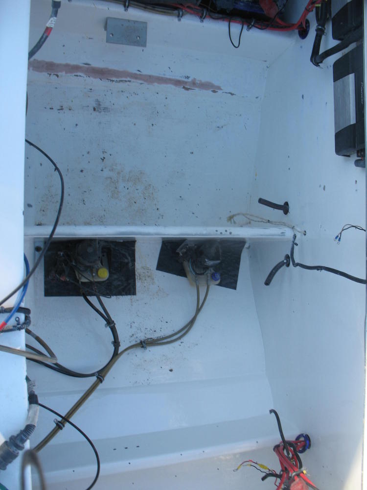

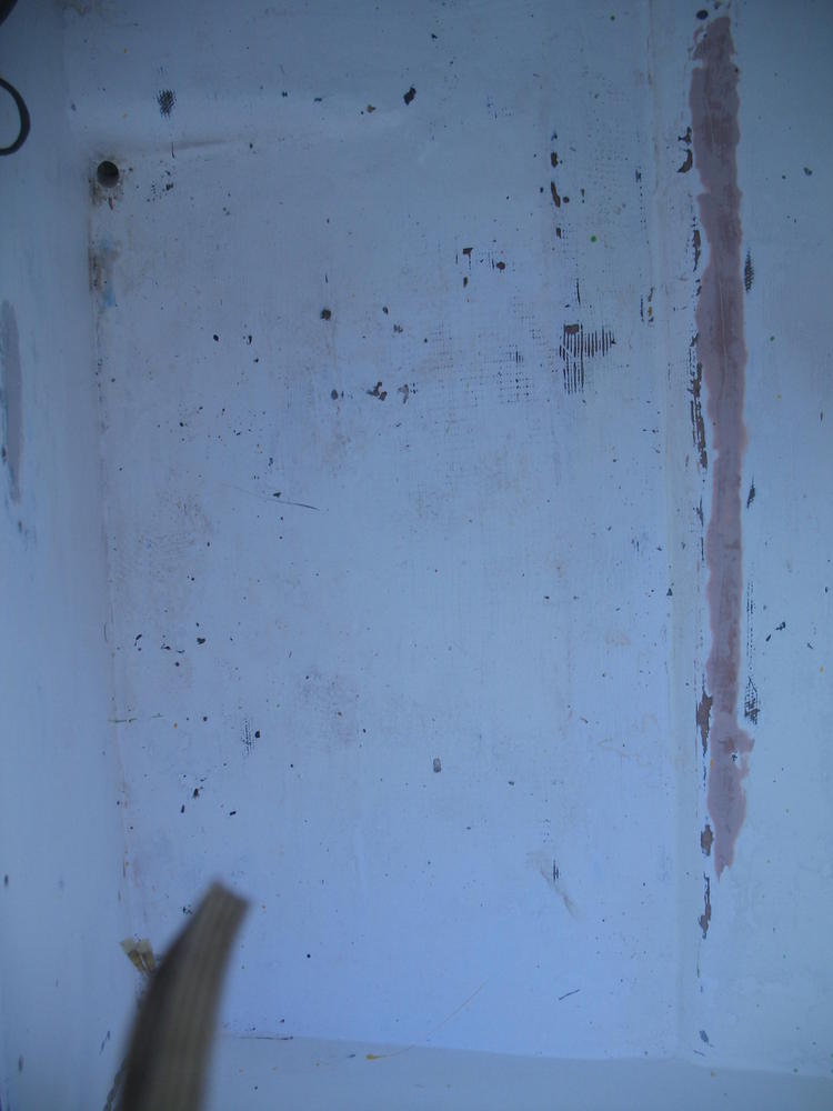

Got some paint put down today, what a difference! I am not stripping everything Im going to tape around the transom plates these pics show just the floor but I have the starboard half painted with 1 coat the floor has 2. How many coats should I put down? I mounted some lights while in there & they are cool. Engines & exhaust are on the way, will update when more is done. Randy

Looking great. Keep up the good work. Artie

Got some more painting done, if anyone ever tells me a body man/painter doesnt earn their money they might get a punch in the mouth,LOL even with all of the sanding I have done it still isnt really smooth but shouldnt be a problem as the water just beads up on this paint.

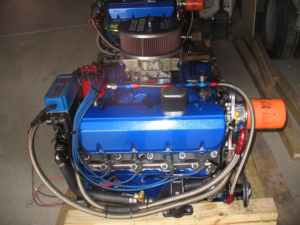

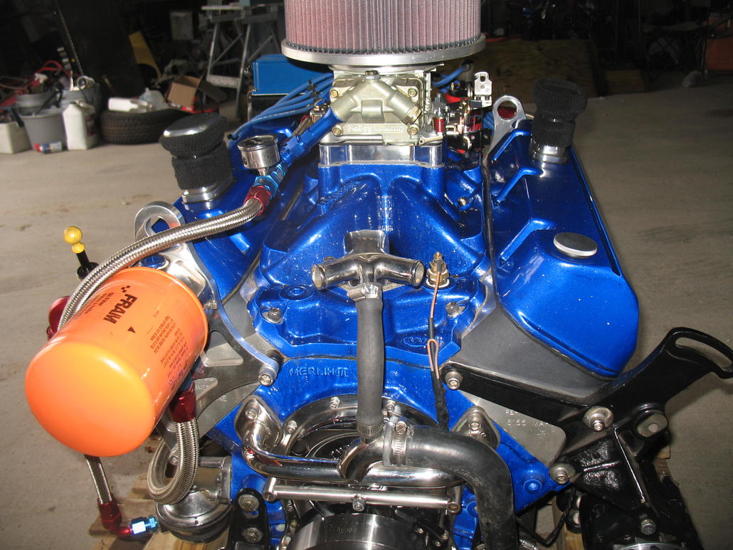

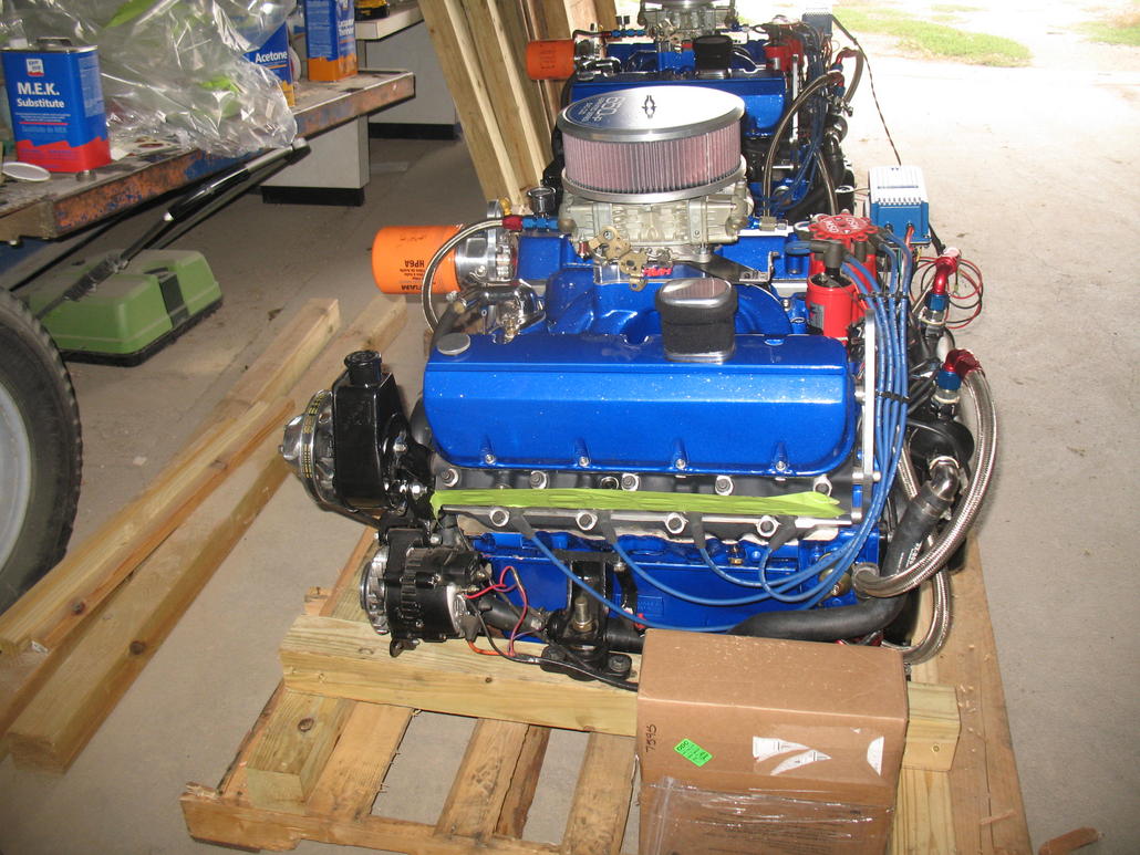

Engines & exhaust were delivered today I guess I had better get busy

randy,engines look good,did you get them from a member on oso?

Old 10-23-2012 | 07:37 PM
Randy Nielsen's Avatar
Joined: Jan 2011
Posts: 1,482
From: Omaha Ne
Not sure if he is a member but they were advertised in the classifieds. Bullet Engines, Ontario,Canada. He is very easy to deal with & does a nice job these things are ready to drop in & go. Seeing them up close they are purdy!!!! Should look even better with new CMI exhaust I got setting in my garage. Randy
