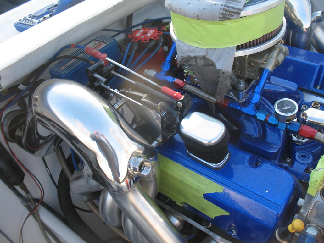

Originally Posted by Randy Nielsen
The problem is that the bracket is too close to the breather, If I redrill the bracket to move it back a couple of inches that might do it or just make a new bracket altogether. Randy

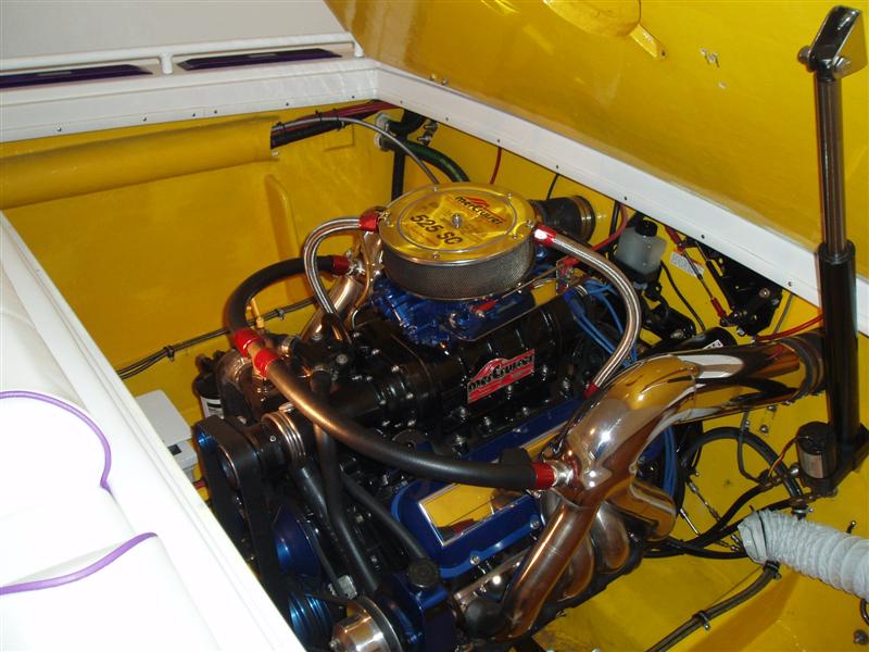

I would just mount the shift linkage on the transom then. Thats what I did on my Pantera.

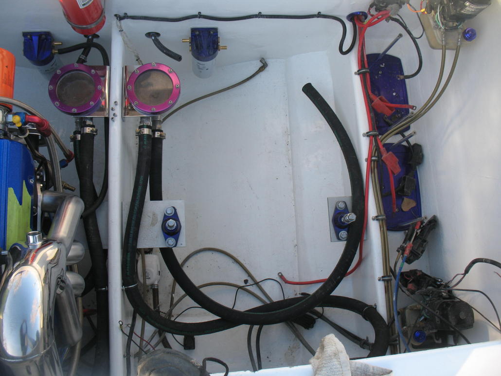

Plumbing, wiring, & shifter
When I decided to drop the coin & make this project happen I was just going to pull out the 496's, clean up the bilge, fix or replace whatever wasnt working, drop in some new power & go boating. After cleaning I saw the runs in the paint & just a dingy look overall, so out came the sandpaper & off to town I went. I was able to sand & paint without completely disassembling everything, now going back together I am taking my time, taking pics of my progress & after reading the build threads here on OSO decided to do the same. After reading comments/ advice & talking to a few people I have made a few changes from the original plan. I was going to bolt in new power with the same hardware that came with the boat. I talked with Sam " the deep" the other day about installing engine cradles & he offered some good reasoning for going that direction, I dont think I am going to do that just yet after looking things over considering the previous engines were loose & moving around nothing was broken but some bolts were bent, I have adressed that problem by replacing the bolts with larger bolts. I do want to go on record & say that if I do have any issues with engine mounts Sam has first dibs on telling me " I told you so". I dont think I will have any problems as this boat has had this kind of power in the past without problems but I will keep my eyes open as I break in these engines. With that said here are some pics of progress, plumbing, wiring, & shifter placement. Again thank you for your comments/ advice I do take them into consideration & nothing is set in stone yet. Randy

I intend to!! Just waiting for the weather to warm back up so I can finish running wiring then I will drop the other engine in before putting in storage. Randy
