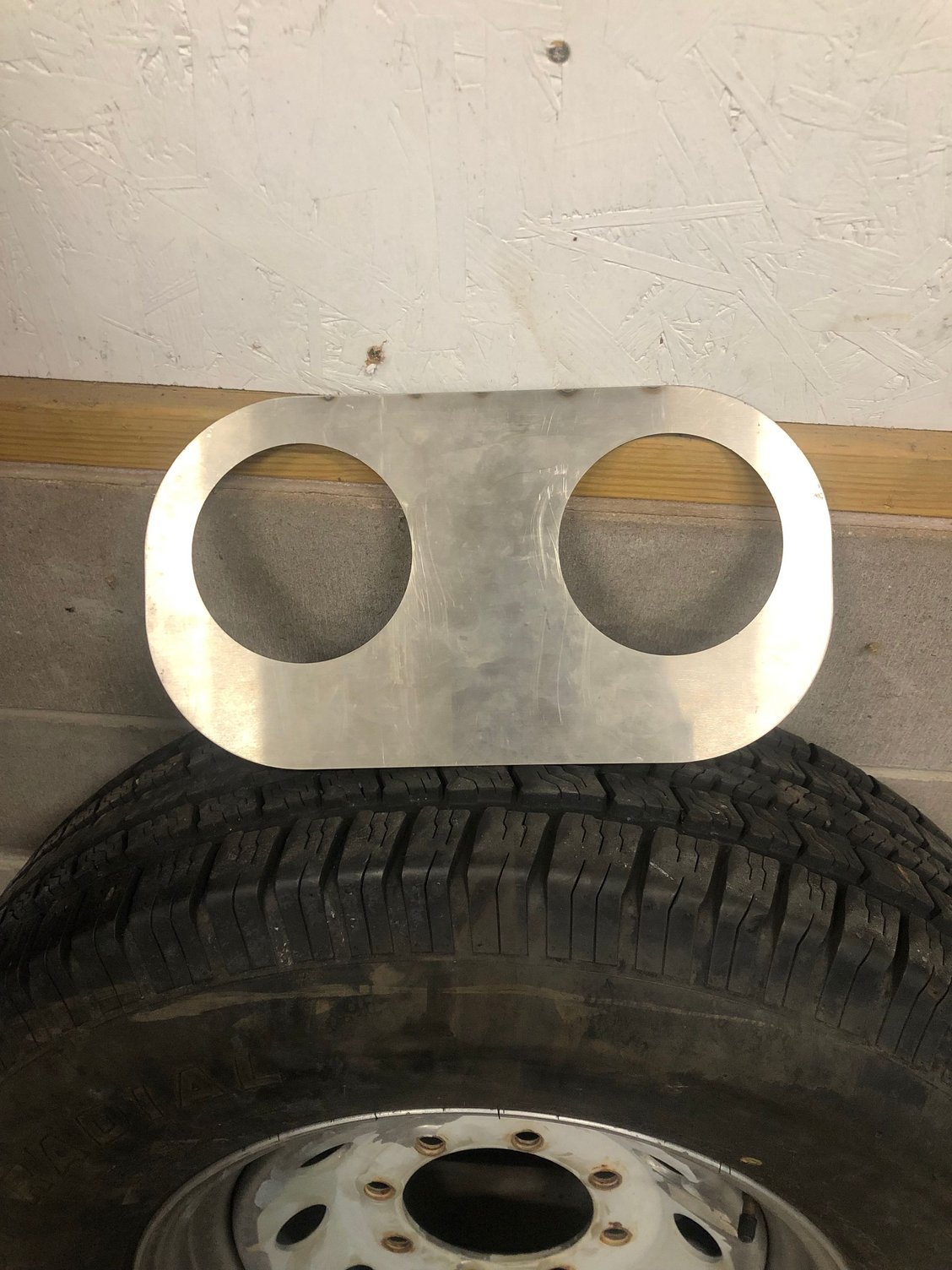

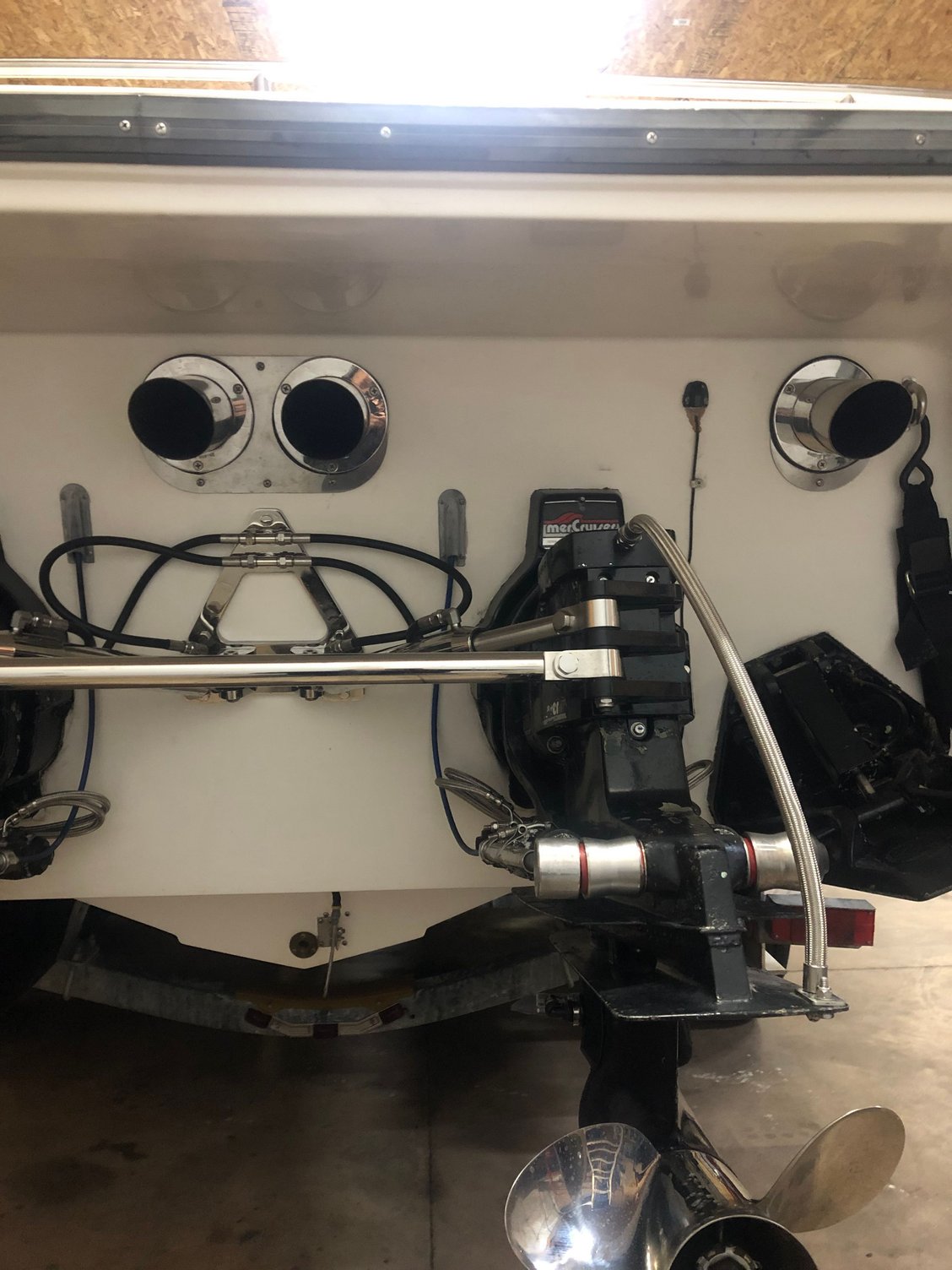

Above is pics of the offset plates to cover the transom holes I had made, I used a wire edm to make’em but pretty sure anyone with a cnc plasma table could burn’em out for you. Not to mention places like send cut send.com would does plasma/laser cutting etc could do it as well.

It was because of your post I ended up making a set of beauty rings like yours. Thank you for that.
I wound up buying a 1/16" stainless steel kick plate for a commercial door, and carefully cut the rings with an angle grinder out of it.
I'm hoping to not use them as that would mean I had cut more material from my transom. I'd like to find a better alternative if possible.
I did see Corsa will make custom tips and some of theirs do have offsets like I need. Will prob be around $450-500 though.
If you have any good pictures of your set up, could you please post them up? I'd love to see what you came up with.
