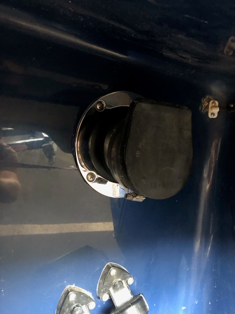

New exhaust tips showed up today. They just might work. A couple concerns though.
1. They are only 304 S.S.
2. The "pie cuts" on the inside create a seam where they meet. So there will be water sitting in those seams. Unless I can find something that will fill them in?
3. There are no flappers in these. I do however use Salisbury flaps. Should I install an aftermarket flapper where the tips meet the pipes? Or are the Salisbury good enough?
https://www.cpperformance.com/p-2246...ess-steel.aspx
Does anyone know what the difference between the "rings and seals" and "rings and gaskets" is? "Gaskets" are a lot more $$$
https://www.cpperformance.com/p-1370...od-x-5-id.aspx
https://www.cpperformance.com/p-1105...sket-each.aspx
Xlint,
With the quality of those welds, I'd guess they know what they're doing. With that in mind.... I have a guy with a weld station set up in my shop that also knows what he's doing (he welds stainless and Inconel 10hrs a day, 5 days a week at his day job). From what he tells me, they get full penetration through the wall thickness. They will have either set a small gap between the two pieces being joined and will have filled that gap completely with filler material, or just fused the two pieces together, with some extra filler to bridge between the two pieces. They don't just glue them together with a bead of weld. You SHOULD have no gap on the inside whatsoever.
Thanks. Brad.

Thanks for the replies guys.
Definitely a "lip" on the inside. Some are better than others. (nothing real bad)
I thought about filling them with something like JB Weld and hand sanding to smooth it out. My fear is the JB may break loose and disappear with expansion/contraction. I was actually considering using high temp silicone in the seams.
Thanks for the heads up on the TCM rings.
My tips are high enough to not worry too much about wake entering them. Just felt a second set of flaps was good insurance. Those in-lines look to be a bit restrictive, so if not needed, I'll pass.

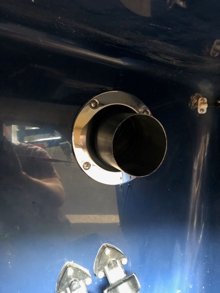

We have an exhaust system.

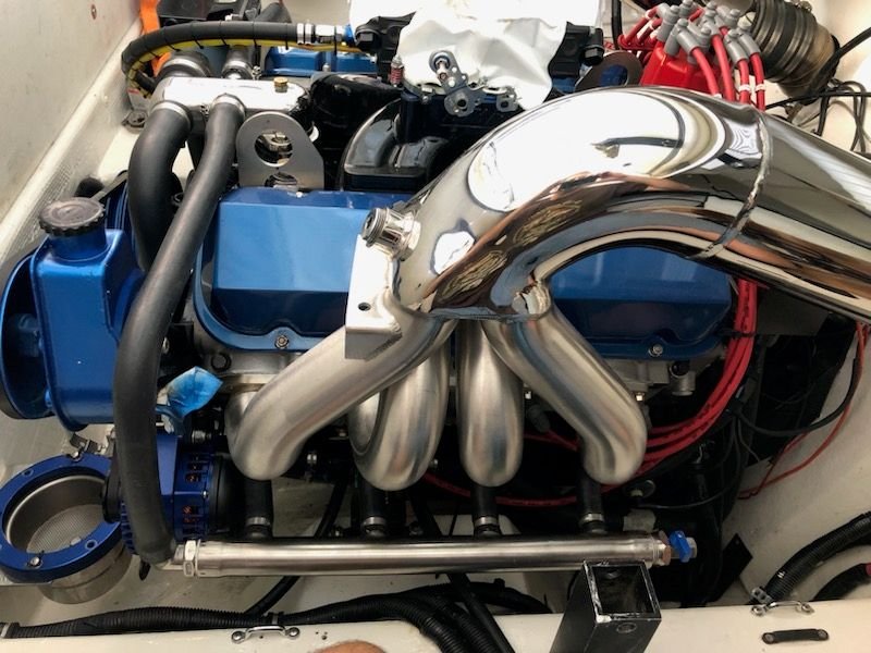

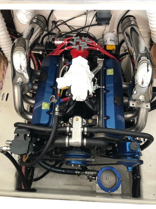

Here's what I ended up doing to clear the bigger alternator.
