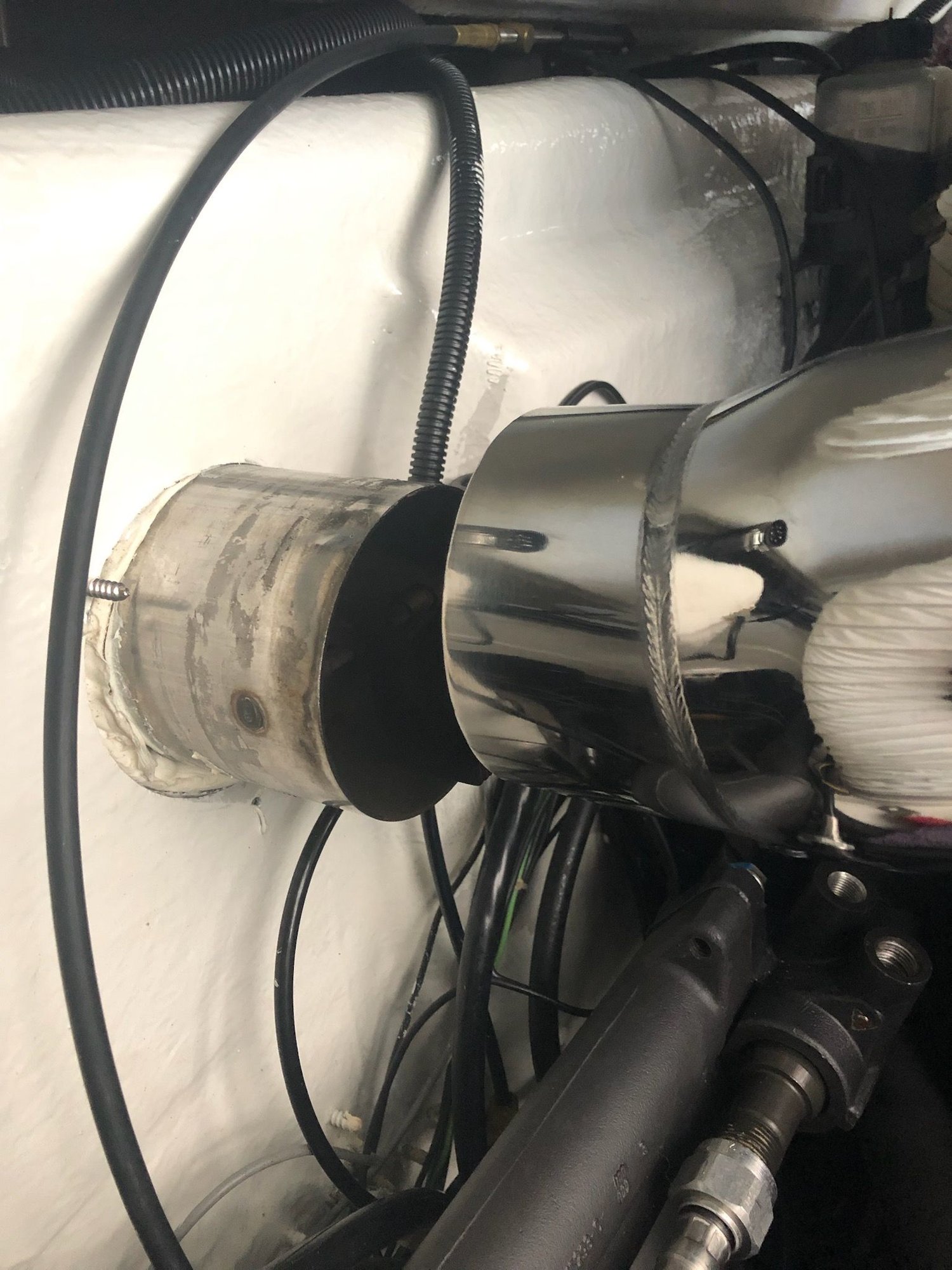

Installed Promaxx heads on the HP 500 carb engine and the exhaust tips are about 7/8" lower then the CMI Fusion pipes. I do not have access to a machine shop to make my own beauty rings to cover the longer holes.
Does anyone think I can utilize one of these 7" OD x 5 1/" ID transom rings from Hardin if I trim my exhaust tip OD to fit inside it? https://www.cpperformance.com/p-1105...ange-each.aspx

Unfortunately I'm still kind of stuck with the exhaust height problem. I can't raise the exhaust tips too much because the flange is really close to the bottom of my swim platform. And I'm not crazy about cutting the holes in the transom much bigger. You can see I did it once already when I had the Seaward exhaust installed and the height was a little bit off then.
Does anyone think I can use the transom rings with the silicone seal and new tips at a slight angle? https://www.cpperformance.com/p-1370...x-4-12-id.aspx Or these? https://www.cpperformance.com/p-1105...flap-each.aspx
Or does anyone have another idea? Thank you

Just to get through this boating season you might be able to use a silicone hose to connect them. Much more pliable. Might have to cut another inch of of the exhaust tip to make it work? Other than that, I would go with modifying the exhaust tips. Going to have to "Pie Cut" till they line up.
Find someone to modify your tips with a S bend (double miter). Looks like there is room. Might have to massage the transom opening on the inside to get them in.
