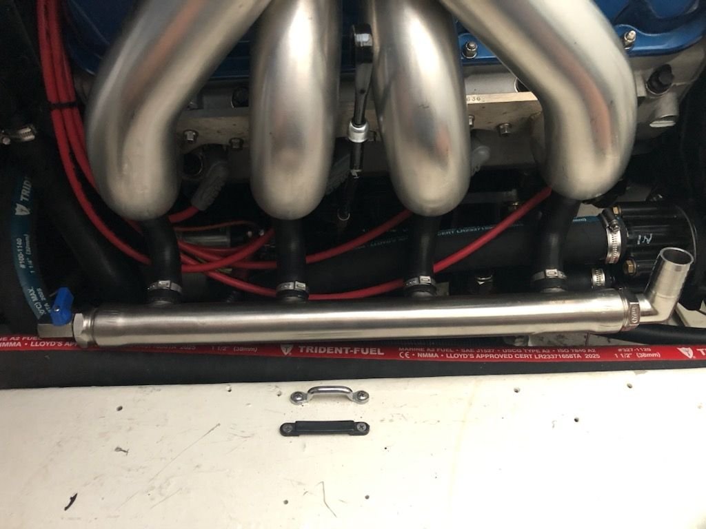

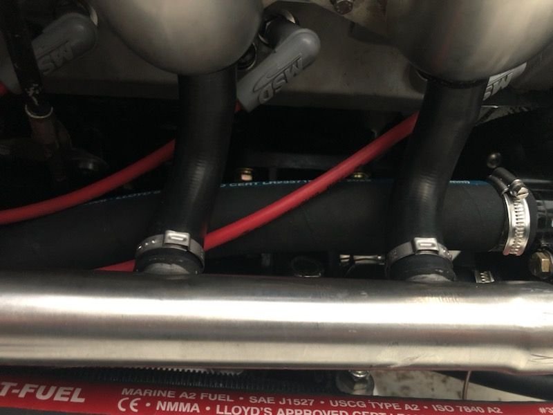

If anyone is ever in this same boat as I am, these pics might help you.
Best route for me was to get the water rails and use the shortest "L" shaped hose I could get. I bought (8) 4"x6" hoses, and cut them down. So far it seems like it should work. We'll find out after everything is all installed. I still need to run my battery cables and install the batteries.
