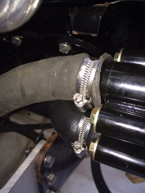

I doubt I would be able to see the hose collapsing. The hose is very stiff - possibly with wire. So my guess is the inside may have separated from outer and is collapsing. As you can see in this picture, the hose looks to have failed, at least on the end.
[ATTACH=CONFIG]524319[/ATTACH] [ATTACH=CONFIG]524320[/ATTACH]
Looking inside, I cant really see any delamination or defect. I spoke with previous owner, he said he never replaced these hoses (although he only had boat for 2 seasons). My guess is that the hoses are circa 2002.
I haven't measured belt tension, however my elbow is calibrated (I used to be an ASE Master Tech when I was in my 20's). The pulley spun freely when I put the new pump on about 1 month ago - and since the condition is the same today, as it was end of last year - my assumption is the pulley is ok today.
I appreciate all of the suggestions and questions - even the ones I've already answered. Helps keep me in check! :-)
