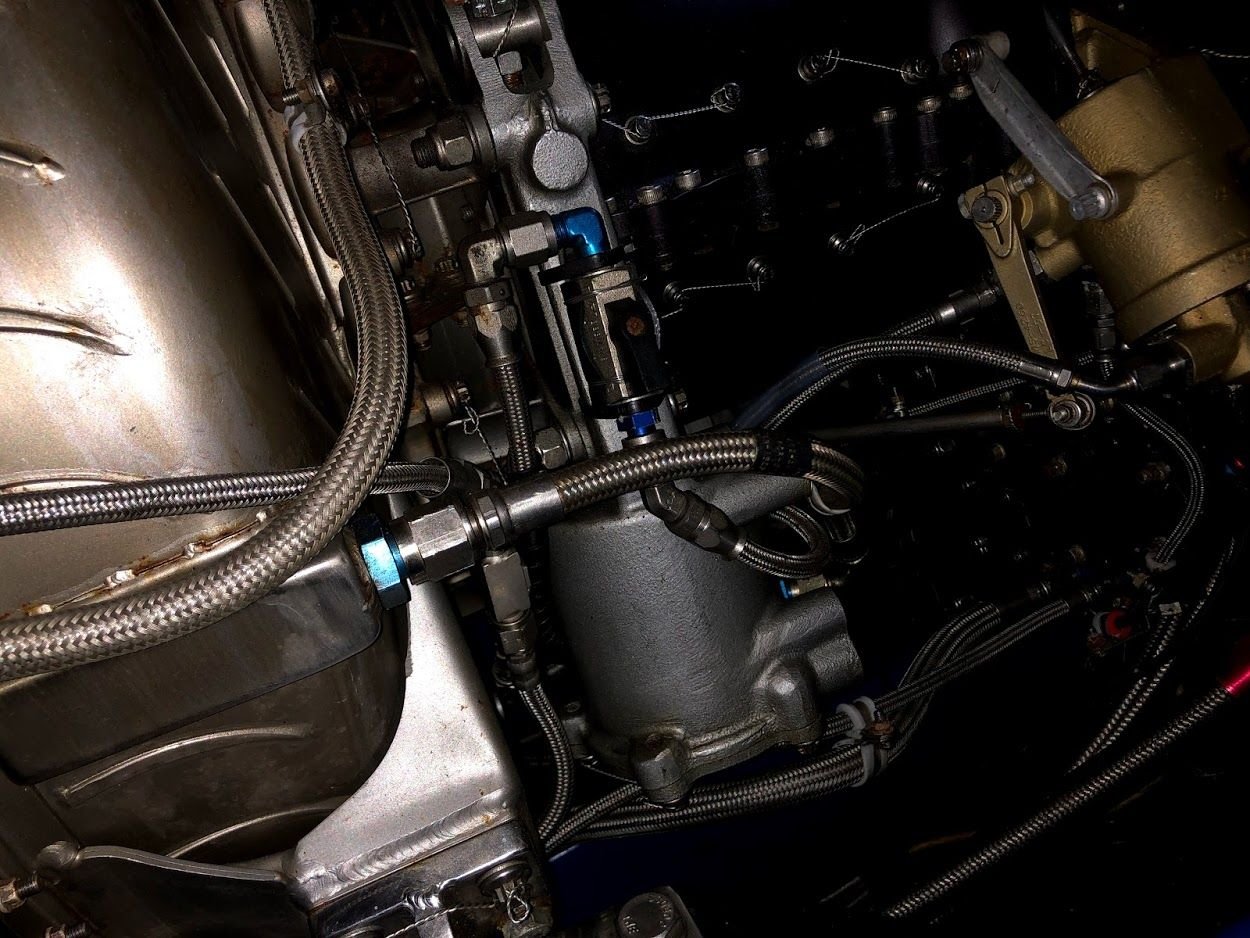

Going onto compressor wash I noticed my motors have a tap fitted to the bleed valve actuators I remember talking to a guy about the wash procedure and don't remember if this tap is to prevent the water/meth solution from getting into the actuator during the wash procedure or if its to keep the bleed valve open or closed during the wash cycle.
Any thoughts?

Jay, you are grouping 4 different things together and only one of the processes requires manually closing the bleed band valve that you pictured above. I’ll try to explain.
1. In the beginning Arruda put the spray nozzles in the intake to do an online wash with water while running in salt environments and it offered a little cooling.
2. Adding meth to that mix dramatically increases cooling ability.
3. An online wash at the dock with engine running and a 4-1 mixture of Zok 27 compressor wash/fresh water at about 2.5 gallons a minute sprayed into the intake.
4. Last is the most effective. It’s an offline wash with 4-1 zok 27 mixture at 2.5 gallons a minute. First you manually close those bleed band valves. Next turn off everything on engine breaker panel except the top breaker which will allow you to motor the engine with no fuel. Have somebody start motoring the engine while simultaneously dumping the Zok mixture into the intake. DO NOT motor for more than 35 seconds and if you have to motor twice to finish the 2.5 gallons, then wait 3 minutes in between motoring. Once you’ve done that, fire the engine up to dry it out.

Thanks, Adam that's great advice, I want to keep the engines in tip-top condition and keep on top of all the maintenance and do the washes correctly and your post has answered everything I need to know about the wash procedure.
Much appreciated. J
