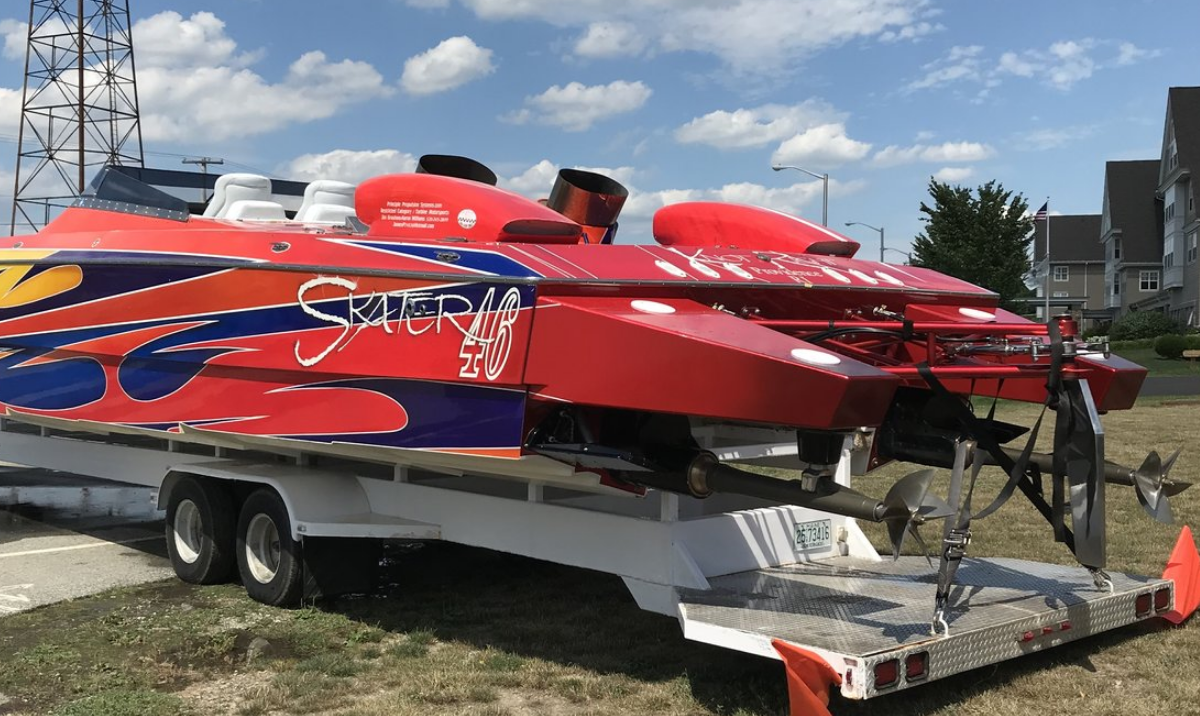

How does your steering seem to be working? just looking at some comparisons and your rudder looks shorter than the one on my boat it might just be the angle of the photo.
Mine is also ridiculously sharp like a knife hence the reason it's covered.

I'm sure that's the case once the speed increases and the tunnel packs some air the boat will generate lift and the tunnel spray/drag will reduce.
What % did you get to on the last run and was it not possible to just open the hatches to get more air in as a temporary measure?
hatches are not on hydraulics. I could have removed them with fair of that rudder wash i get soaking the bildge with salt water.
The rudder that i used is off of Al copelands 46 that did 191 mph. This rudder worked on the same vintage 46 skater as mine.
its 32 inches long and its 6.25 inches below the keels.

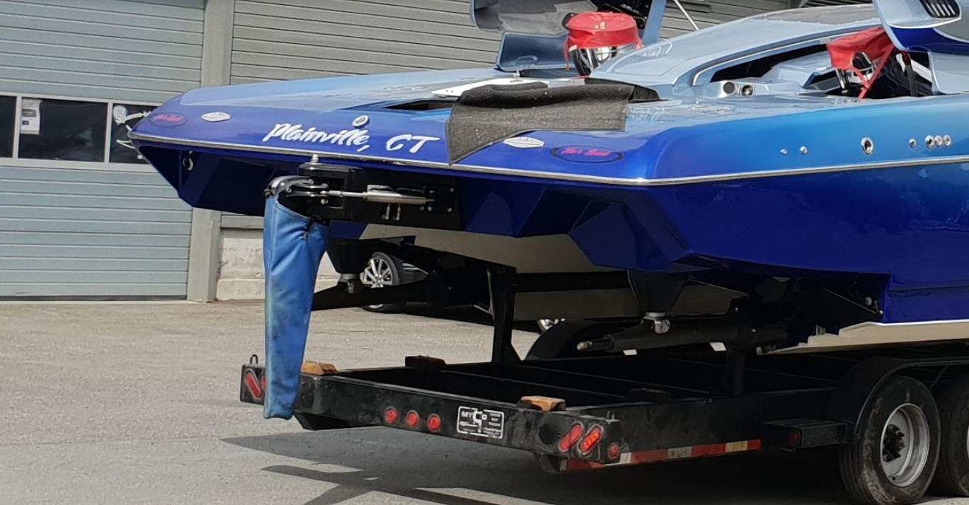

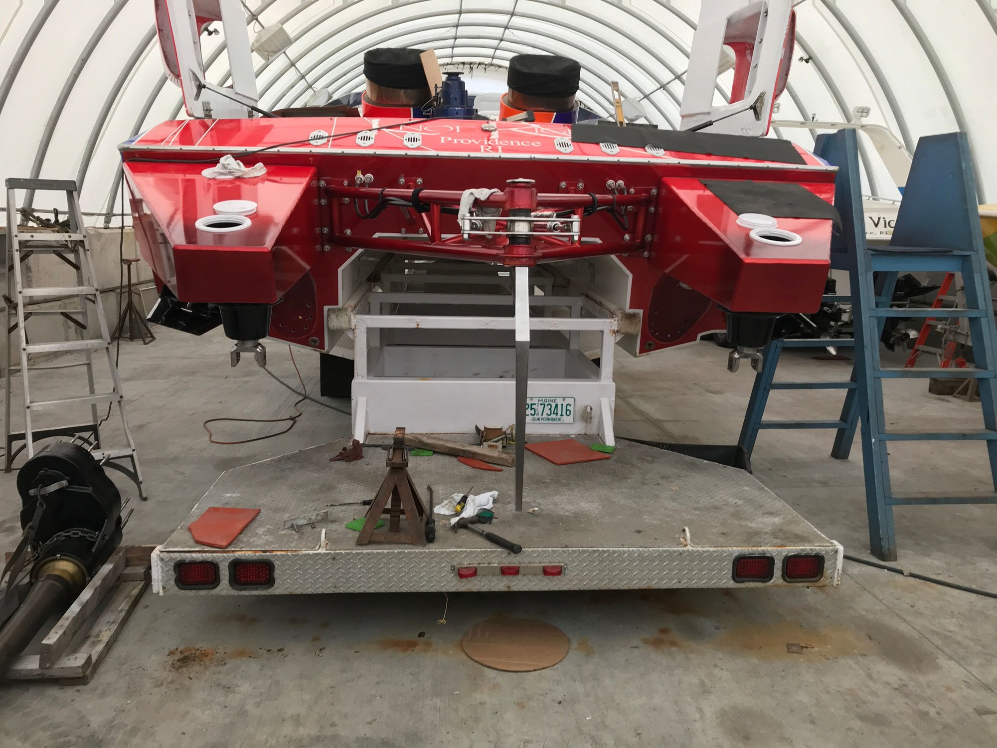

I can see it better in this photo rudder looks lower than the photo taken from directly behind.
The setup looks pretty much spot on have you tried turning the props in yet to see if the boat performs any better.

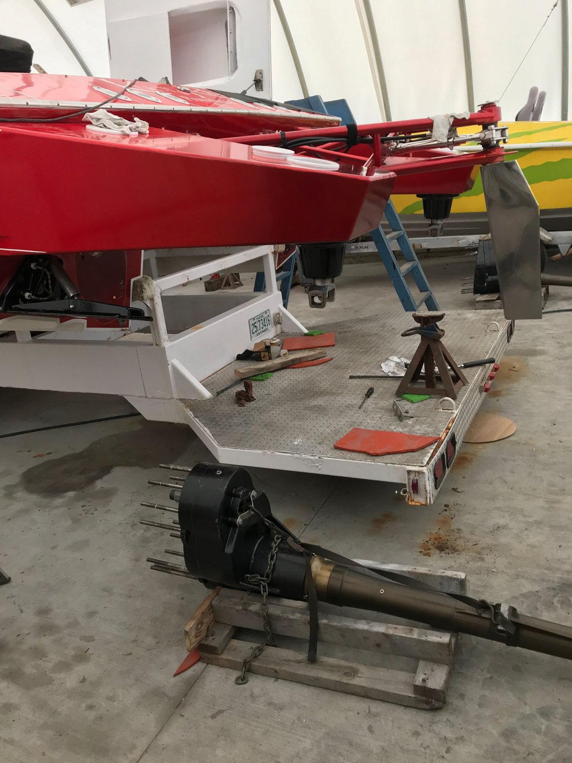

Now that drive shafts and shift brakes and crashboxes are out of the way.
i took advantage of the room to get at
the 12 nuts holding on the bpm drives.
spinning the propellers in requires swoping
the drives . Do not swop the wedges like i did the first time. I cought this after starting to
torque down the nuts realizing the wedges are
specific to left and right.... Duh
