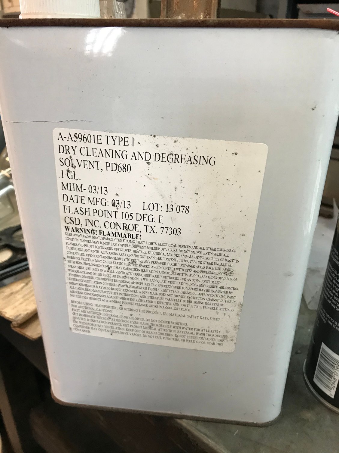

Gerry what do you use for compressor washes and how frequently do you do them.
i have a built in rinse/methanol rinse
when i come back in i rinse for about 20 seconds a motor make sure n1 is over 80percent
the below procedure is done on trailer and is
pretty much too military spec
I have done this maybe three times in 14 years

Thanks, Gerry that's a great help that's what I was looking for, I have some ZOK and was wanting to do a full clean like you have documented rather than just the spray bar clean.
The strange thing is mine has taps fitted to the bleed valve actuator but using these will keep the bleed valve open rather than closed allowing all the cleaning fluid to run out of the engine.
My thoughts were the same as yours that pressure is needed to keep these closed to keep everything in the motor.
