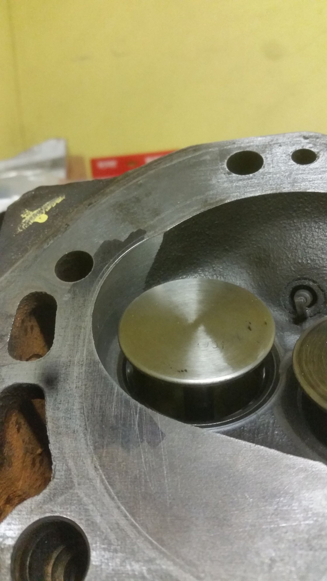

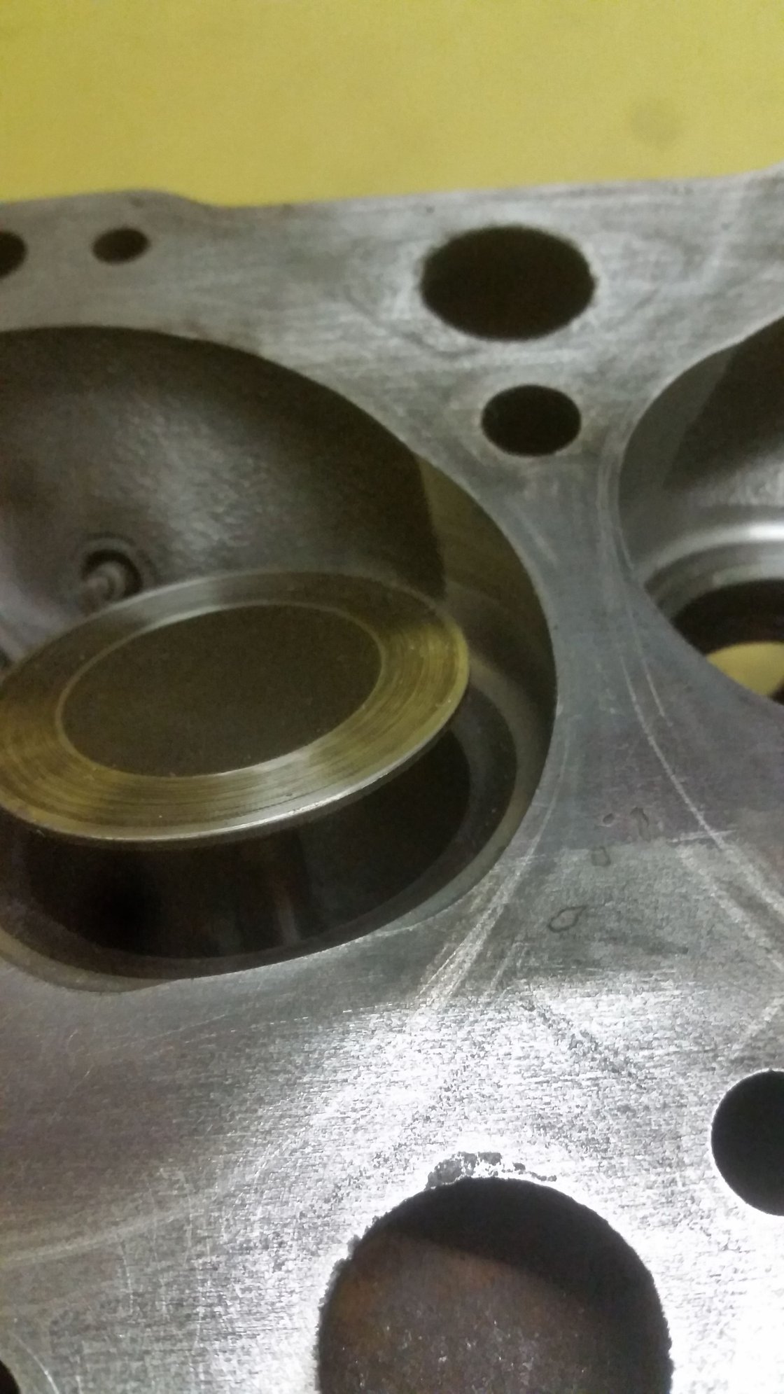

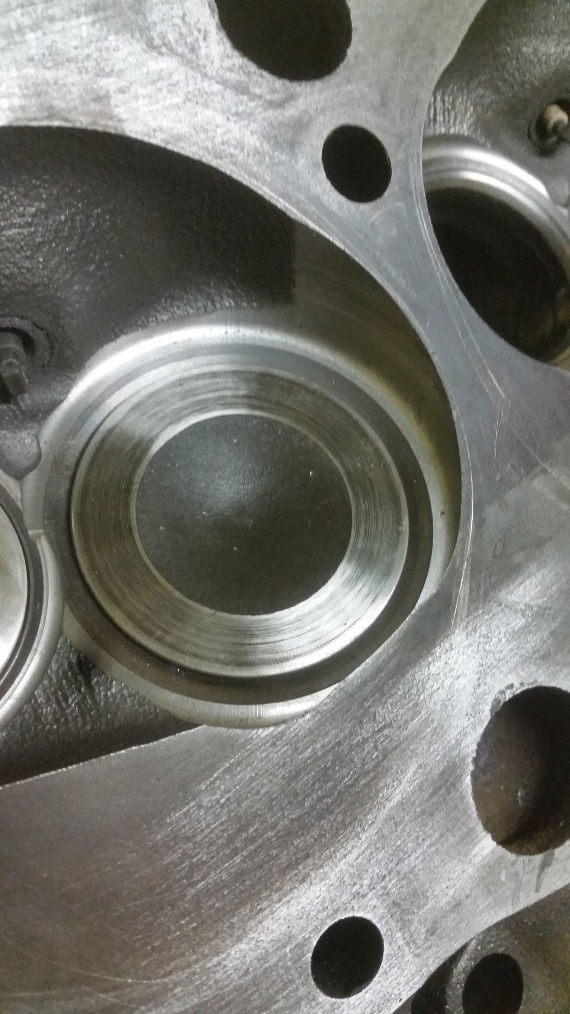

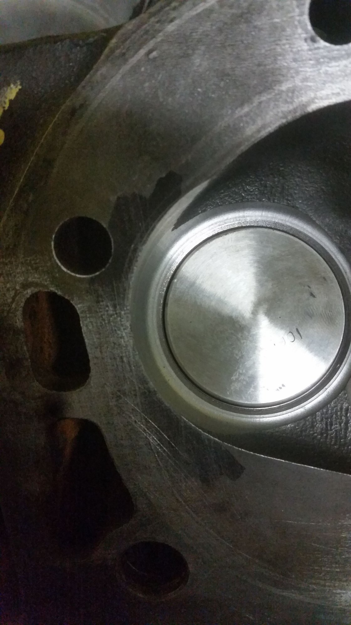

Life is a *****. Right after i bought the DARTS my machinist called that hi has unshrouded the valves of my peanuts, also made 30° back cut to the stock valves. Cant help myself have to do some flow testing.
exhaust.
intake.

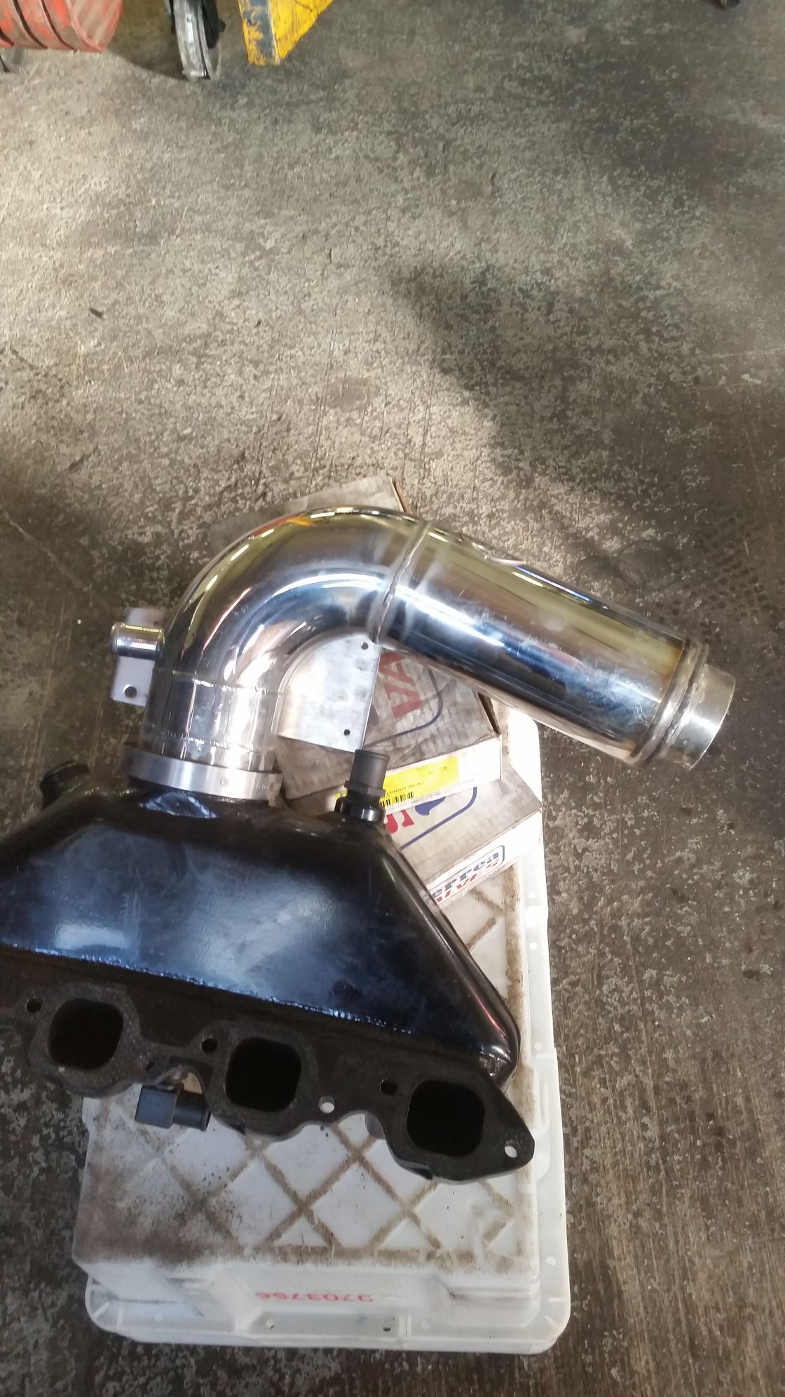

What is the purpose of the braided lines connecting the front and rear water ports on each side of that intake manifold?
Kicker30 is offline
Old 04-16-2019 | 06:32 AM
  #116
Posts: 3,601
Likes: 1,169
From: taxachusetts
move water from the back of the head,so steam pockets don't develop.makes water temp more consistent across the whole head.
