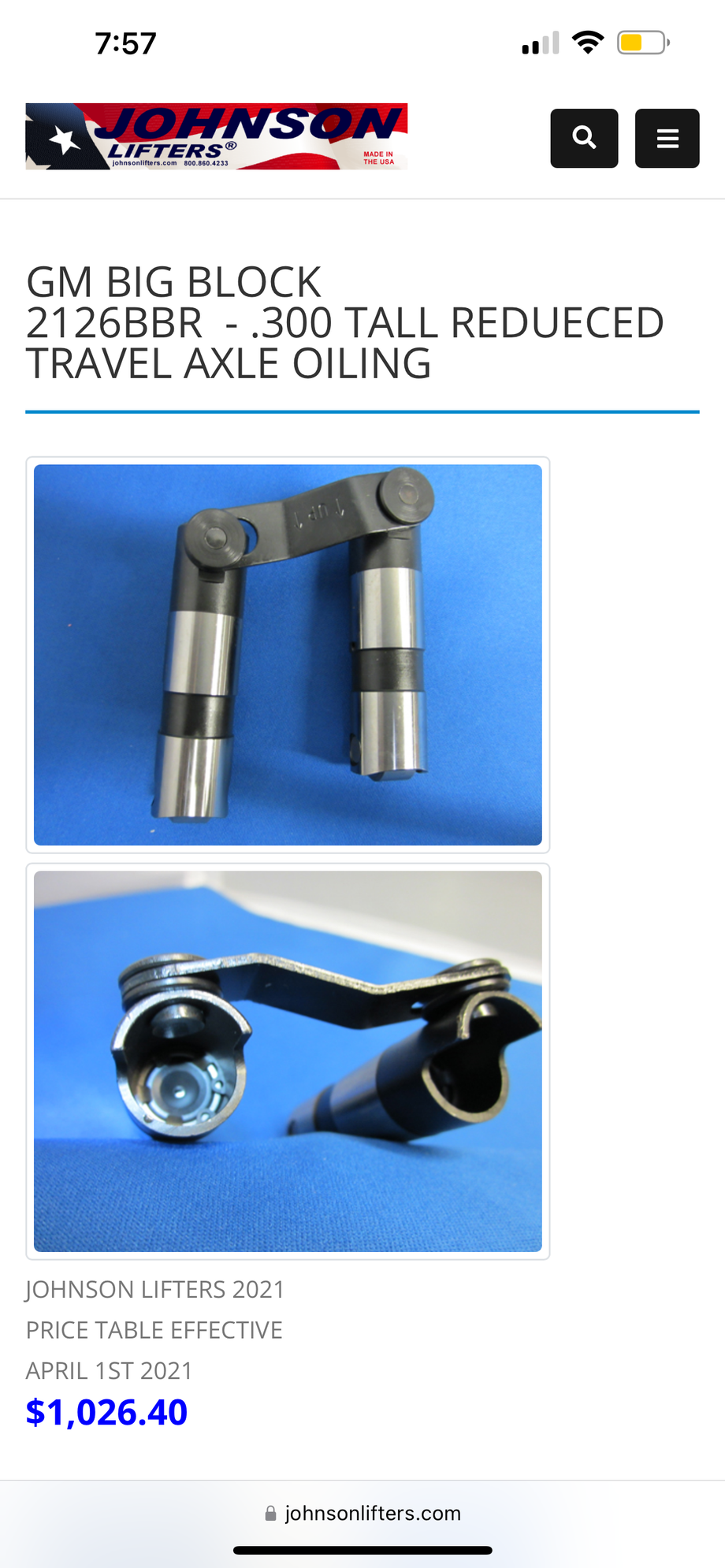

I missed the 50 hours of run time before the noise........Lux I think Johnson makes a replacement lifter for the 500............https://johnsonlifters.com/
this is what we have in our 500’s

Hello
The lifters are like the Johnson picture.
Thanks for this reference
