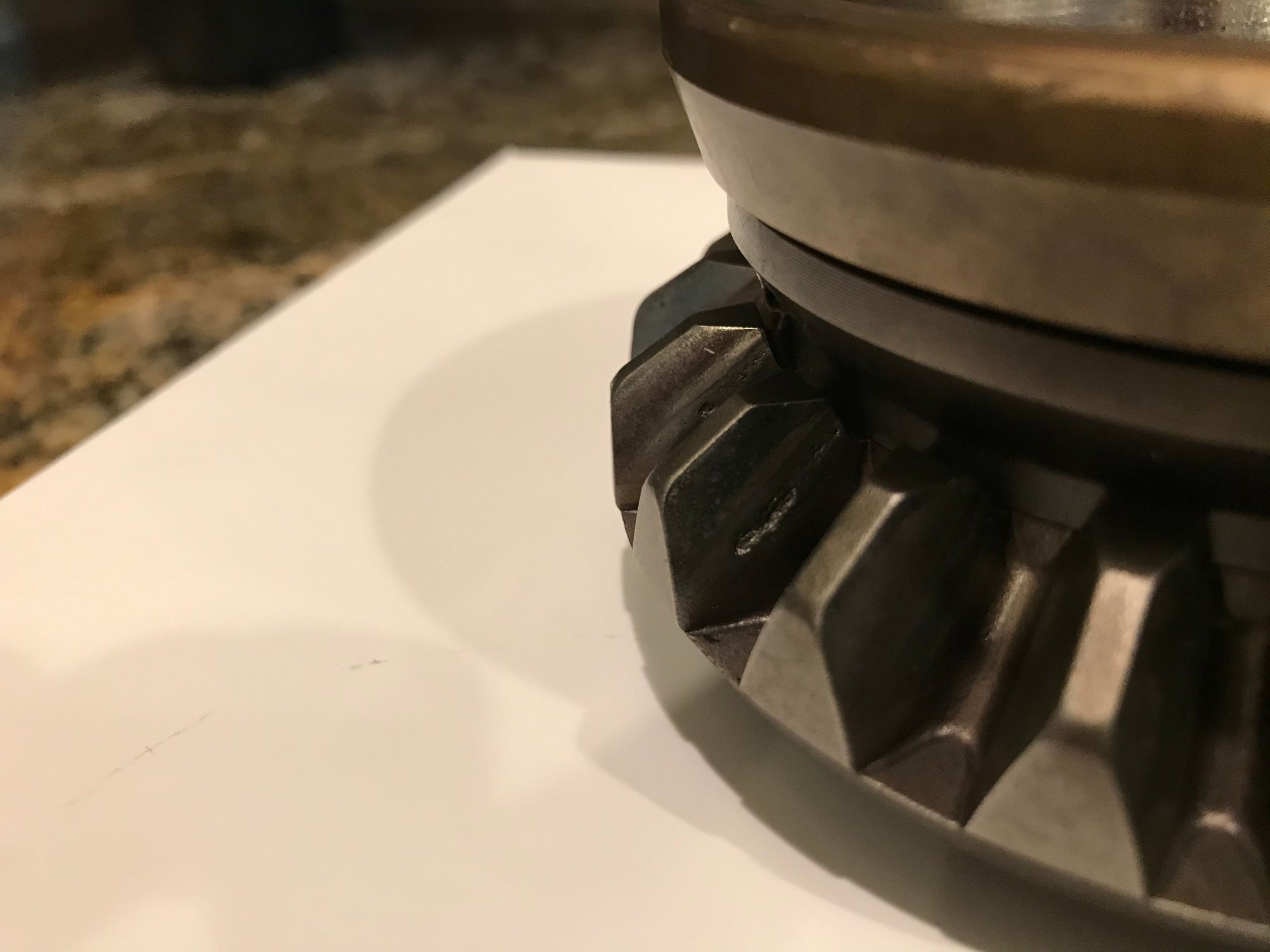

I have a couple of friends that have had to have AADS warranty multiple drives over the past couple years. Great that they warranty them but cant replace downtime and shipping back and forth.

Stock XRs should live behind twin stock 500 EFIs.
Agreed. These are upgraded drives too.
I saw less metal on stock 300 hour magnets than I do these at 40 hours.
To me it looks like something failed in the drive. Or has impending failure. Especially with the oil looking the way it does. Goerge thinks it’s from improper shift adjustment. I’m skeptical...but let’s see what they find. He’s been a stand up dude and knows his stuff. I’ll give him the benefit of the doubt until proven otherwise.
will report back.

Stock XR's should live behind 525's but the gears suck. George does know his stuff but are the others who work for him doing the assembly and setup on the same leve as George? Curious to see what happened.

50 hours on the oil? Was it changed after initial break in?
will report back.
They can fail behind 500EFI’s. we had a 2 hour ride back in 100* temps @ the GLOC poker run several years ago when my buddy’s boat had a gear tooth shear and pushed the pinion set out the front of the case.
With that much material on the magnet, it looks like a gear failure to me, I’ve seen this several times.
10-12 hours on break in oil (merc hi performance green)
replaced with neo oil
30 ish hours on this neo oil. AADS recommends this oil can go all year without a change. Claims 40-60 hours.
the other drive oil looks brand new.
1MOSES1 is offline
a #6 SSM can fail behind a 200hp motor. All mechanical things can and will fail.
given these are completely refreshed xr’s, with low hours...I wouldn’t expect a failure so quickly.
agreed with that much metal...I anticipate something failed.

I bet you find something like this on a tooth or couple, I’ve had failures like this at your timeframe, some last 75ish hours, some last 200 hours, with no rhyme or reason for it, I just chalk it up to poor quality from mother mercury
had the same happen to me 2 weeks ago, 60ish hours on the gears with no signs of wear.
Port drive? Seems fluid always gets dark on the left hand prop side first
