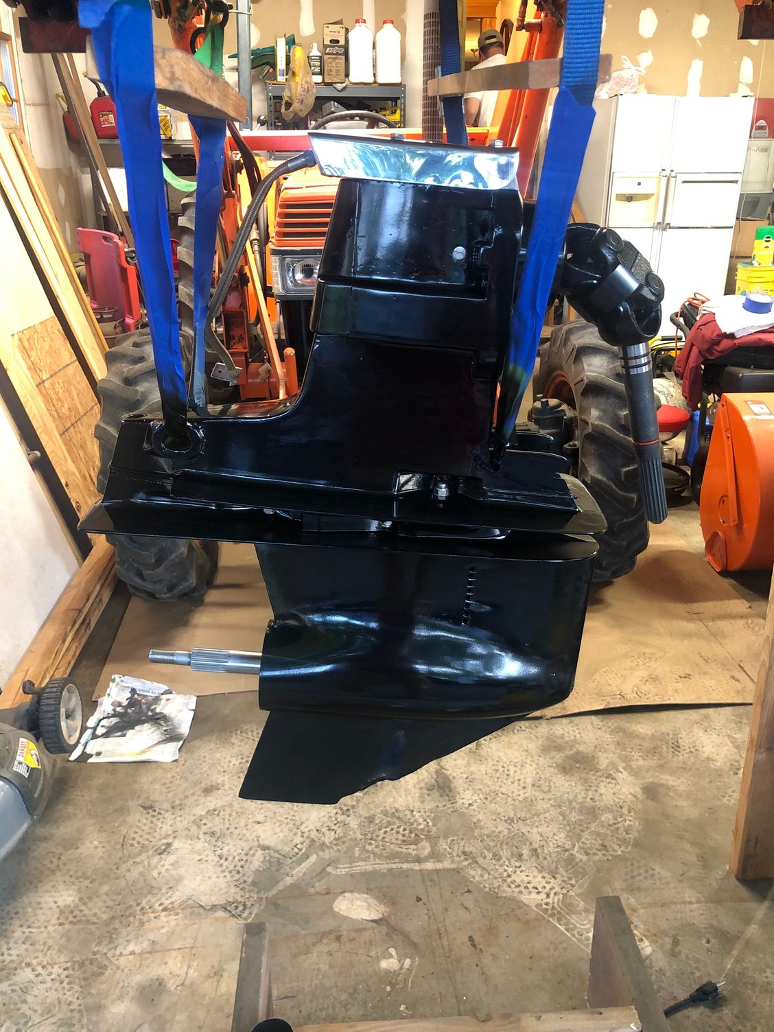

did a paint job before we put it on...

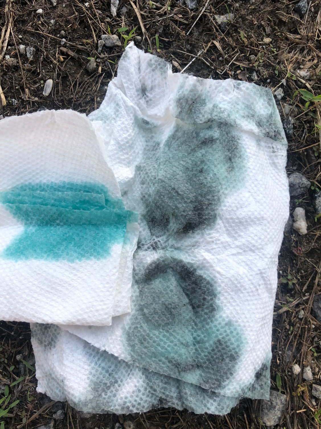

Here is brand new oil vs used oil after 2 hours of run time…oil looks burnt to me.

Here’s another pic of just the used oil…

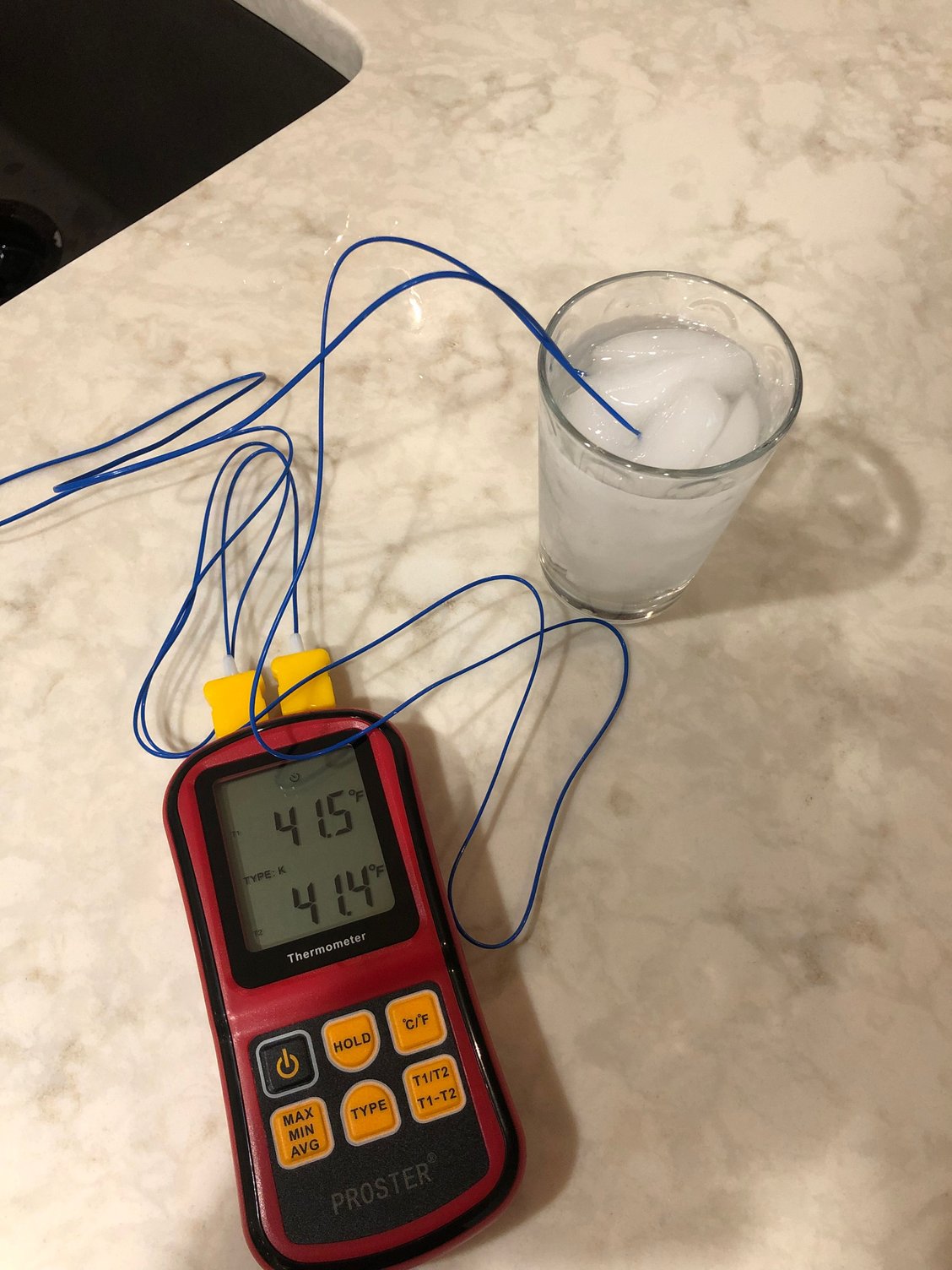

Decided to rig some TC’s to monitor temps in both drives…
