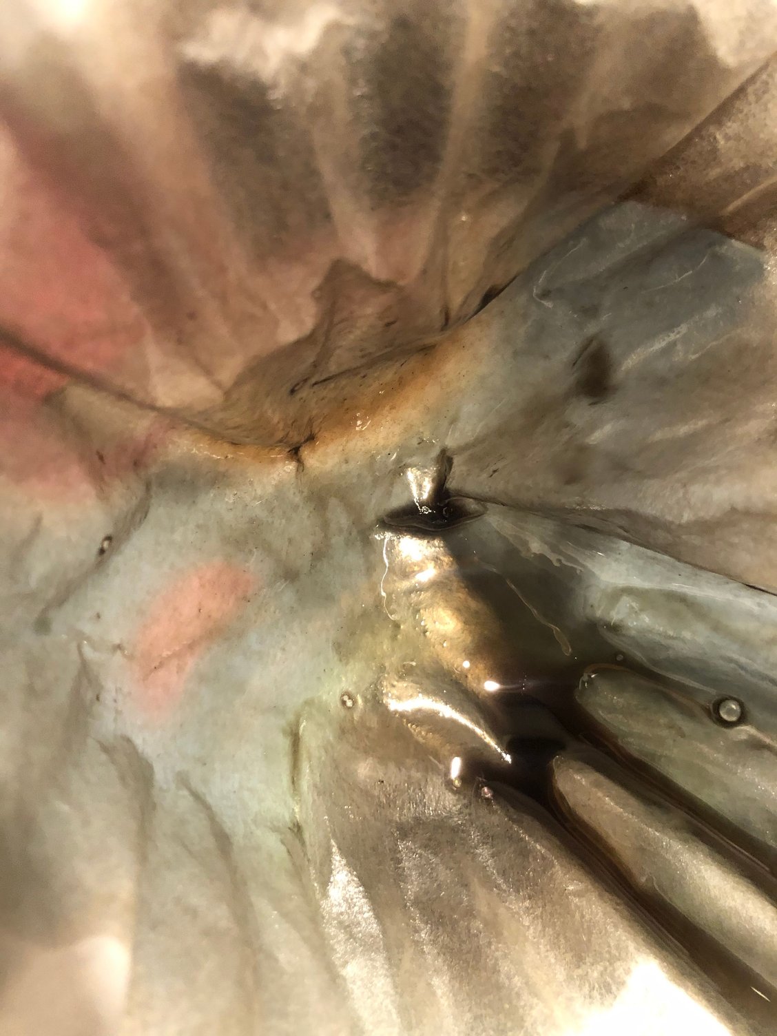

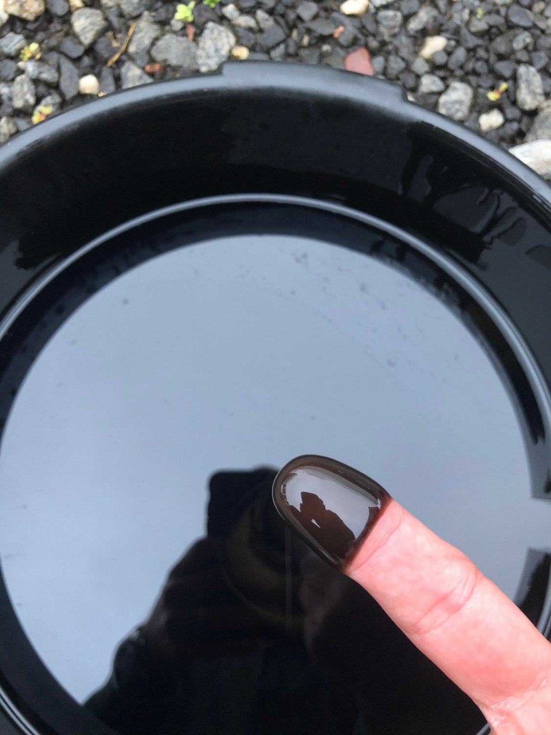

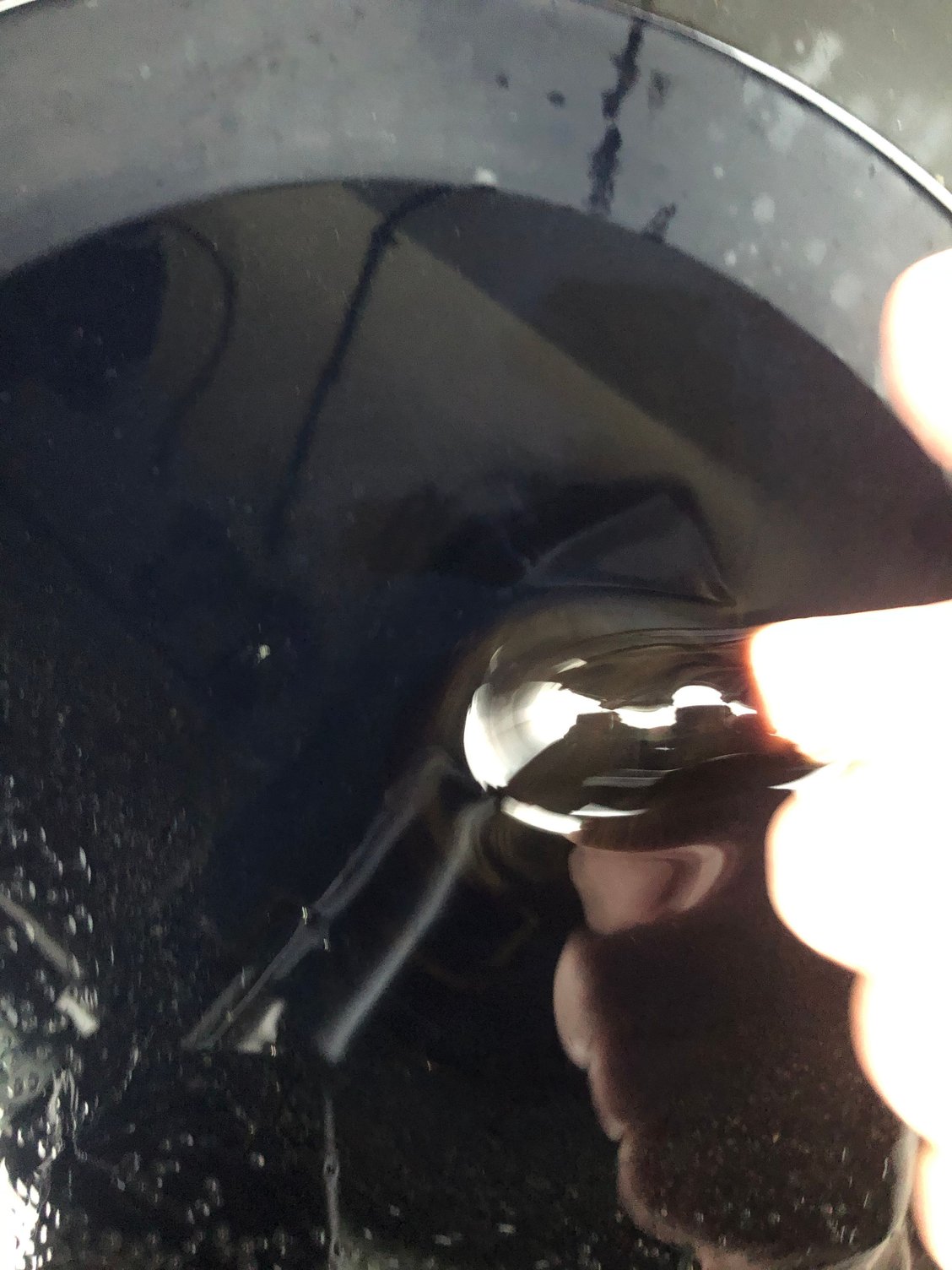

just took a sample of oil might send it out for analysis. It started off blue now it’s black. This oil only has 6-8 hours of run time.
1MOSES1 is offline

quick update...
drive went back to AADS. They tore it down again, and still can’t find an issue. They will be replacing gears and other parts.
I did filter the oil, didn’t see anything out of the ordinary.
wondering if I should send oil out for analysis.
