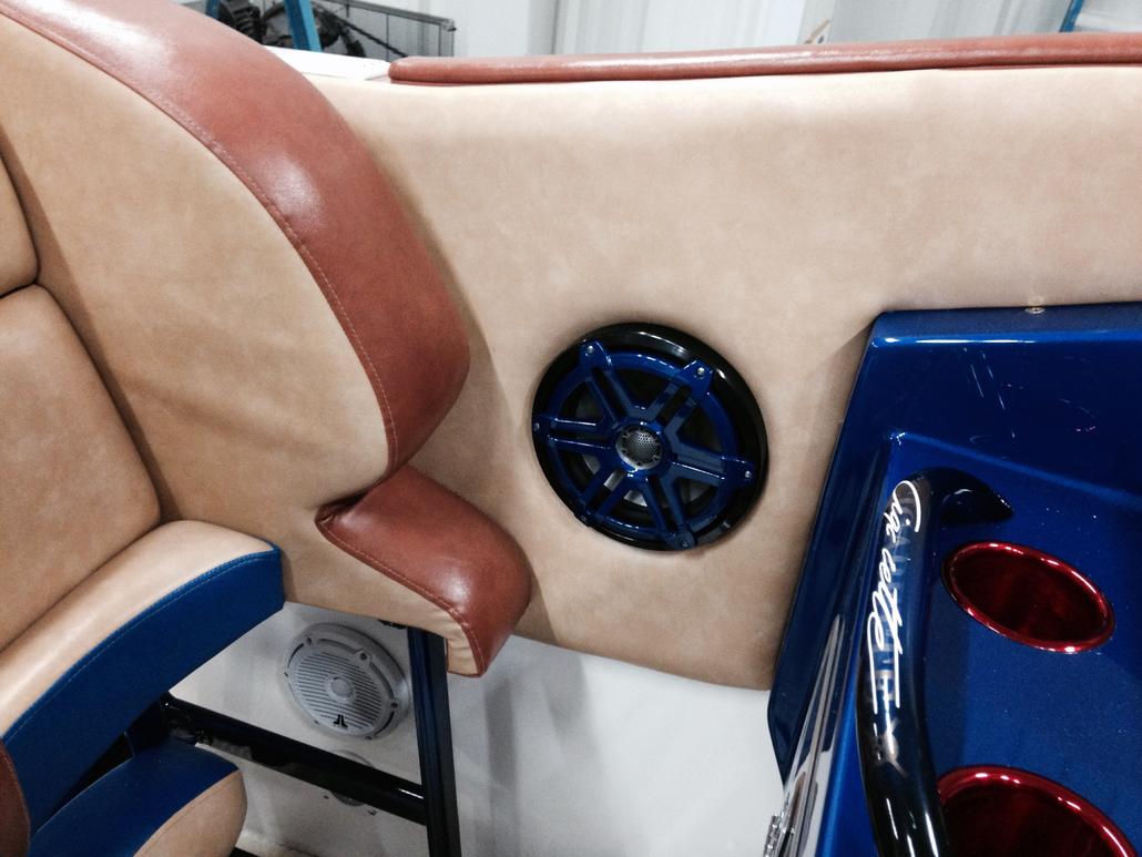

I just finished doing mine, since you haven't cut anything yet I would really try to bring up the 8.8's as far as possible. Just leave the existing speakers where they are down low. I installed 3 sets of 8.8's and I have more than enough bass without a sub. Good luck
[ATTACH=CONFIG]538639[/ATTACH]
Attached Thumbnails What is the best tool to cut speaker openings?-image.jpg
