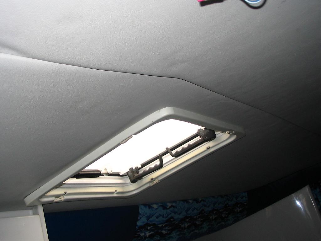

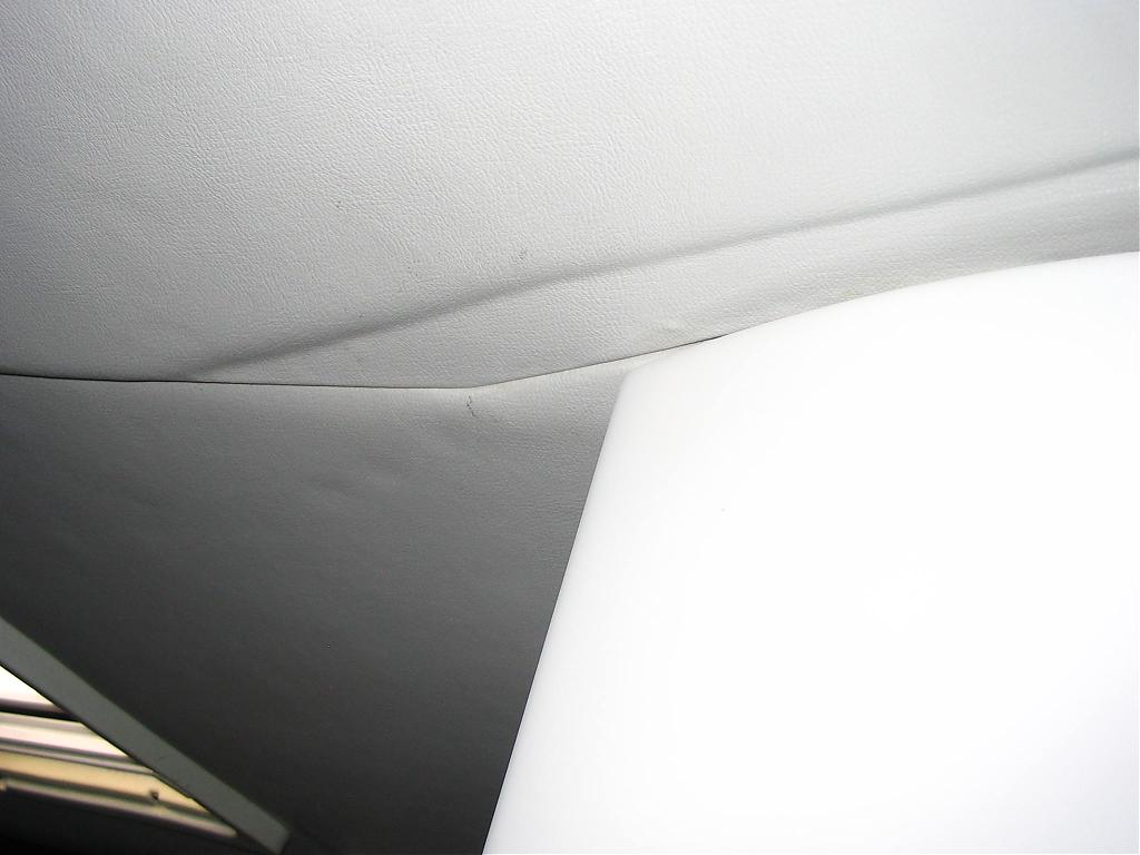

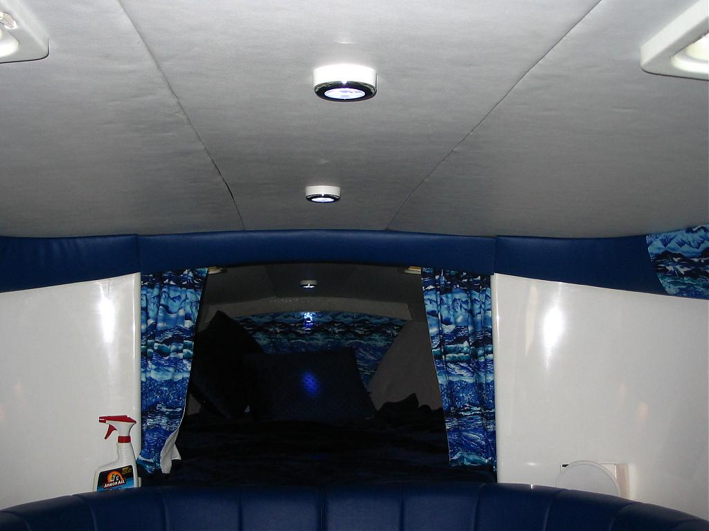

We removed ours and had a local shop reinstall new vinyl at a cost of a big $581.30 and i installed it back into the boat ,getting the headliner out is a pain in the
Attached Thumbnails Headliner problem/question-kims-pix-076.jpg   Headliner problem/question-kims-pix-072.jpg   Headliner problem/question-kims-pix-073.jpg
