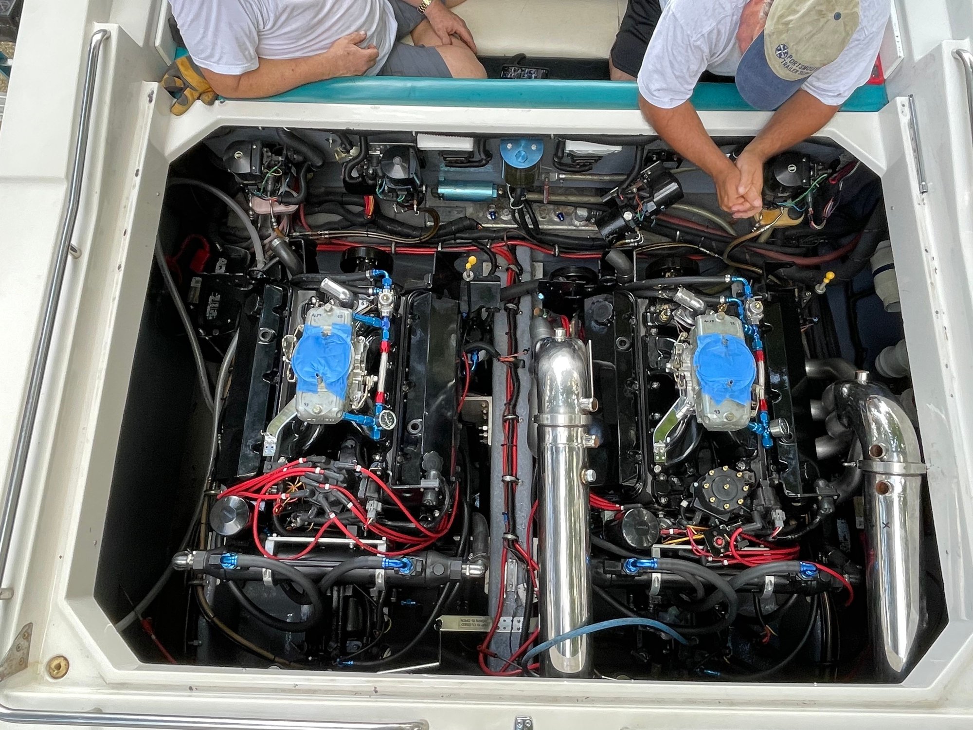

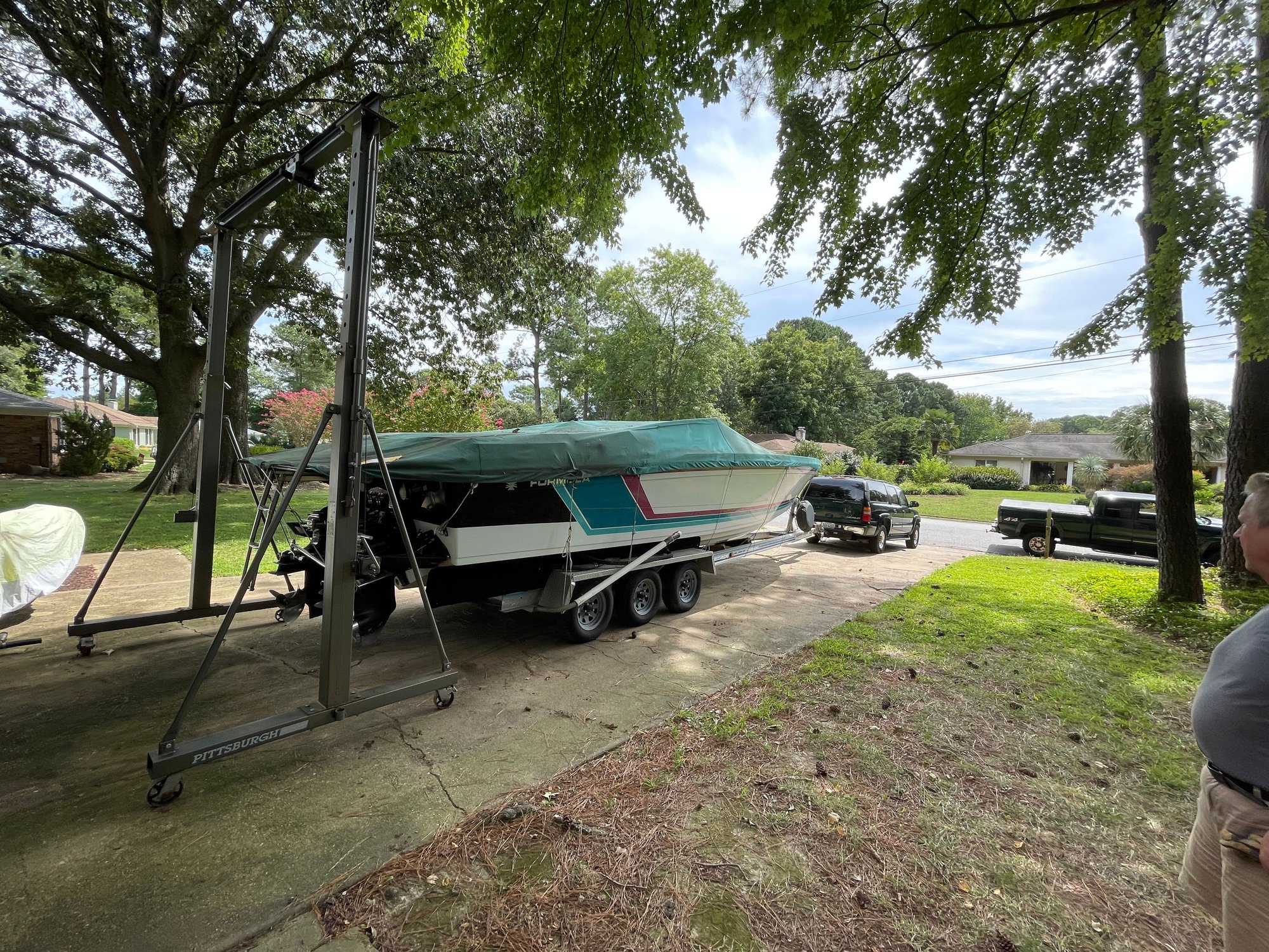

Well that was a pain! The first one anyway.
I was hoping to be able to get one in mostly dressed but that wasn’t going to work. In the end everything on the front had to come off. Nothing like having to do a bunch of work twice.
It had been a while since I’d had everything apart so it took some time to trust the stack of the washers at the transom/transmission. Fortunately, Rookie confirmed that I had it right. It took a lot of trying to get everything lined up but once we figured it out, it went easy. The second engine took all of a half hour to get in bolted up.
I’ll probably have her running by the end of the weekend. Can’t wait!
Some pics…
Prep the day before. Virginia Beach has an ordinance that prohibits having trailers in driveways. Had to get it all done before someone complained.
Nice and clean with fresh paint. When it’s wet, it’s a skating rink. Ask me how I know. Don’t mind those blue butt connectors. I have a new weather pack connection ready to replace that.
Getting there!

Closer. The new hard-wall hoses are making it a total ***** to get the raw water pumps back in. I also have some slight exhaust alignment issues with the AFR heads but should be okay.
Nice to have some power and music playing while working.
Once I’m sure that all my fuel fittings are leak-free, I’ll put the port engine’s exhaust on.
