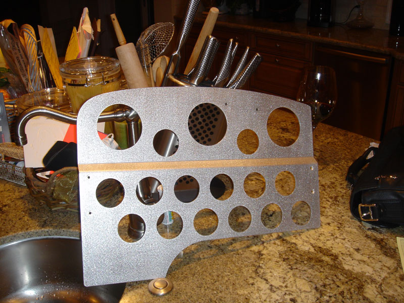

Update.....just test fit the panel today before plating and painting. Making a few extra blanks with NO gauge holes. Who knows......somebody might want to get one from me!!!
Front and Back sides

Getting very very close now!!!
