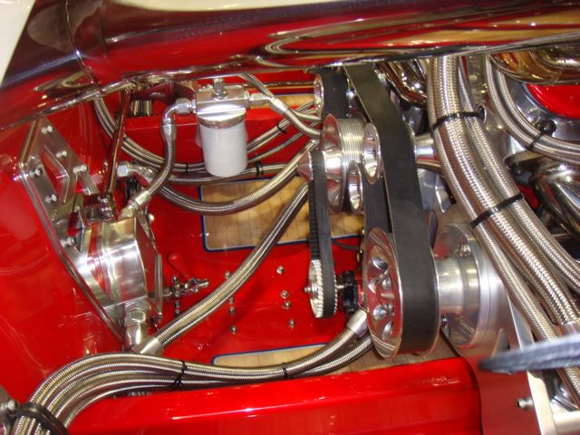

To my comment above about not seeing end grain balsa ealier, it looks like this.
This is on a 22ft 1300HP twin turbo v drive Schiada these guys have been in business what 50 years?
