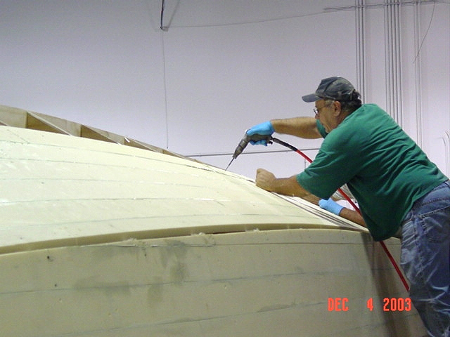

Working on the bottom.
Attached Thumbnails Thad Allen's Apache + The Birth of the Cheetah Cat-bottom.jpg

Working out the vent.
Attached Thumbnails Thad Allen's Apache + The Birth of the Cheetah Cat-vent.jpg

Here we step back a bit, you can see the very simple plywood frames and the way the vent was created here.
Attached Thumbnails Thad Allen's Apache + The Birth of the Cheetah Cat-vent2.jpg
