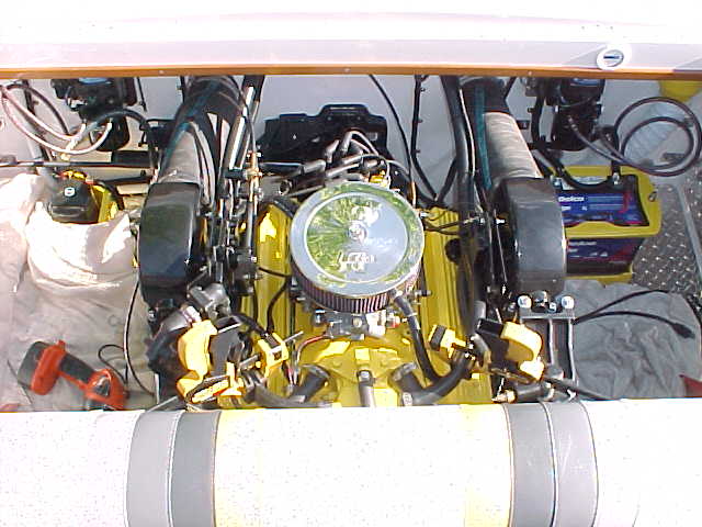

Trav. glad to here all is good. You had us worried there. keep us posted on the speeds. How about a photo of problem child.

Hotboat.... a few photos for ya..
