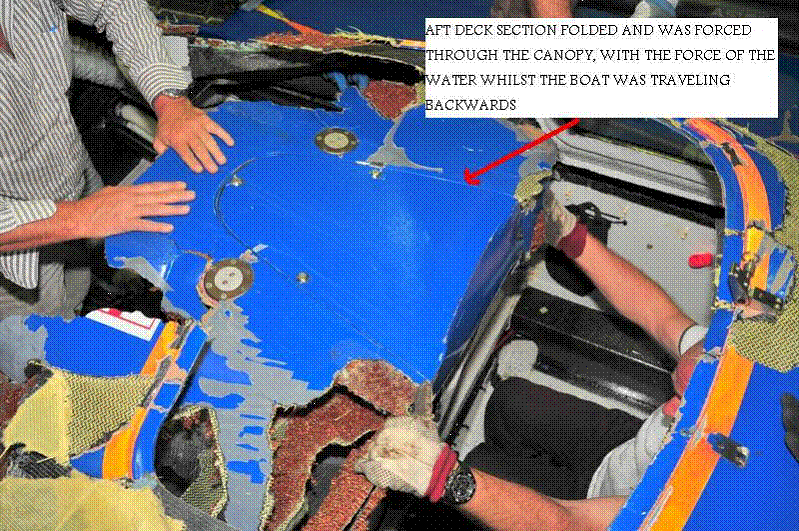

Below is a report regarding the failure of the canopy on the Victory team in 2009.
Basically, if a boat ends up upside-down (same as Big Thunder) the weak points are the hatch, which as shown in the report below collapsed INTO the cockpit, and the unsupported areas of the deck which also collapsed into the cockpit.
Structure & Component Failures and assumed timeline
1. The main impact forced the cockpit canopy top hatch past the hatch retaining flange within 0.04 seconds from initial impact, in which broke the hatch in half, shearing the fwd mounted hinges and bolts, allowing the water under pressure to enter. The hatch was found further most fwd from the debri that entered the canopy and went through the front bulkhead of the cockpit fig 1,2,and 3.
2. Simultaneously from the force of water and the impact, the aft bulkhead is blown into the void behind the cockpit; however it still remains mainly intact and connected at the base. At this point the bulkhead ring frame has failed and sections can be found in the cockpit fig 4.
3. 0.08 seconds after impact based on cockpit pictures the cockpit is fully immersed in water (pictures on file not shown) boat is still traveling backwards at speed in the water
4. Rear deck section aft of the canopy bulkhead collapses into the void behind the cockpit.
SpecialFX is offline
Old 11-24-2011 | 01:47 PM
  #108
Joined: Apr 2003
Posts: 137
From: Miami, Fl
Pics to accompany report
