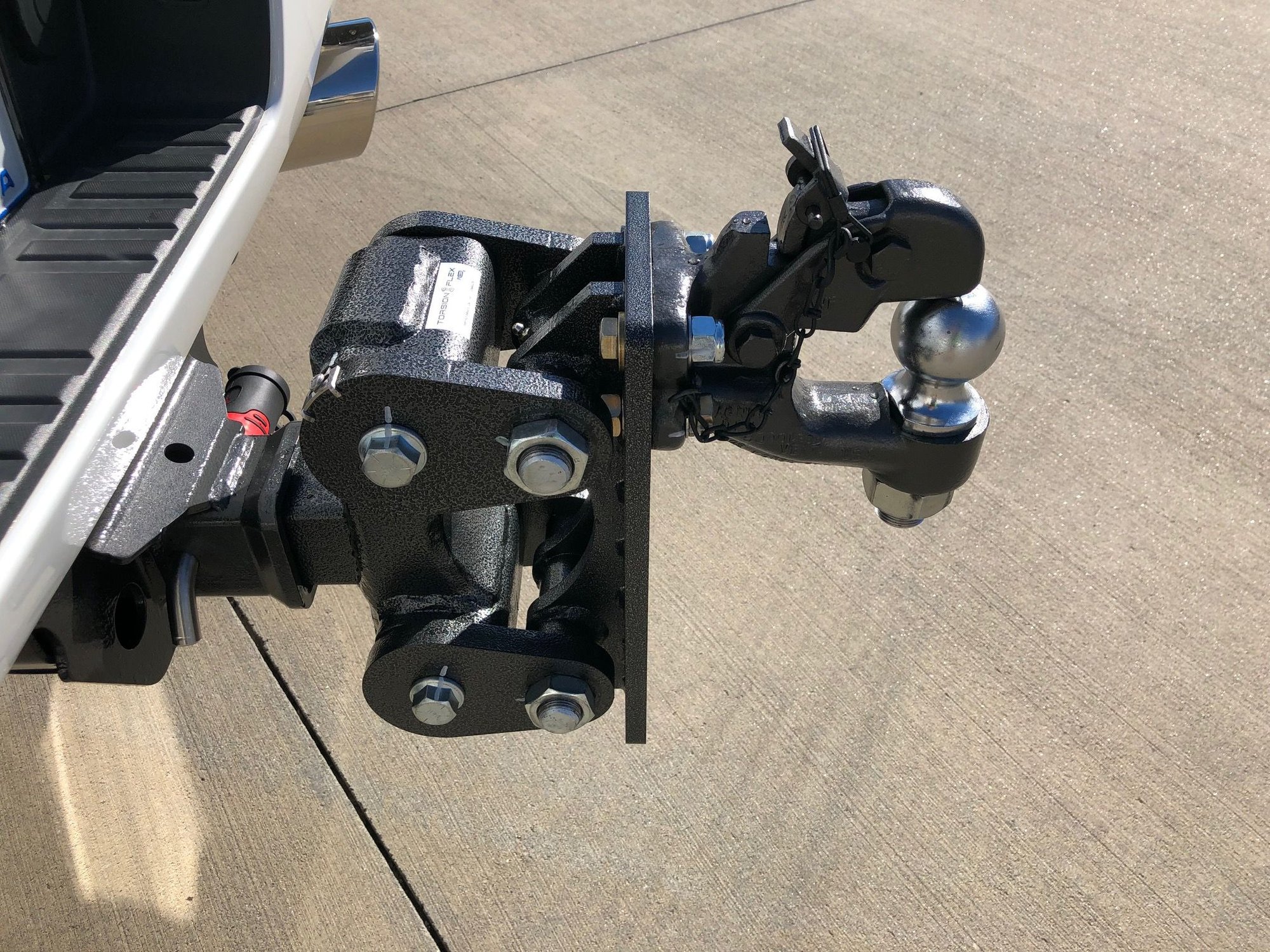

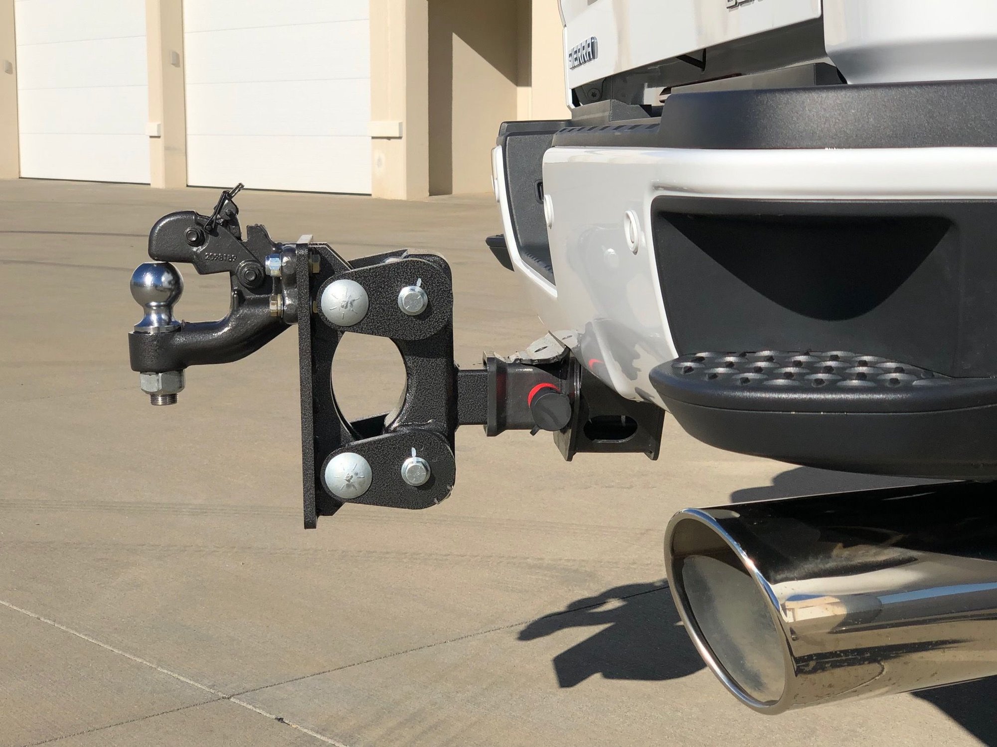

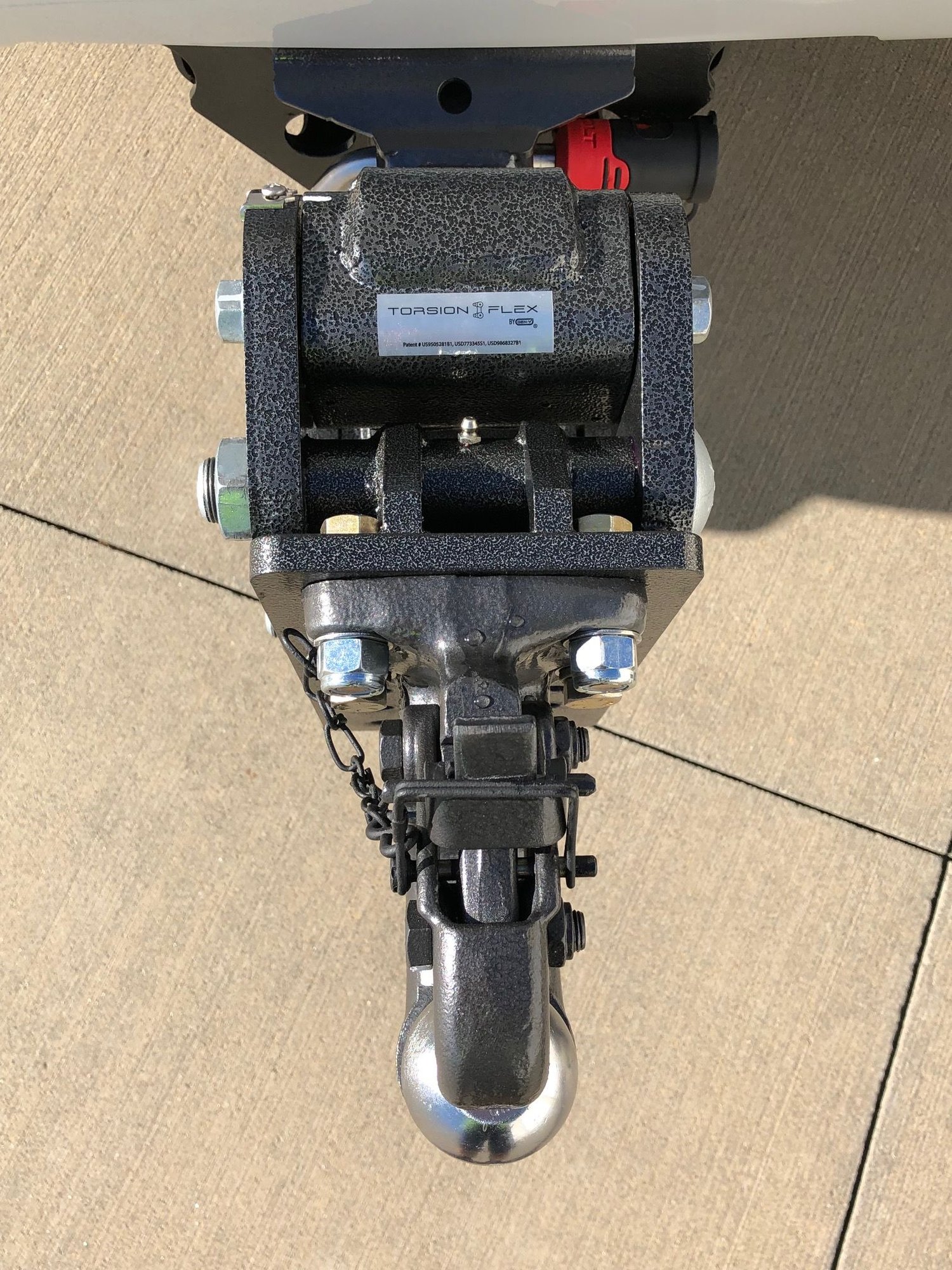

Default GenY Torsion Hitch
Decided to splurge for a better towing package knowing the Nor-Tech 390 is both longer and heavier than my previous 340.
Heard good things about the GenY Torsion Hitch from a fellow CC owner who owns and tows a Mystic. Says he has over 10k towing miles and loves it.

Nice looking piece. I’m assuming it works on the same principle as the torflex axles.
Any concerns that the total arm (distance from the receiver hitch to the ball) will cause excessive leverage on the hitch itself?
Yes that's what I've been told, same principal as the trailer torsion axles.
Your question / concern is valid.
Here's my theory; a NT-390 on a trailer w/ 1/2 tank of fuel weighs approx 16,000lbs.
GMC advertises their Class V hitch towing capacity @ 20,000lbs & suggests a 10-15% tongue weight.
I've never been able to achieve 10% tongue weight w/ any boat I've owned including my 34' Nor-Tech.
Lets assume I can, that would be approx 1600lbs on the ball on a floating torsion hitch so I'm not only under the receivers suggested max tongue rating of 2000lbs but I also have a hitch that is absorbing the load and dampening the leverage you have raised concern about.
The GenY hitch has quite a long 2.5" x 2.5" solid shank w/ 2 hitch pin options, I believe it's in as far as it will go in the pics but I'm not 100% sure which hole, I just installed it and pinned it for the pics.
DISCLAIMER: I'm not a Mechanical Engineer, so this is just my hypothesis
