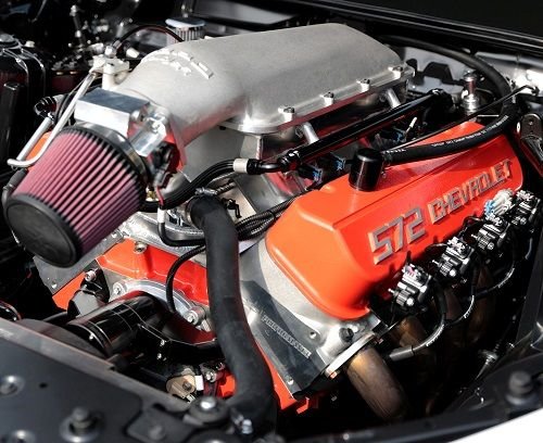

If you wait a little bit, Holley will be releasing the BBC Hi-Ram this quarter.

That looks bad!

Is there any dyno tests on that yet?
Not that I have seen, but the lower design has been proven as an improvement on all other platforms.
https://www.dragzine.com/features/pr...gh-ram-intake/
