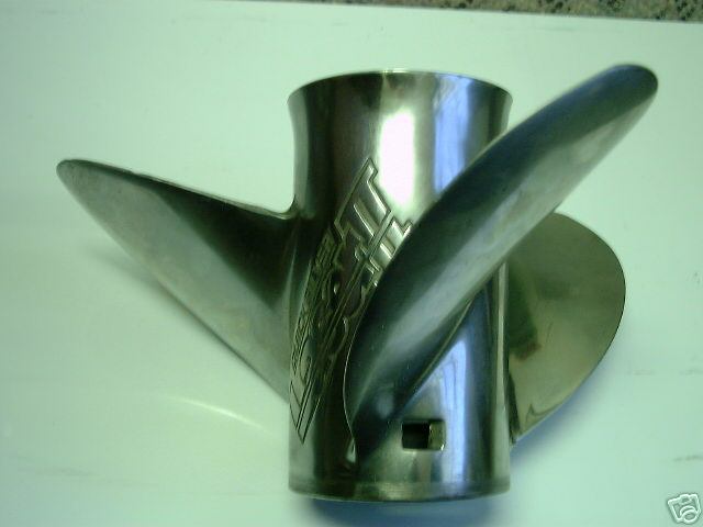

Does the prop have a machined step at the gear case side?
It should look like this........

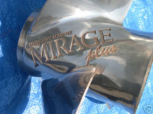

Not like this........see, no step....
