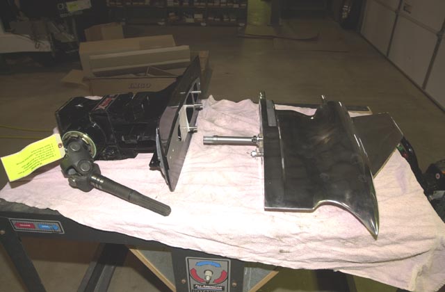

The fluid drain is right behind the prop at the bottom. Check to make sure it is not loose and that the seal is ok. If the problem is in the lower unit it can be removed from the upper by unbolting the 7 nuts that hold it on. The 7th bolt is at the rear under the plastic plug. This way you can service the lower without removing the whole drive. The leak ma posibly be in the upper and leaking down into the exhaust area by the prop but not likely. Here is a picture of a drive yours should be similar.
