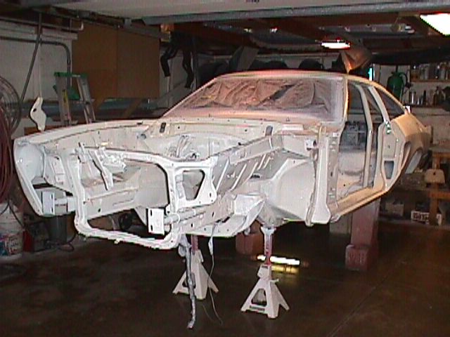

I've shot both of these below.
IMO if you are going to use an epoxy primer I would use Sikkens. Though, I would top coat in the recommended time since this stuff is tough as nails. Seriously. Due to frame mods I had to let the primer completely setup. Prepping the surface (scuffing) was VERY difficult. Not cheap stuff either. Stone chips hasn't even come close to penetrating the primer on this Cobra since 2001.
I like Imron for single stage but still prone to fuel lifting paint issues. Especially in the first year without baking. I have some lifting around the vent on this boat painted in 2006. Still very shiny though.
Options options

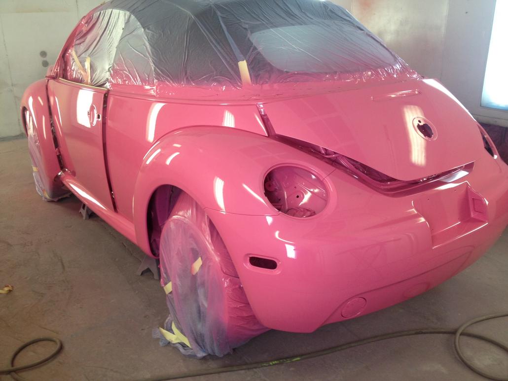

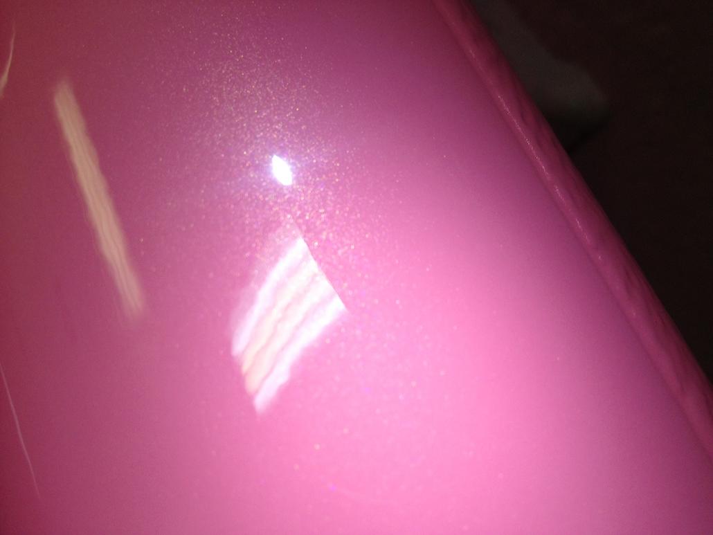

Originally Posted by mptrimshop
A good painter or paint shop can get you almost any color you need from any brand. A Good painter can spray any brand and make it look great with a little time behind the brand you choose but most have one they use most often and prefer.
I tend to agree. The guy who painted my entire dually flat black, came up with this color on his third mix; and it was vibrantly superior than anything the HOK book we searched through first. Target was to match her custom pink guitar.
[ATTACH=CONFIG]515397[/ATTACH]
We started here:
[ATTACH=CONFIG]515398[/ATTACH]
Passed here:
[ATTACH=CONFIG]515399[/ATTACH]
And ended here: (the pearl doesn't show in the crappy phone pic)
[ATTACH=CONFIG]515400[/ATTACH]
The VW was my GF's reward for beating breast cancer.
Options options
The lifting is not from the Imron. Lifting comes from the fuel getting under the paint. Like if you taped the fuel breather off. The paint edge could be exposed and get peneterated. Or it was not sanded. ( kinda hard to sand it good if the piece was taped around and not removed.) All Kenworth Semi Tractors have Imron on them. So I don't think a little fuel would eat the paint off. Also . In the sun or at engine temp it takes less than a month to fully cure.. Baking only speeds up the process. Sorry to say it like it is. I painted for the Military ( Parts for F16's, B1's, Submarines etc, even the guidence part of the bombs dropped on Momar Kadoffie's ( sp?) house !! ) and some paints like vinyl paints have to be baked, but not true with catalized paints.- Have a good day.Chad
