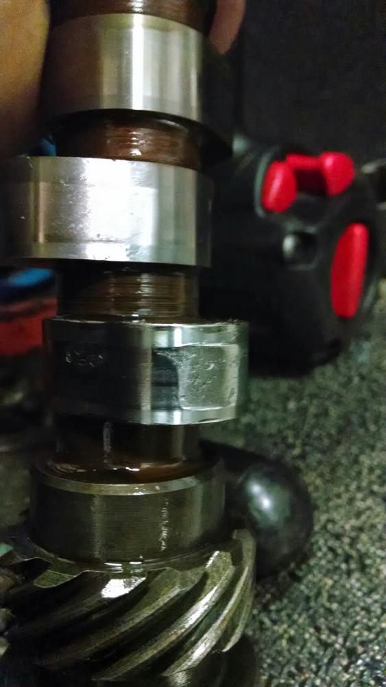

Yes and no on finding it in my opinion.
The valvetrane on a solid lifter engine is already loud so by the time you can hear a definitive tap or something different then the normal growl, the lifter more then likely already damaged the cam. You might get lucky if you catch it super fast but more then likely the cam will look sort of similar as Tim's did.
Here's mine back in 2014 before I switched over to Hydralic. I knew I was rebuilding my engines that winter and didn't plan on using the big boat much that summer because I also had two boats (22' Apache). Low and behold, the day before Memorial Day I took a test ride and heard a lifter tap. Checked lash and it was out 10 thou on the bad lifter. Pulled the intake and cam was f#cked and several other lobes were also worn but the lifter had not yet failed the lifter wheel bearing yet.
Like anything else, you have to stay on top of things and know your service interval to catch the problems before they happen. I tried to stretch to save $1300 on new lifters ahead of my rebuilds and it wound up costing me $3500 on a cam and lifters for both engines just to get me through the season.[ATTACH=CONFIG]562290[/ATTACH][ATTACH=CONFIG]562291[/ATTACH][ATTACH=CONFIG]562290[/ATTACH][ATTACH=CONFIG]562291[/ATTACH]
