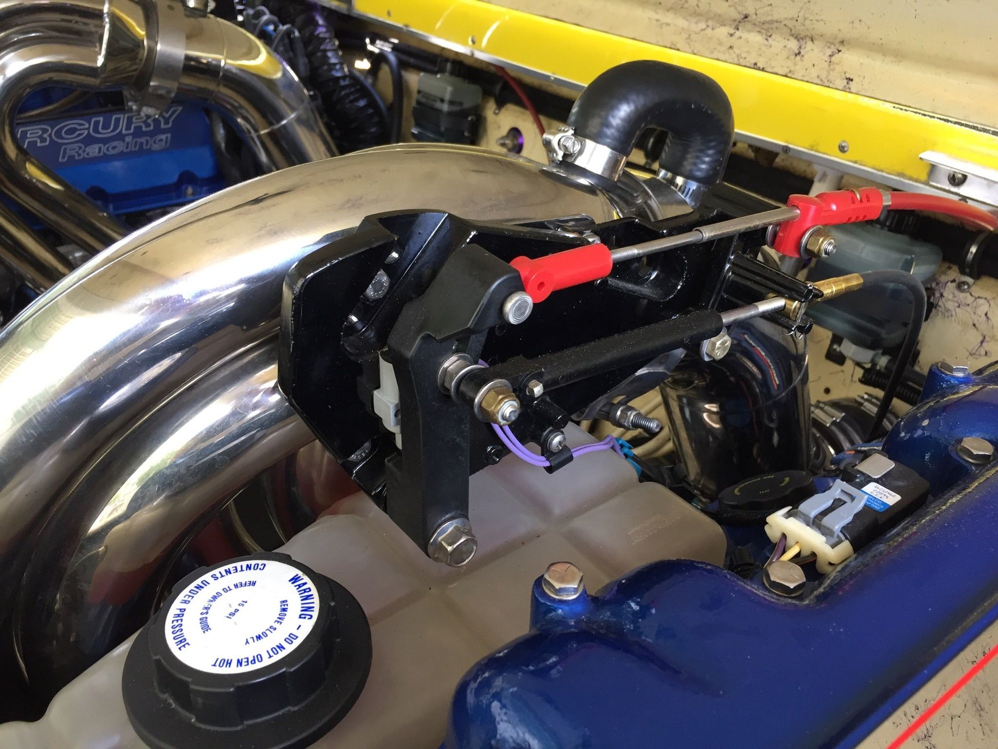

The switch was the one on the headers, where the Cable from the shifter connects to the cable going to the drive. Not sure what it is called, I assumed it was the neutral safety switch. It was reading that the boat was in neutral when it was actually in gear. Unplugged it, now reads in gear, no issues. Will replace it next week.

[img]blob:https://www.offshoreonly.com/b04ead98-395a-443c-958a-f64f26a74f06[/img]
papps is offline
Old 06-23-2018 | 10:34 PM
Joined: Jun 2005
Posts: 79
From: Johns Creek, GA
Gray switch with the purple wires

Sorry guys not trying to sound bad here but as I try to be spot on with all my posts and not trying to correct anyone - But have to add -- , The switch on the shift plate is THE SHIFT IN GEAR SWITCH. -- it is not the Neutral safety switch.
see the PCM is called that for reason. So who wants to guess why its called PCM instead of ECM here ?? Anyone ?
Anyways --- just added info -- The shift in gear switch IS NEEDED very much so as it reports to the PCM in gear or in Neutral . There is reasons why it is needed and I do not want to write a story book about it. . When it is bad the shift in gear switch and or unplug and or the connection bad --- in due time it will set GUARDIAN mode and even sometimes shut down.the engine when running on the water...
Had a feeling thats what everyone was talking about the shift in gear switch hence WHY I ASKED in my post way above..
