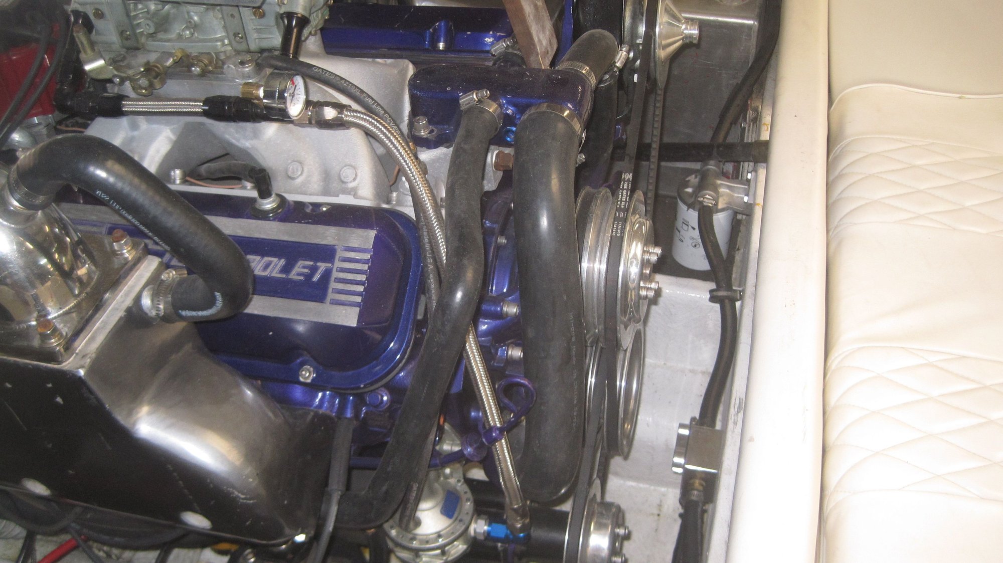

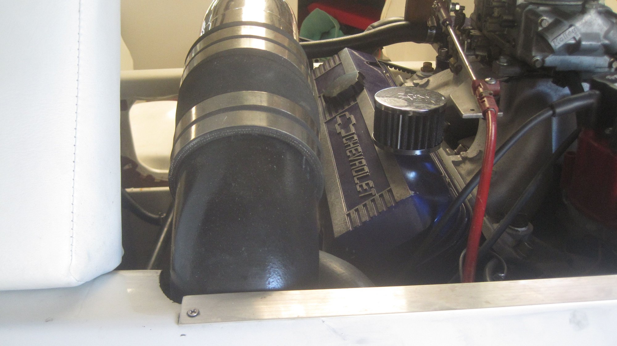

I added a presure value to the intale line after my cooler.the hose was allready cut there.......got it set to the lowest possible rate.check all lines,exhoust risers are clean.move my presure line to the intake.i still peg the gauge.if my s pipes are to close to the exhoust will this raise water presure.i might cut the y pipes off to get them away from the riser pipe......can i get block off plates for a bravo 1 that draws water at the sides.

Post a pic of your setup.............

It wont let me post photos.
