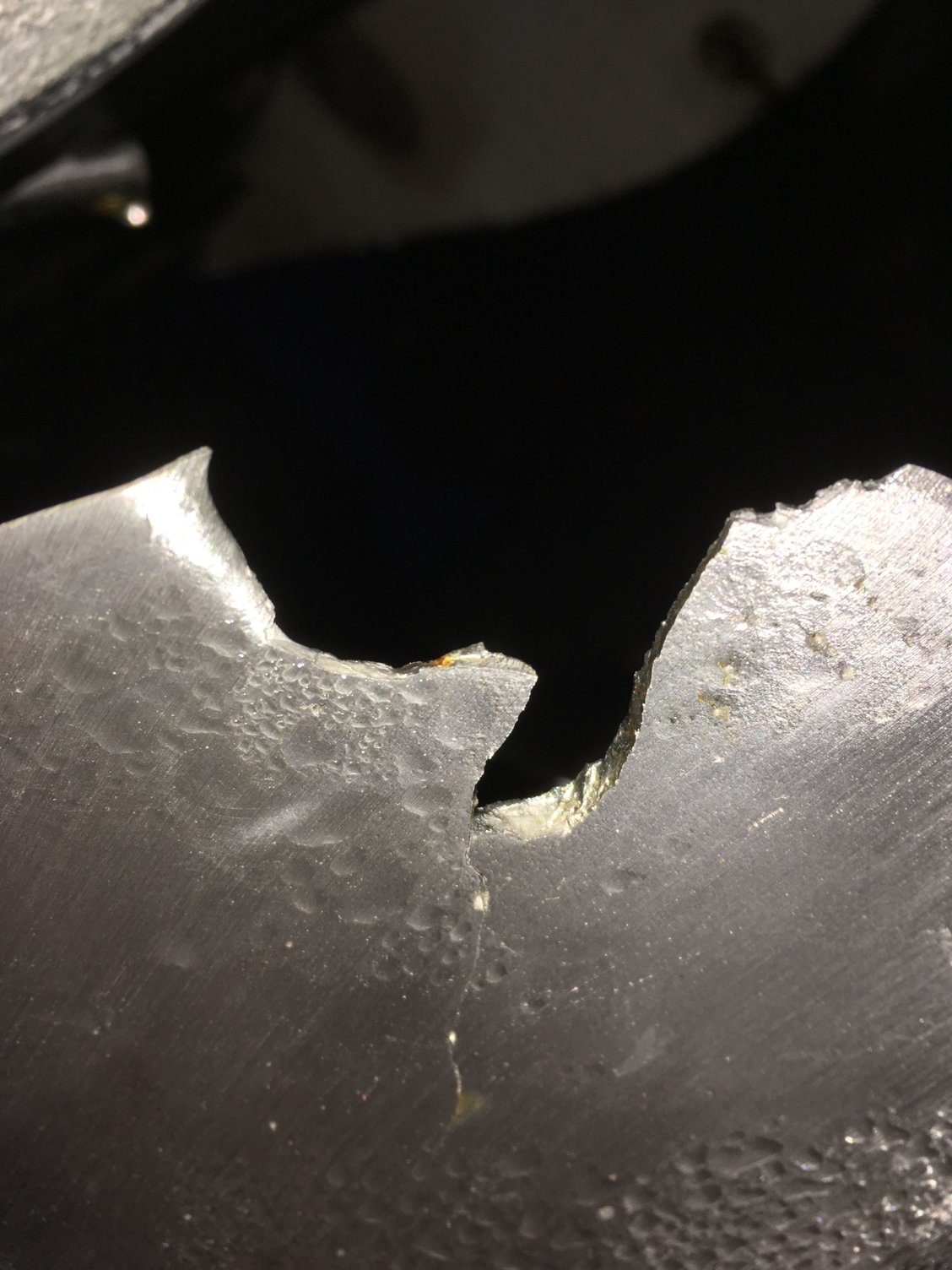

For me with B3 2.0 28 pitch with cup added. (before Bblades worked the props I was having cavitation burns so bad I was loosing chunks of prop)
3900rpm 45-47 mph
5200rpm 55 mph
As far as the current set up, the props were chosen based on experience from Rik and Jim Hering trying to make Excal’burs and 400SS run with the Arneson. I’ve used the same formulas you’ve used on this boat and others and they are pretty close when equipped with alphas and bravos.
I’m going to reserve judgment until I have current props scanned and reworked.
Ive seen amazing results from proper prop tuning, amazing as in “this is like a different boat” results
