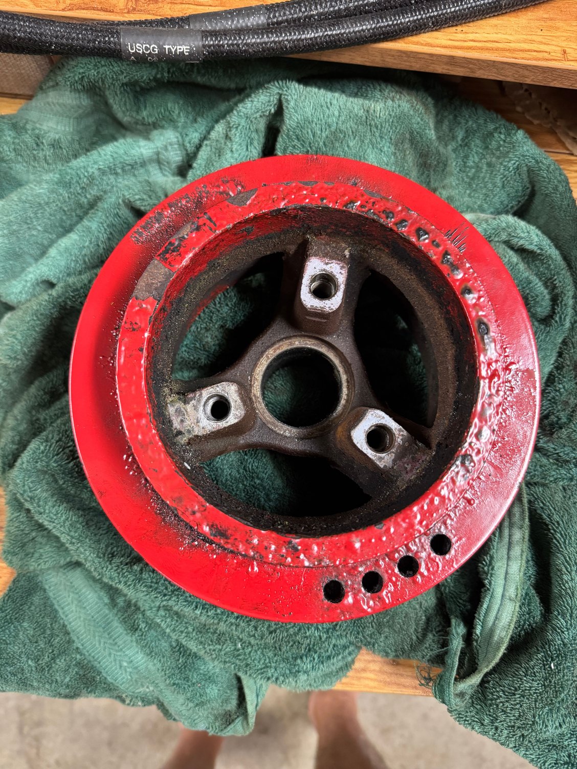

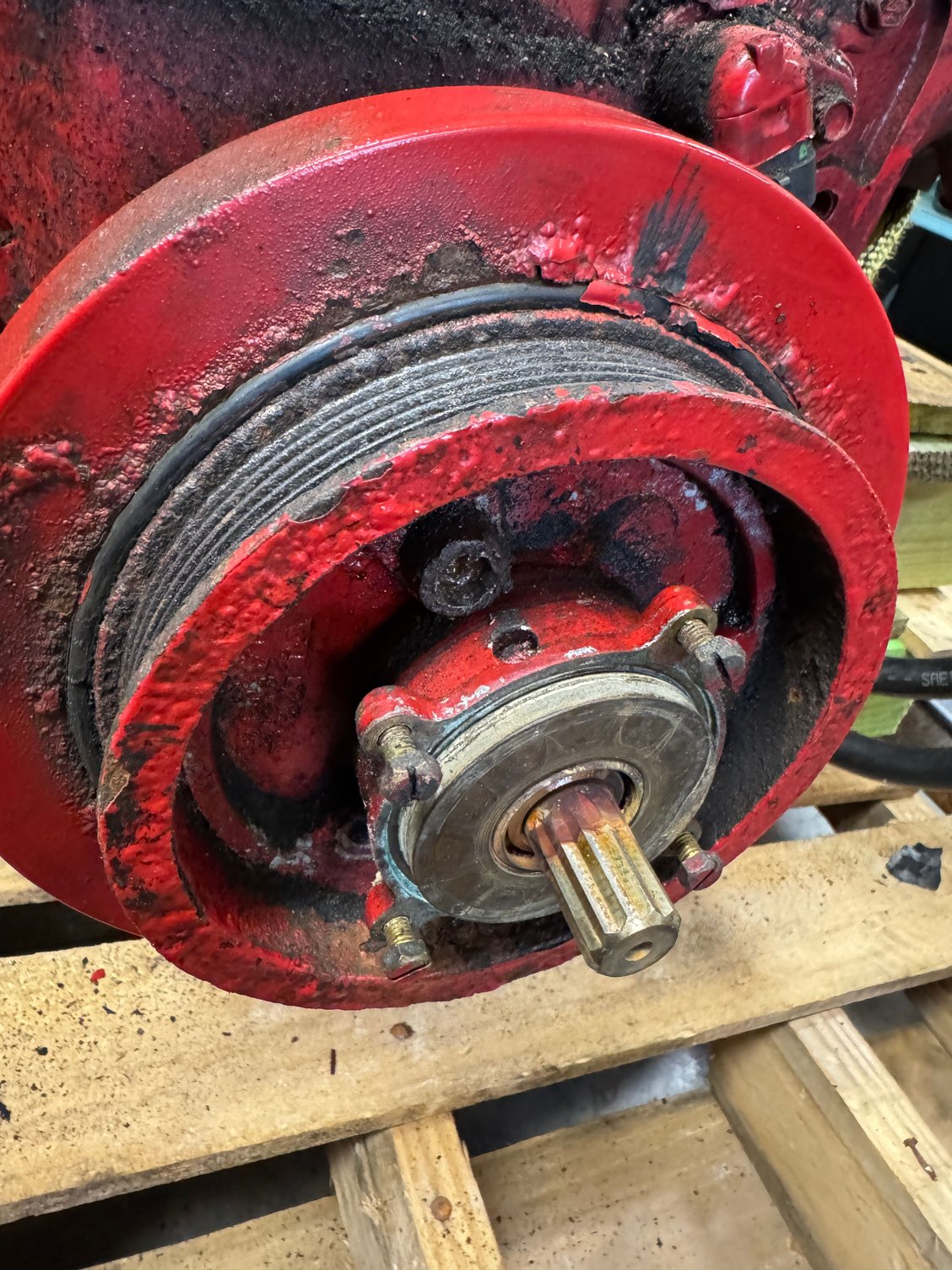

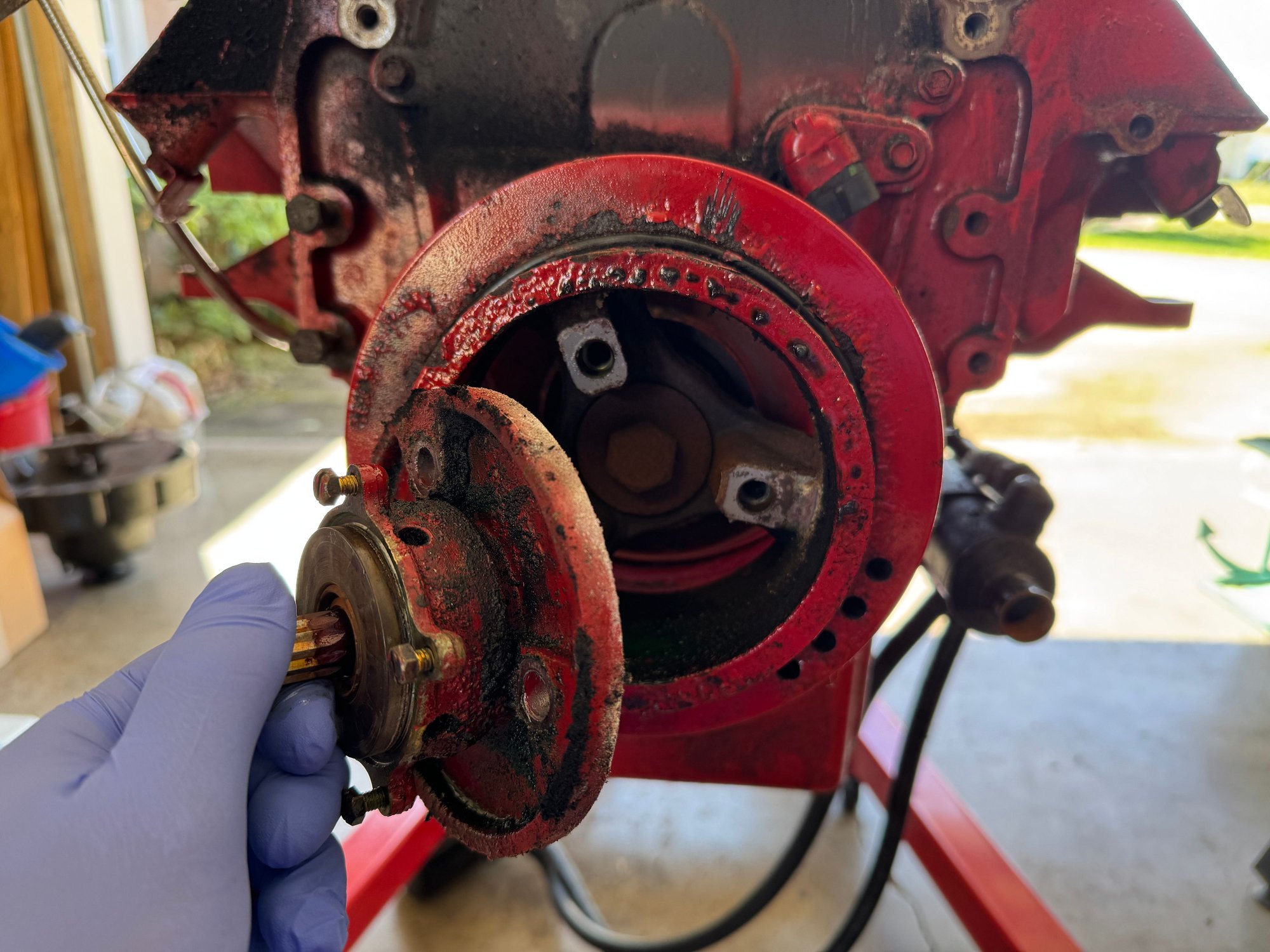

My VP damper/pulley (one piece) is rusted to hell. VP doesn't have an ETA when the part will be available again. I have an 8.1L with crank sea water pump for closed cooling via HE.
Questions:
1- Do the 8.1 dampers come with or with out the pulley?
2- Do the dampers already have threads or do they need to be threaded to hold the crank pump?
If I'm thinking of this correctly, I can pick up a new standard damper and pulley from AC Delco and add the the spacer and bushings.
This is what I have below. All one piece. The damper and pulley do not separate. This thing was eating belts. Thanks for the help.
Questions:

Ive struck out with all the local auto part stores:
NAPA
AutoZone
Advanced Auto
O'Rielys
None have a harmonic balancer that I can bolt on a sea water pump to the crank. None had the 3 holes to bolt on the sea water pump.
Now looking for used or racing type dampers. Anyone have any suggestions?

Find out what the balance the 8.1 uses fornthe balancer in oz. Find one the same balance for a BBC. Mount a flush ribbed pulley and the water pump.
If you can't find the correct balance...get tje closest one and have an engine machine shop add the correct balance to the balancer.
Lots of room for solutions with the $5xx + cost of a new one from Volvo.
Or...get one from an 8.1 auto engine...and have a machine shop drill.and tap the holes. Easy day.

The 8.1l Gen VI cranks use the same snout diamter as ll other BBCs.
1.5995-1.6005" tolerance
Balancers are 1.598-1.599"
some aftermarket auto 8.1l balancers spec out the bore at 40.6mm. (1.598")
Nothing special about the 8.1l balancer except likely the external balance offset for the larger crank swing 4.370", and they incorporated the pulley into the casting.
BBC balancers are sold based on their offset balance in ounces.
Lots of pulley manufacturers to sort out your needs. Bolt on your water pump.

Volvo Penta doesn’t publish any info on the balance weight. Any suggestions?
