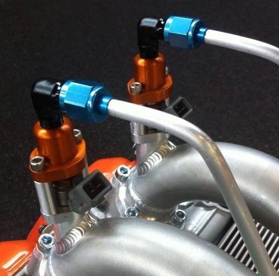

I thought these were cool vs the standard fuel rail.

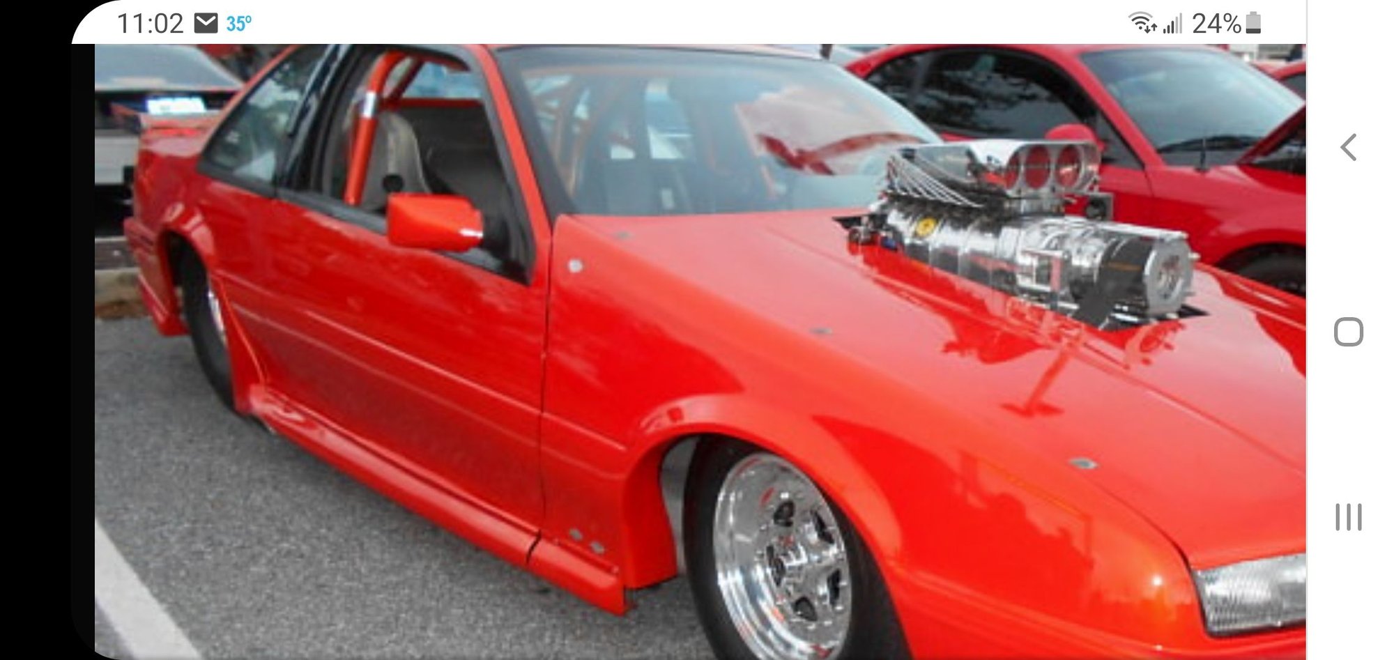

  #98
Joined: Oct 2012
Posts: 2,239
Likes: 541
This was my friends street car. If you look closely, you can see 8 injectors on each side.
underpsi68 is offline
Old 12-21-2021 | 10:04 AM
  #99
Joined: Jun 2009
Posts: 9,989
Likes: 6,484
From: Chicago
Aren`t those mechanical injection nozzles?
